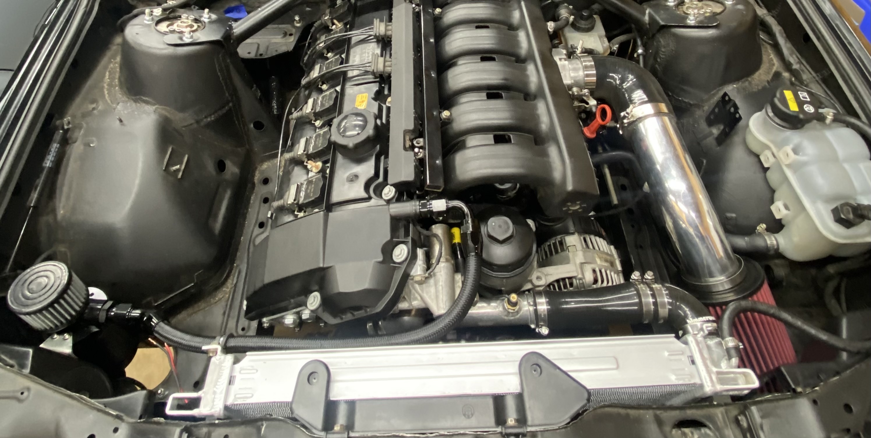

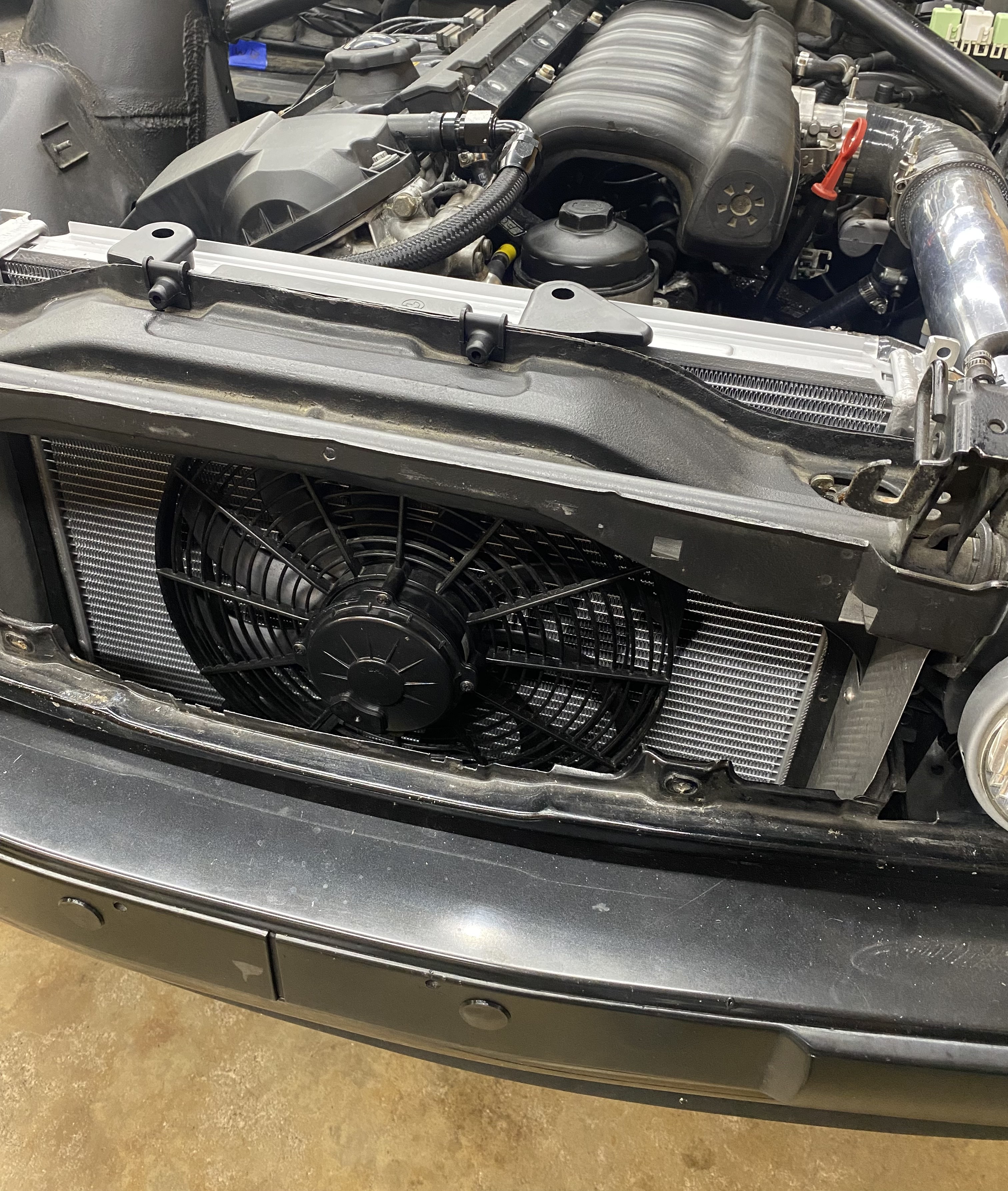

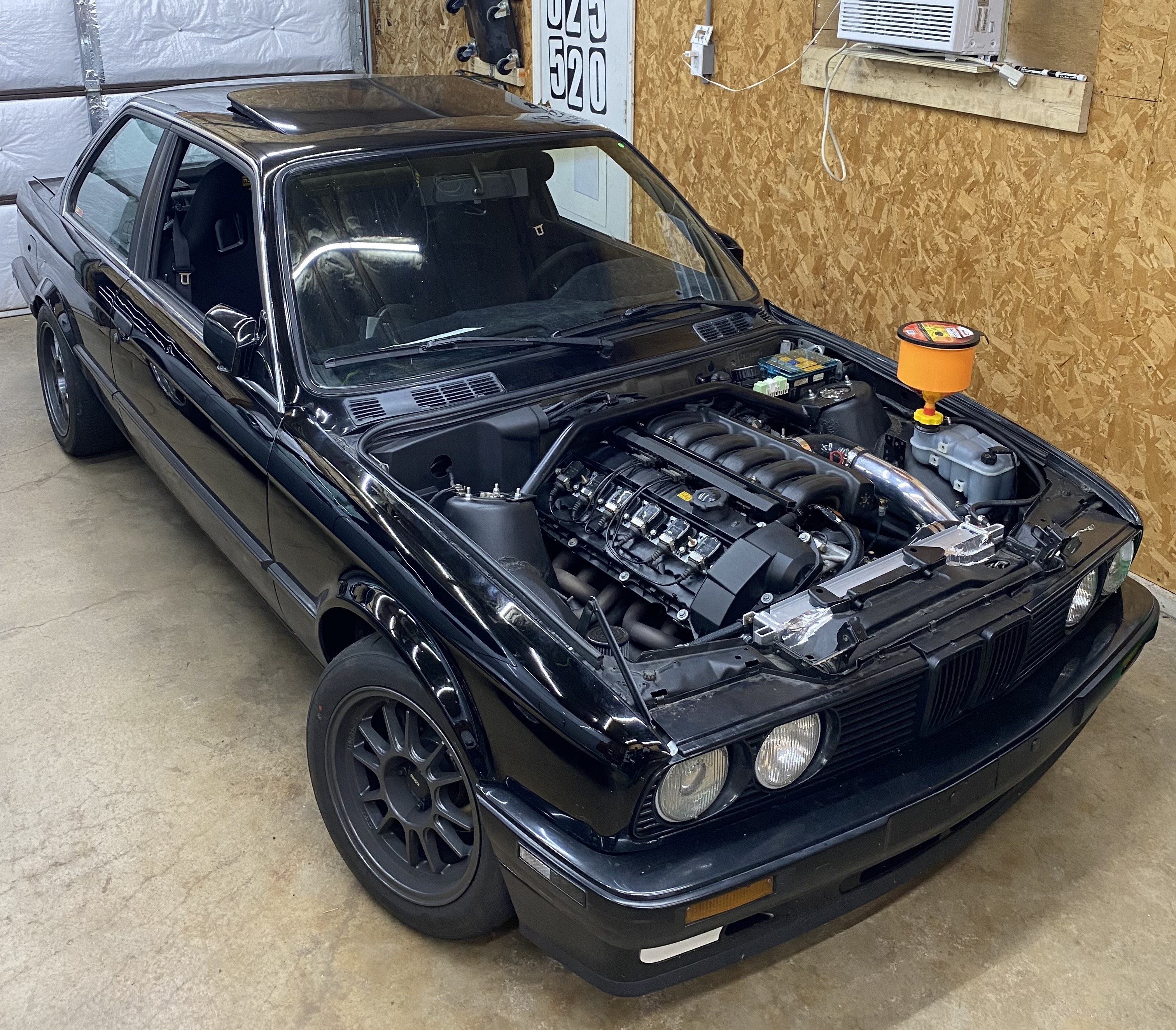

KaiserRolls Posted May 12, 2023 Author Report Share Posted May 12, 2023 New CSF rad is in, re-did the foam in between the rad and the core support to seal up air gaps, replaced the tstat, replaced the ecu temp sender in the head, re routed the catch can line, got a new fan harness/relay that is wired as a ground switched setup - future MS3 triggering perhaps earlier I mentioned I thought the fan was bad, but I think the mounts shifted and caused some binding between the shroud/fan. I tested the fan out of the car and all seems well (it’s a 2 year old SPAL pusher) just remounted a few brackets and gave it a touch more stand off from the radiator (1/4-3/8” standoff in case stuff moves around). currently have the glovebox and center console stuff out of the car to get some of the wiring cleaned up. Once it’s back together it will be more dialing in The tune/car Jdesign 1 Quote Link to comment Share on other sites More sharing options...
KaiserRolls Posted May 16, 2023 Author Report Share Posted May 16, 2023 Used the install of the new fan wiring as an excuse to Clean up a bunch of wiring for the MS3, gauge wiring, and other stuff I had been putting off as I hate removing all the interior stuff. Got it all buttoned back up last night. Tonight going to rebleed the coolant after putting in the new radiator. eventually I should probably have it aligned, but next up is making a mount for the MS3 as it’s just hanging out in the glovebox & making some type of heat shield to go in between the filter/engine Bay Area along the frame rail Boris3, m42b32 and Jdesign 3 Quote Link to comment Share on other sites More sharing options...
Boris3 Posted May 16, 2023 Report Share Posted May 16, 2023 Is that the EPAuto coolant kit on the reservoir? Always wondered about those. Quote Link to comment Share on other sites More sharing options...
KaiserRolls Posted May 17, 2023 Author Report Share Posted May 17, 2023 5 hours ago, Boris3 said: Is that the EPAuto coolant kit on the reservoir? Always wondered about those. Yes sir EPAuto Spill Proof Radiator Coolant Filling Funnel Kit https://a.co/d/cM6Vx8S I use a combo of the red neck, yellow cap & I steal the stock gasket from the stock expansion tank cap it looks like they may have updated it since 2020, so YMMV on the colors. it works great, makes bleeding super easy Boris3 1 Quote Link to comment Share on other sites More sharing options...

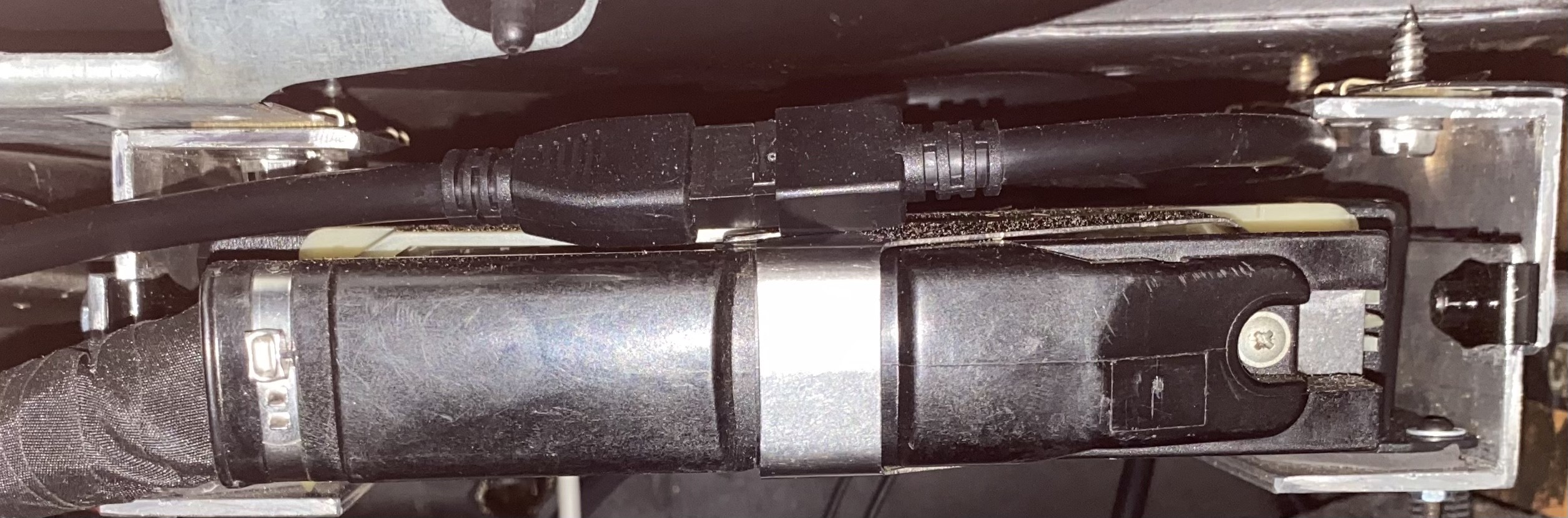

KaiserRolls Posted July 21, 2023 Author Report Share Posted July 21, 2023 Car has been pretty solid since the last update, I did end up making a (crude) mount for the MS3 to get it out of the way in the glovebox Finally got the car out to an HPDE at USAIR. So glad the new management is cool with these events. There was a morning and afternoon session, we only signed up for the morning. It was a total of 4, 15 minute sessions for $125 (afternoon would’ve been an additional $125) - autox out there is usually $55 for 8 runs- Ended up being about 36 miles of laps. Car exceeded expectations as it didn’t break lol. Temps stayed in check the entire day. Coolant temps maybe peaked around 210/215 and came down very quickly on a cool down lap. Oil temps were maybe around 230 or so at their peak The chase bays power steering reservoir with their “spill proof baffled design” did just the opposite, had to wipe that up between sessions. Had one weird issue with the expansion tank cap, seemed like the orings/gasket had the worlds smallest leak and it would mist the intake pipe during the session. New cap will be here soon & expansion tank just in case. This was the quick fix trackside car used maybe 1/4 tank of fuel, GFs evo x went through like 15 gallons of e85 lol Nankang CR-1 were also a casualty, this event finished them off after 2 years of service, no complaints there—might try their updated 200tw compound “CR-S” i only ran the racebox gps on 2/4 sessions, borrowed it out to a few cars on the other sessions-still need to get those laps overlayed but here’s some footage from the day this was one of the last sessions so tires were pretty smoked Next lapping day is in September. This one actually still had open spots, definitely recommend. next on the list is to order up some tires and change all the fluids AsparagusMike, Boris3, P_Roloff and 2 others 5 Quote Link to comment Share on other sites More sharing options...

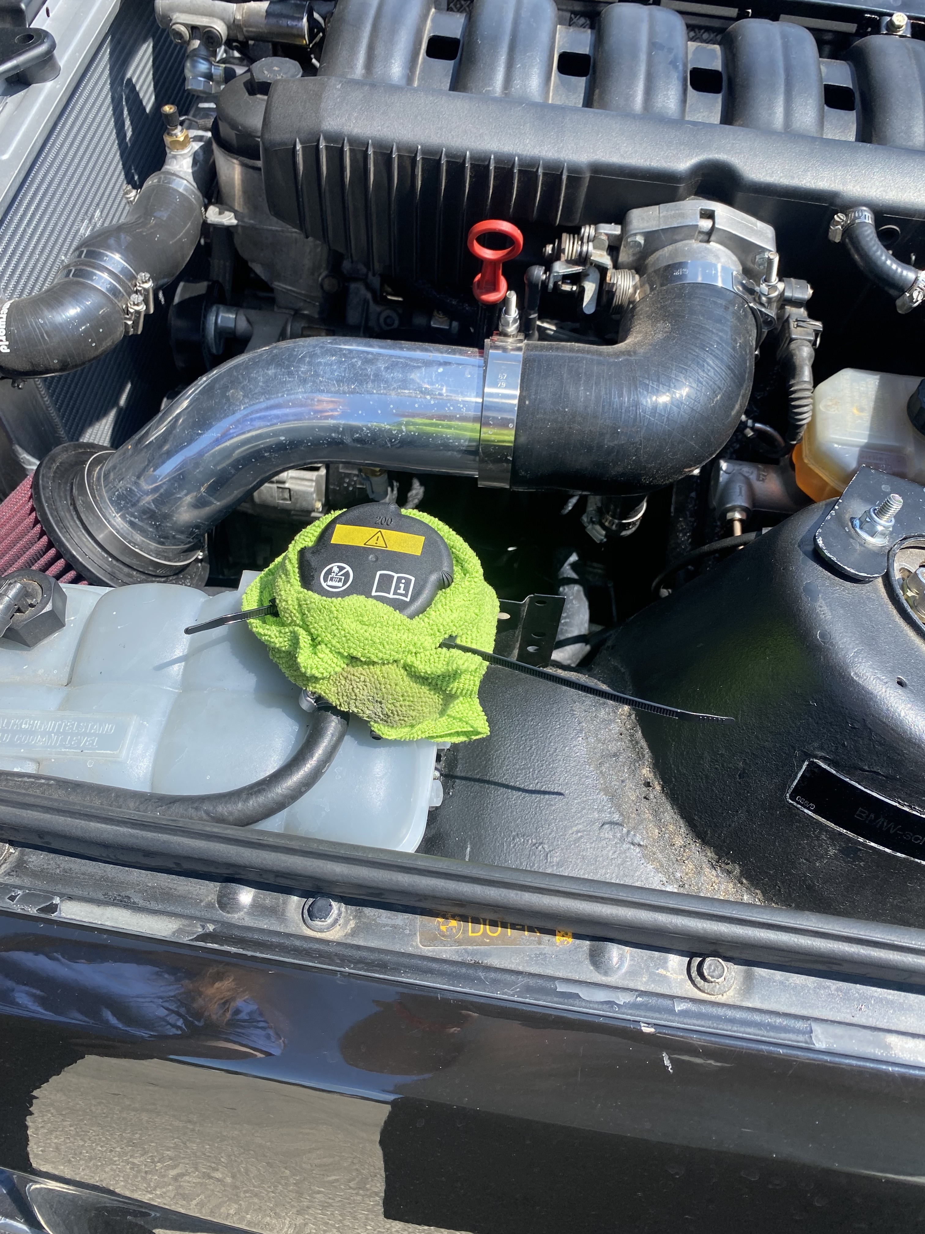

KaiserRolls Posted August 23, 2023 Author Report Share Posted August 23, 2023 Had another autox event as USAIR this last weekend. New layout this time around which was interesting. i coned my fastest run, but still had a time on the books good enough for 1st in XSB and 3rd/132 total drivers I’ll have to change the expansion tank out to my spare new one. Same-ish issue from the lapping day persisted even with a new cap. I think the neck/threaded portion of the tank is screwed damnboy037, jc43089, patsbimmer1 and 2 others 4 1 Quote Link to comment Share on other sites More sharing options...

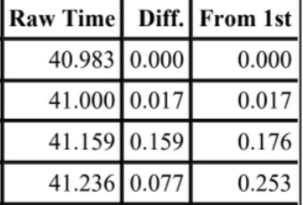

Rekpoint Posted September 5, 2023 Report Share Posted September 5, 2023 The "FAWK" at the end KaiserRolls 1 Quote Link to comment Share on other sites More sharing options...
KaiserRolls Posted September 5, 2023 Author Report Share Posted September 5, 2023 9 hours ago, Rekpoint said: The "FAWK" at the end I couldn’t find any more time lol. 1-6 place was basically all within half a second from 1st Jdesign 1 Quote Link to comment Share on other sites More sharing options...
