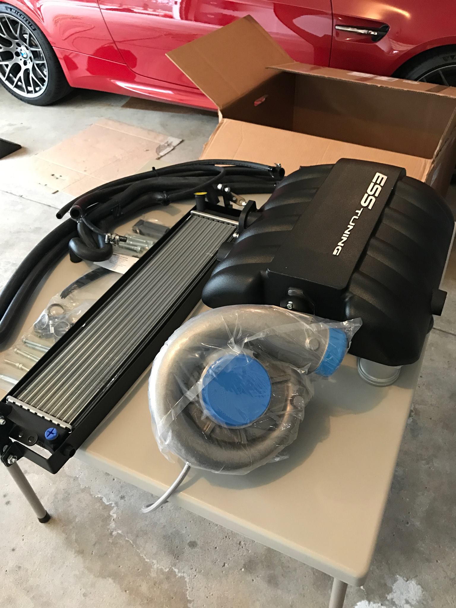

i_love_cars Posted April 15, 2018 Author Report Share Posted April 15, 2018 Ok so everyone else is doing cool builds and as usual I don't have anything unique to add to the conversation - just basic beta bitch mods like bolt-on superchargers. I walked away from the deal for the used 625 kit that had the red painted manifold. It looked good in photos but I know it was also a $15 rattle can job. Not a professional paint job like you'd get from iND or something. The guy wanted $6250 for his kit and on top of that you need to drop $1000 to get a new tune from ESS because they are locked to a VIN. I just couldn't fully bring myself to spend that kind of money for a used supercharger kit compared to the price of a brand new one that comes with a 2 year warranty. So I called up EAS and they quoted me $7720 shipped for a brand new kit (which includes a tune). It's a no-brainer at that point to just buy it new. The extra $500 guarantees no missing parts and everything works. I also ordered a set of BE rod bearings and ARP bolts. They were back-ordered until March 31 (i placed my order on March 22nd or so) and I'm glad I did because as of now they are already backordered again until July 1. Lots of S65 owners are buying up these bearings because they have increased clearance, but not so much that there is any real impact to oil pressure at high rpms. The supercharger showed up earlier this week and I'm still waiting on the bearings. Install plans have been delayed because ....well I mean just look outside. It's cold in my garage too. I will be outsourcing the rod bearing install to Efab Motorsports in Lake Zurich. They are doing a labor special on rod bearing service for $700 during the month of April. I'll have them throw in new motor mounts while they are at it because for whatever reason the mounts on this car are a 50k mile maintenance item and the subframe will be down already. The shop owner has a VO 1M that I am excited to look at when I go down there. I am scheduled to drop the car off for RB service on May 1 and pick it up May 3. Jdesign, wasnt m3, SteelBlue and 1 other 4 Quote Link to comment Share on other sites More sharing options...

i_love_cars Posted April 24, 2018 Author Report Share Posted April 24, 2018 Started on the install process on Saturday and by Sunday I was ready to mount the supercharger, then I noticed that I had received the wrong belt from ESS. They shipped me a belt for a 650 kit with 7 ribs instead of 6. I sourced a comparable belt from Napa on Sunday at 2120mm which is just 5mm shorter than what the normal 625 kit includes. They are overnighting me the correct belt so whatever I'll swap it tomorrow. What's more troubling is that ESS also gave me the wrong tune file. It is fortunate that I am DIYing this install because I don't think even a reputable BMW shop would have recognized that the tune file name ended in "124" which is what ESS uses to identify tunes intended for their black fuel injectors, as 124 is the last 3 of the part number. They shipped my kit with white injectors which have different flow rates and has a different tune. DOn't ask me why ESS has changed injectors over the years - the power is the same regardless, the tune just needs to be calibrated for the right flow rate. I'm sure if I had a shop install this, I'd be driving around wondering why the fuck my car is running like dog shit and potentially leaning out. Turnaround was quick and I got my updated tune file from them today for the white injectors that I have in my kit. So now I think all is well. I'm 98% done. Should be driving the car tomorrow - the only things left to do is hook up the air filter, put the radiator fan shroud back in, top the coolant off, and start the car. P_Roloff, wasnt m3, KaiserRolls and 6 others 9 Quote Link to comment Share on other sites More sharing options...

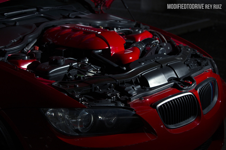

i_love_cars Posted April 25, 2018 Author Report Share Posted April 25, 2018 Car is up and running. TJ did stop by and confirm I did not fuck it up. I needed a witness. I'm not used to superchargers *at all* so I was freaking out about all the noises. Then I learned some things. 200 mile break-in period for the supercharger gears/bearing/seals and to allow the ECU to adapt to the tune. Luckily I have a 93 mile one-way drive on Sunday to get my rod bearings replaced ! MPW3RLee, P_Roloff, B C and 1 other 4 Quote Link to comment Share on other sites More sharing options...
Jdesign Posted April 25, 2018 Report Share Posted April 25, 2018 Oh man this is epic. That looks top notch. Now all we need is videos of sweet whining noises and tires smoking. Quote Link to comment Share on other sites More sharing options...
Daggerty Posted April 25, 2018 Report Share Posted April 25, 2018 This is cool Quote Link to comment Share on other sites More sharing options...
Jdesign Posted May 8, 2018 Report Share Posted May 8, 2018 I saw your car at C&C but didnt get a chance to chat. Car looked good, the SC in the bay looked even better. 😍 Quote Link to comment Share on other sites More sharing options...

B C Posted September 9, 2019 Report Share Posted September 9, 2019 You've done very well! Seeing this car always gets me excited. For those who have not experienced it: The supercharger on this car is so stealth. Aside from the stong pull, you would have a hard time noticing that it was supercharged while listening to the engine. It retains the awesome rip of the ITB V8 without sounding like an air raid siren like many blowers do. i_love_cars 1 Quote Link to comment Share on other sites More sharing options...
