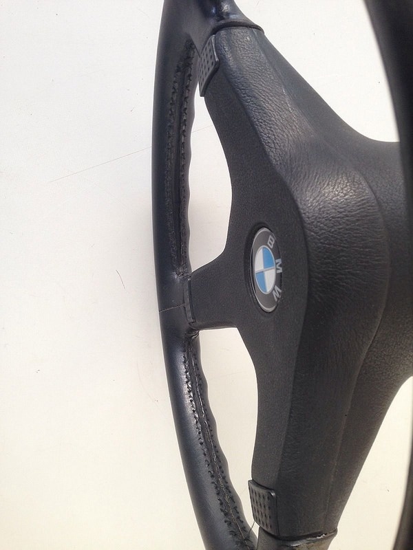

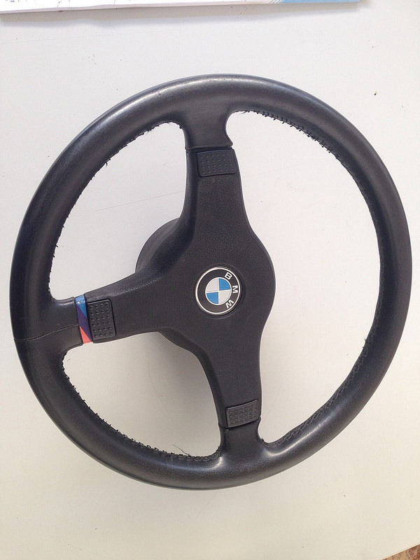

Picked up a 370mm mtech 1 wheel. I really like my 385mm mtech 1 wheel but with my steel toe boots for work I can't get in my car without hitting my knee. The stitching is coming apart but the leather is in perfect shape. Anyone good with a needle or know a good upholstery shop that can re-stitch it for me?
