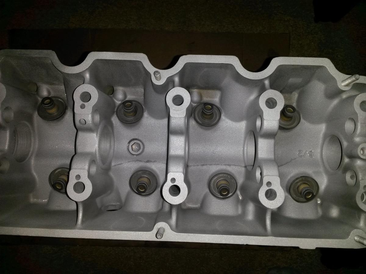

TehRaydarlover Posted May 1, 2015 Author Report Share Posted May 1, 2015 Do they make a cutring gasket for m20's?I am running a Cosmetic MLS on my M3 and have had no issues with it during the 2k miles it's been in there.A cut ring gasket is what I originally wanted to go with, the only place I found was Pure Performance Factory, Hard to find any information about the gaskets. They don't list any gasket thicknesses so after I realized the head had been decked so much I kind of stopped looking. If you know of anyone else who makes them I'd like to know! http://server.pure-pf.com/webshop2/index.php?id_category=162&controller=category&id_lang=1 My concern with the thicker MLS gasket is that I would have a thicker cross section open to the cylinder, would think it would see a lot more stress than normal. idk maybe I'm worried about nothing. What kind of CR do you think you would end up with if you go with a thicker oe gasket? Have you thought about embracing the higher compression and running a methanol injection setup? Otherwise i think the MLS will work fine. Kind of an intro to a whole new topic but I my at the point where I have everything except pistons, I would like to use Metric Mechanic 3.1L turbo pistons. I've called and talked with Jim and with their pistons they also run a 21mm wrist pin and 134.5mm rods combo yields a 8.3:1 CR. I already have a set of 135mm carrillo rods that I would like to use, I can't remember exactly but I believe with the 135mm rod and 22mm wrist pin the CR would be in the mid 9's. Which is a little higher than I would like to have. I have thought about methanol injection, and would be fine, even If I can get the CR lowered it wouldn't be a bad idea to have it. Get one of those OEM extended gas tanks that fits in the trunk and have that be the meth tank, would be pretty slick. A higher CR would be nicer for off boost driving. Maybe you have some advice on piston manufactures. Been kind of dragging my feet trying to decide what to do about this. Quote Link to comment Share on other sites More sharing options...

TehRaydarlover Posted May 1, 2015 Author Report Share Posted May 1, 2015 Thanks!Measured the head height this morning. It's 4.898" so compared to stock it has had 0.027" shaved off. Quote Link to comment Share on other sites More sharing options...
