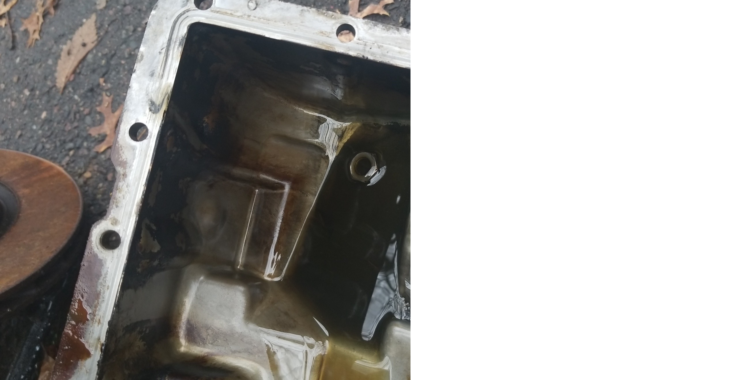

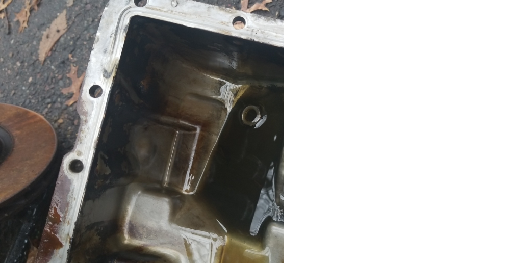

GunMetalGrey Posted September 25, 2018 Report Share Posted September 25, 2018 Or the oil pump nut laying in the oil pan.... I figured I'd be the ray of sunshine here. AsparagusMike, Jdesign, ChrisO and 1 other 3 1 Quote Link to comment Share on other sites More sharing options...
Rekpoint Posted September 27, 2018 Author Report Share Posted September 27, 2018 On 9/25/2018 at 1:52 PM, GunMetalGrey said: Or the oil pump nut laying in the oil pan.... I figured I'd be the ray of sunshine here. I seriously hope you are a ray of sunshine ❤️ Going to drop the pan tomorrow... See whats up. Quote Link to comment Share on other sites More sharing options...

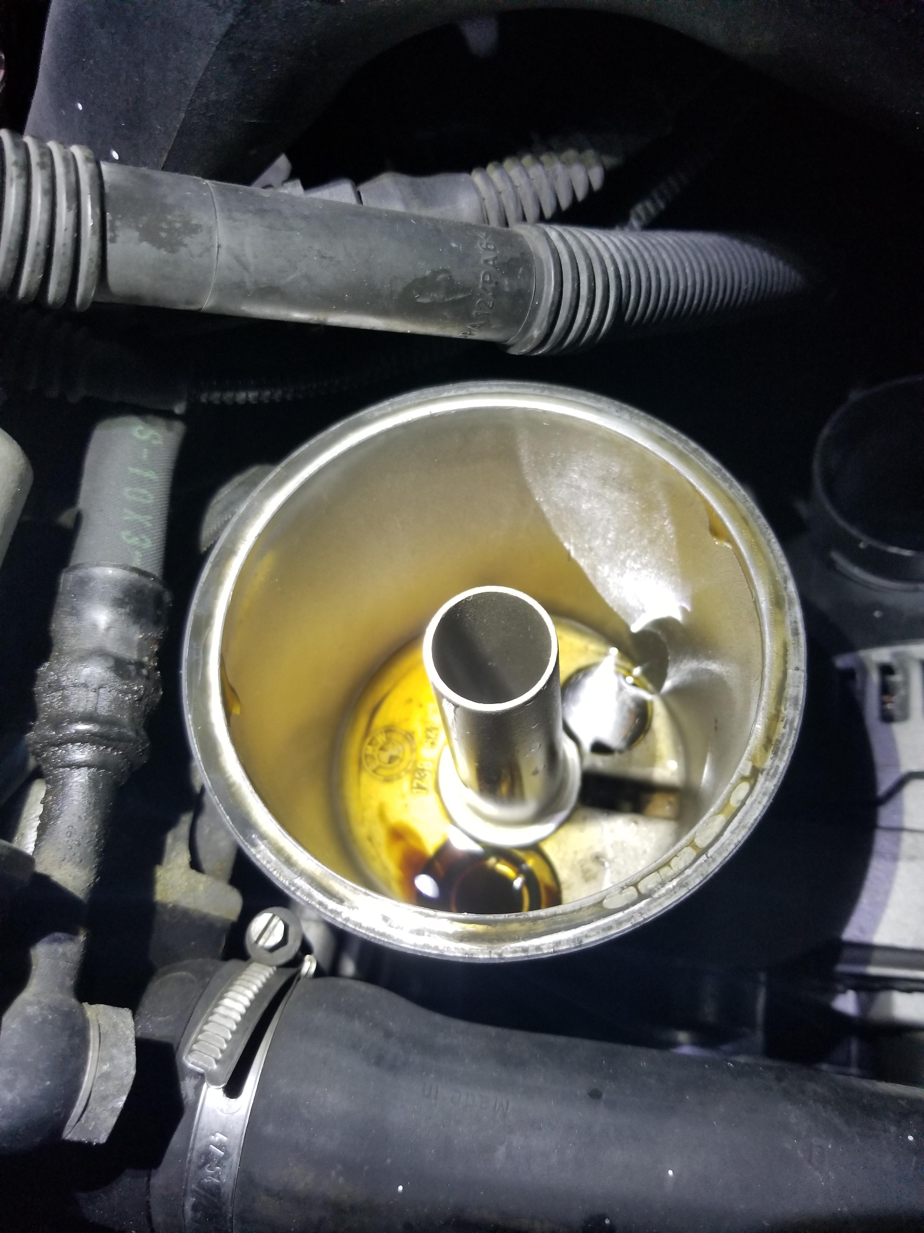

Rekpoint Posted October 30, 2018 Author Report Share Posted October 30, 2018 I had intentions of dropping the sub-frame to do the oil pump nut/ oil pump. ive been delaying it for weeks. I bought an engine support brace for the job and was going to pay a buddy to do it. (Ive been drowning with no motivation for ANYTHING at all) I have all the stuff for the oil nut replacement but I think I lucked out. I was thinking tonight. And I came to the conclusion I should actually check the oil filter housing to see if it was draining properly. I put some fresh oil in it and from what I see here is its not draining properly and thats why my new oil filter didn't get any oil on it and I had the oil pressure light. I ordered the gasket for the housing and Im going to start pulling it tomorrow. After that It will be up for sale. (I dont expect anybody from here to buy it) It would be a good drift car for someone though... Quote Link to comment Share on other sites More sharing options...
Rekpoint Posted October 30, 2018 Author Report Share Posted October 30, 2018 Starting to second guess myself. What does everyone else think? Quote Link to comment Share on other sites More sharing options...
jc43089 Posted October 30, 2018 Report Share Posted October 30, 2018 What do you mean by "not draining properly" It should not drain out the housing if the check valve is working. Mine is leaking and causes a rattle for about 10 seconds on startup. I bought a replacement but haven't had time to install it yet. Quote Link to comment Share on other sites More sharing options...

Rekpoint Posted November 25, 2018 Author Report Share Posted November 25, 2018 Full subframe was dropped last week. And this is what I found.... @GunMetalGrey called it.. Stupid nut. It will be put back together, new tires will be installed and it will be for sale shortly as I have nowhere to store it for the winter. what a PITA Side note add me on Snapchat if anyone is interested in what Rekpoint does day to day... SC : Rekpoint basedspider 1 Quote Link to comment Share on other sites More sharing options...
