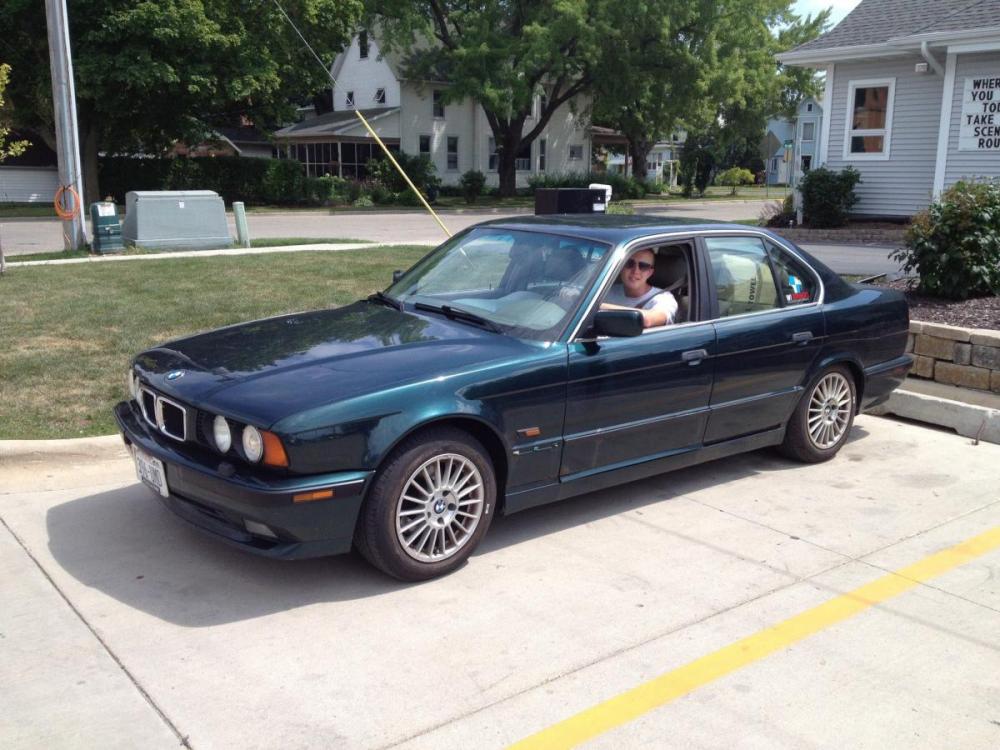

BMWben Posted October 26, 2014 Author Report Share Posted October 26, 2014 I got a little done on my car this week, I had dropped her off at a shop last Sunday to get the drive shaft work done. Picked her up this Wednesday and the guy who did the work told me the brakes had seized up bad. I somehow got her back to my grandparents place (brakes a smoking) and proceeded to order new calipers for the front. I started on the job last night, got the calipers off easy but the rotors and mounting bracket nuts would not budge. So I slept on it and picked up a blow torch this morning and gave it another go but still got no where. I decided to just try putting on the new calipers and just see what happens. I got the new calipers on and started to bleed the brakes and the bleeder screw on the rear passenger caliper decided to break clear off. Looks like I get to replace those one too. Maybe I can get it done next weekend but you never know. At least I finally got a chance to give her a good washing. Quote Link to comment Share on other sites More sharing options...

BMWben Posted October 30, 2014 Author Report Share Posted October 30, 2014 Finally got the car rolling last night! I threw on the back calipers and bled the brakes. Everything seemed to be in working order so I drove her back to school. I can't tell if the problems are completely fixed, there are is some noises the car still makes but they were probably there before and I'm not used to them. Maybe the new parts just need to be broken in a little, who knows. I can look into it some more this winter when I have time and money. At least I have my baby back for now at least. Quote Link to comment Share on other sites More sharing options...
