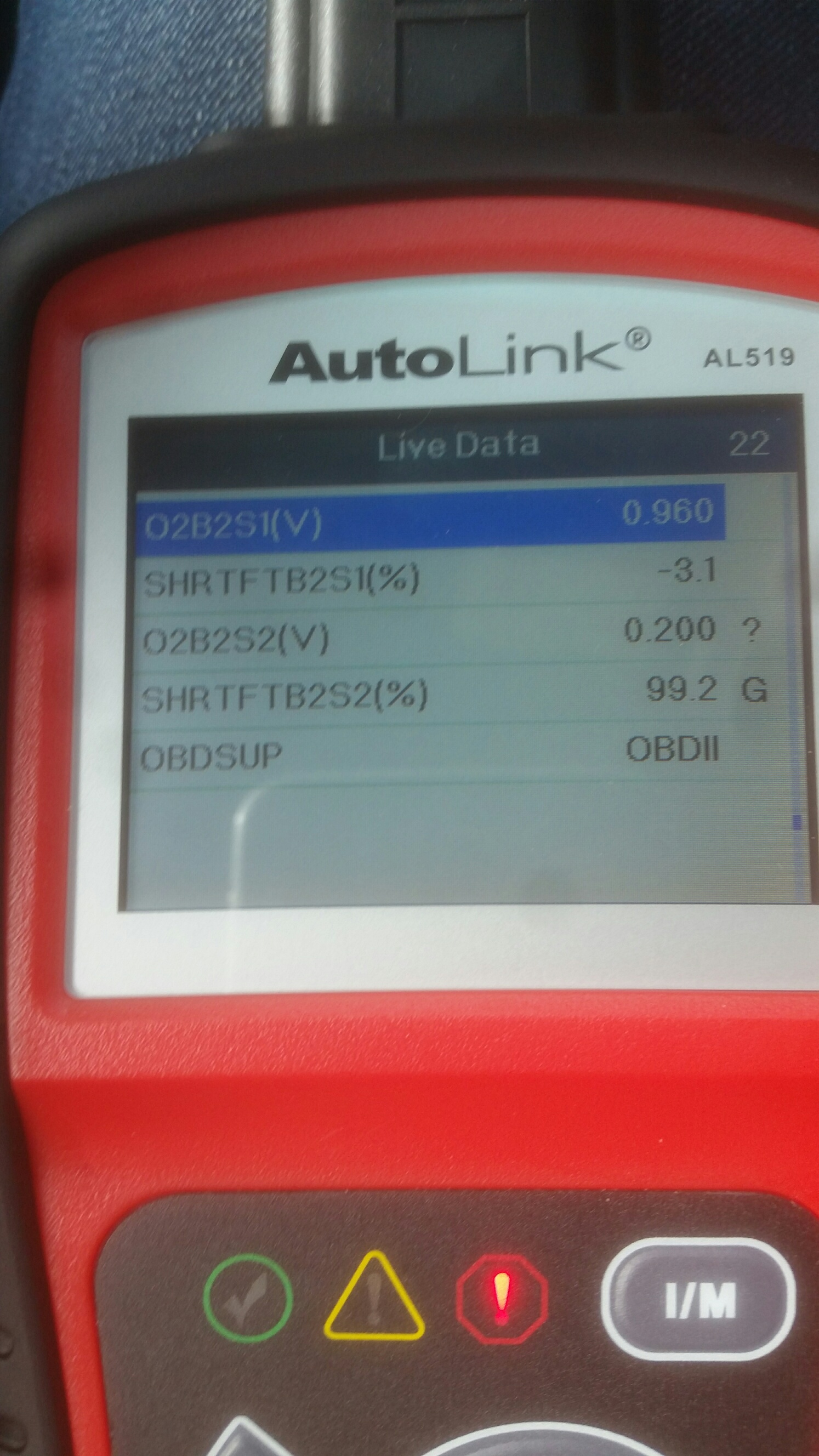

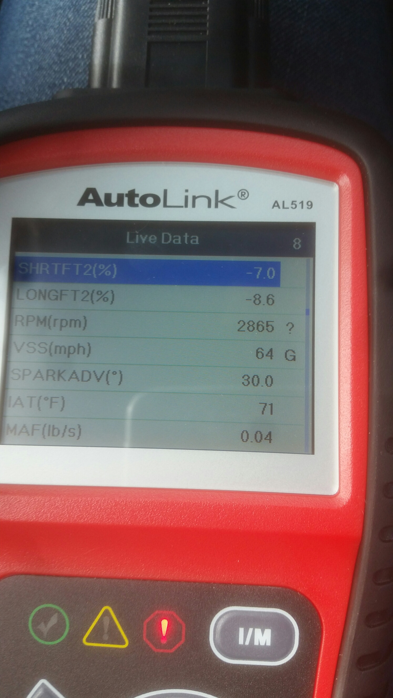

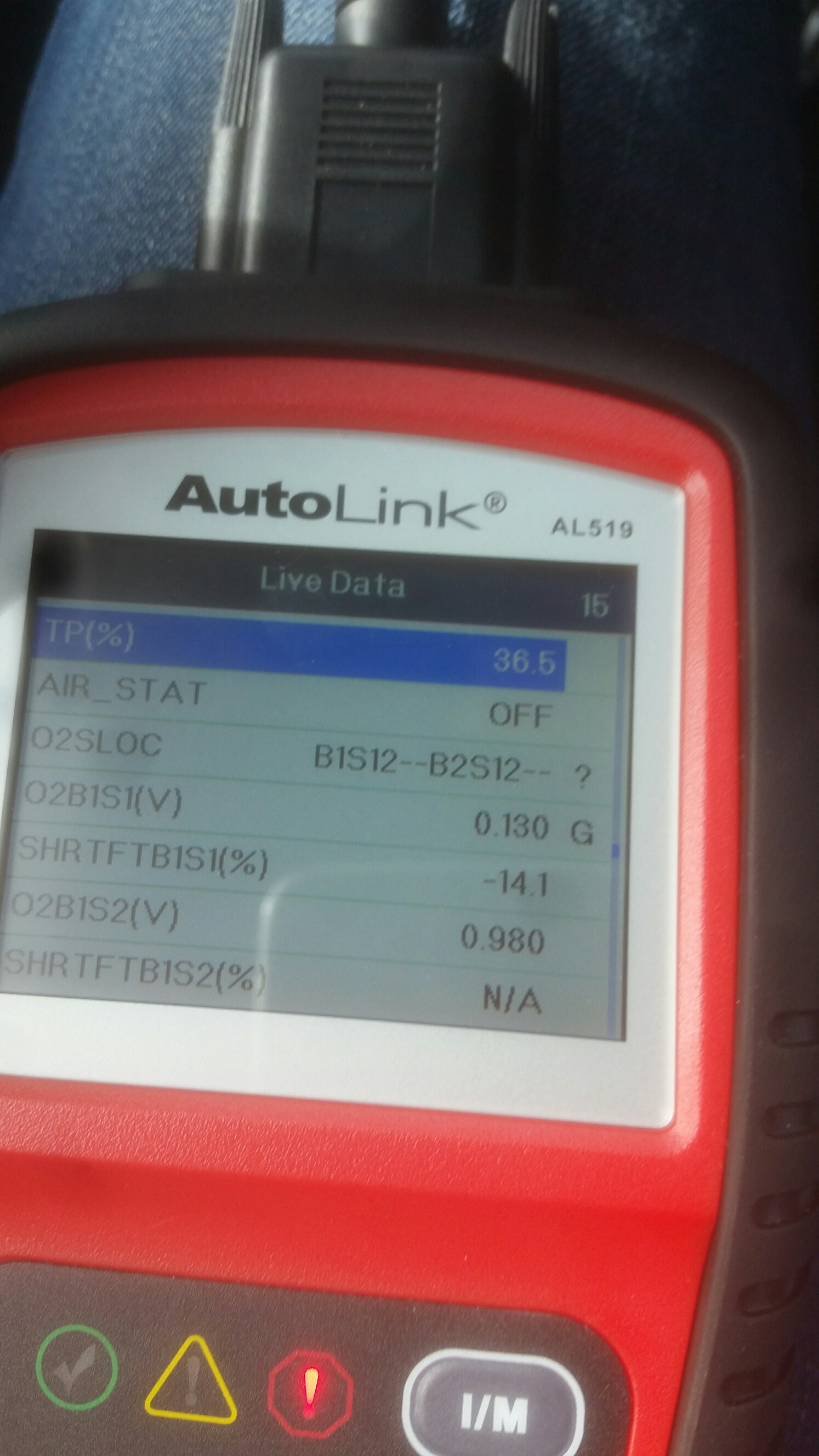

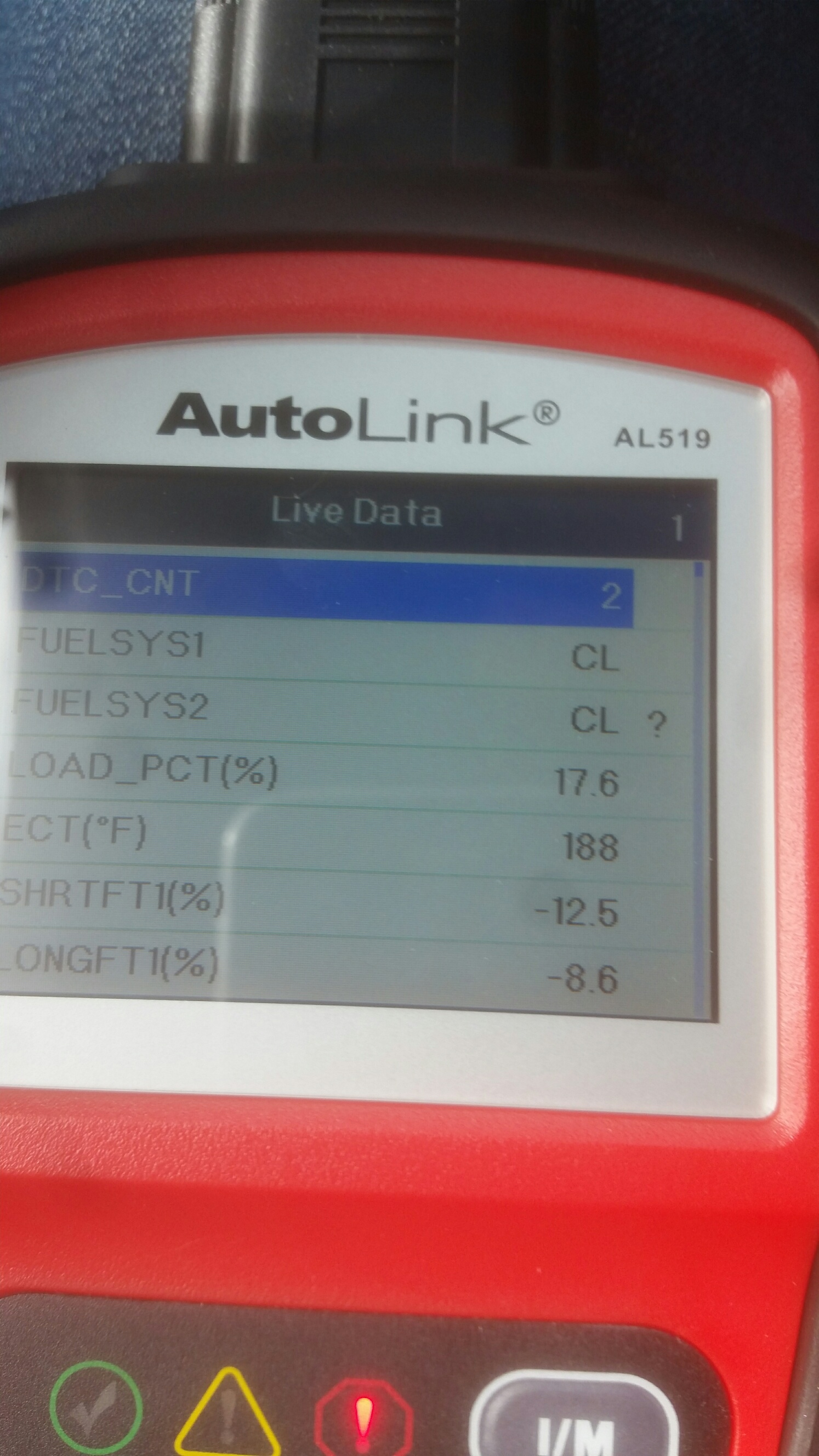

ok, code still there.  Update on some numbers I noticed while driving today.
Seems my short term fuel trim 1 is out of wack.  It stays around -18-20% while in gears 1-3 when going upto 4-5th gears at highway speeds it drops to -10.6-12% which still seems like a high number compared to SHRTFT2 which stays in the -3-6% range.  Long term still holds steady at -8.6% for both.
Thoughts if that might still point to a vacuum leak or fuel delivery issue?
Link to comment
Share on other sites
Your STFT is an instant reading of fuel being used and should remain similar across both banks.  If you have one bank out of wack then that bank may have an issue.  Running that far negative would point towards an over fueling issue and the ecu is trying to pull fuel away but you want to evaluate the numbers at idle and at 2500 rpm.  Leaky injector, bad maf, bad 02, those are a few items that could cause this.
