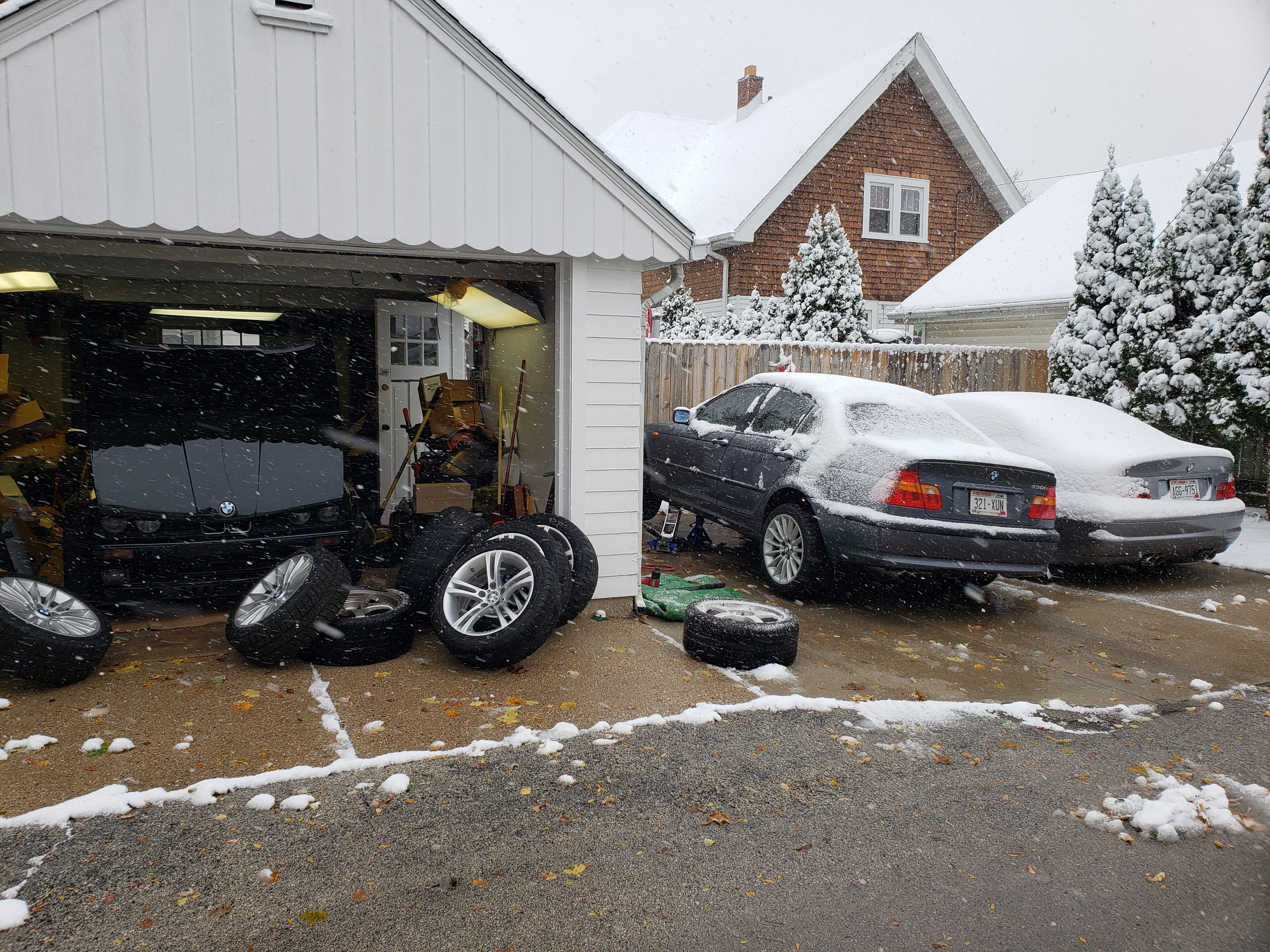

DrLeadFoot Posted December 20, 2020 Author Report Share Posted December 20, 2020 Trans started slipping so got it replaced with a 94k mile trans out of a 325xi. Got the starter rebuilt, new trans filter/gasket. Tensioner & idler pullies replaced. New oil filter housing gasket and hood latches. Mike also made the rust dissappear by the rear wheel arches. Not bad for a napa rattle can! Now we just need some snow! All work done at 212k miles. m42b32 and B C 2 Quote Link to comment Share on other sites More sharing options...
