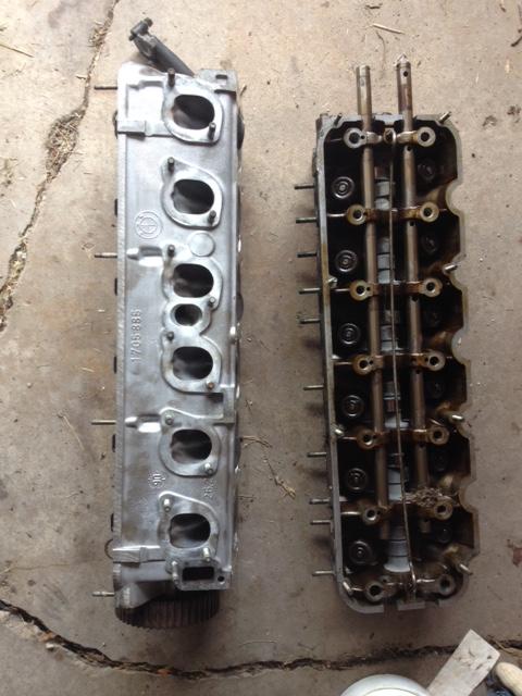

What is said damage to the head?
Most certainly not grounds for a part out.

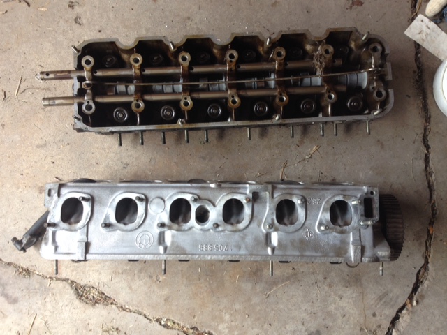

Said head damage is that it has a small nick on the undersurface that has to be welded, but it's also warped. The shop felt that in order to surface it enough to use it would require a hugely thick head gasket. Not sure I want to have to rely on a gasket to obtain proper clearance for the pistons and valves.

Well, decided to pop for the 855 casting head that was up for sale on Ebay. Not the place I would have preferred to buy, but since everything else I found anywhere was going for around $500 or more, $299 seemed pretty reasonable assuming that the thing isn't junk. I guess I'll find out for sure when I received it and take it in to get it surfaced.

Well, hope to get started on re-assembly this weekend and maybe on the road by Monday. Any suggestions for a newbie to head gasket replacement regarding setting the gasket and timing?
Got new head bolts, took a tap to each of the bolt holes to clean them up. All holes are dry and I took my parts retriever magnet to each of the holes to fish out any metal shavings from the tap. Took a razor blade to the top of the block and cleaned all the remnants of the old gasket, and cleaned the front of the block to set myself up for success on the water pump.

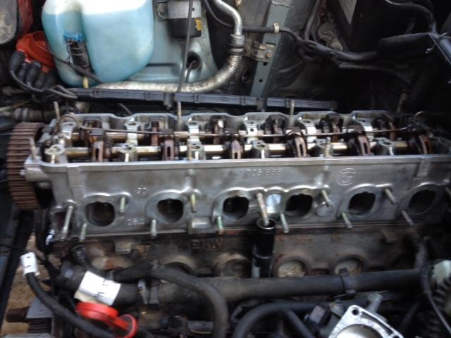

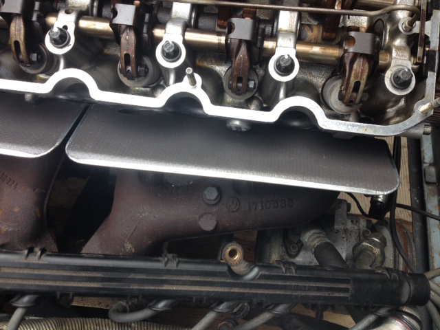

Weekend wasn't engine re-assembly friendly. I did, however, manage to get the head situated on the block last night with bypass hose reconnected and head bolts turned in just enough to have the caps flush with the metal. Today comes head bolt torqueing, valve adjustment, exhaust manifold attachment and hopefully thermostat housing and hose attachment.

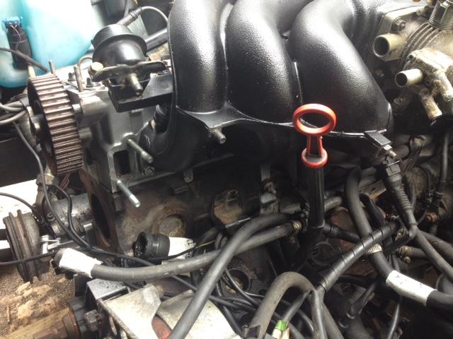

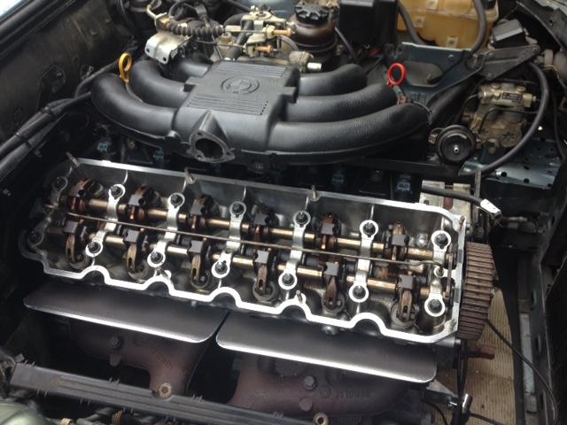

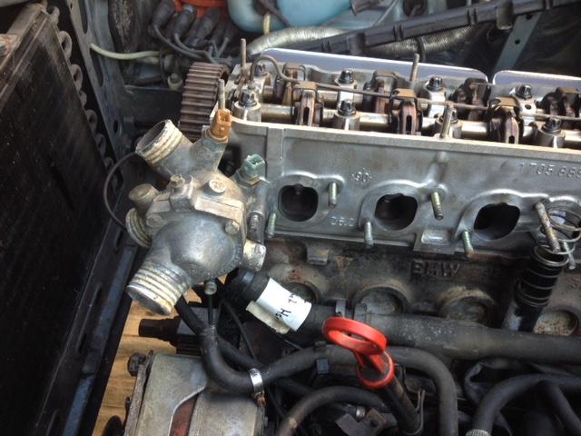

A few more pics from yesterday. Got the intake and valve body on, as well as the exhaust manifolds connected. Today, got the valve body torqued in, the throttle cables attached, the thermostat housing attached, and the hoses for it that were in the car re-attached to it. Plugged in the fuel injectors, fuel lines and thermostat cables, and pretty much got the left side of the engine done save for the bellows, MAF and air box. Also got the new water pump and gasket attached finger tight. Hope to torque the water pump bolts and get most if not all of the timing belt in tomorrow. Might even get him on the road!!

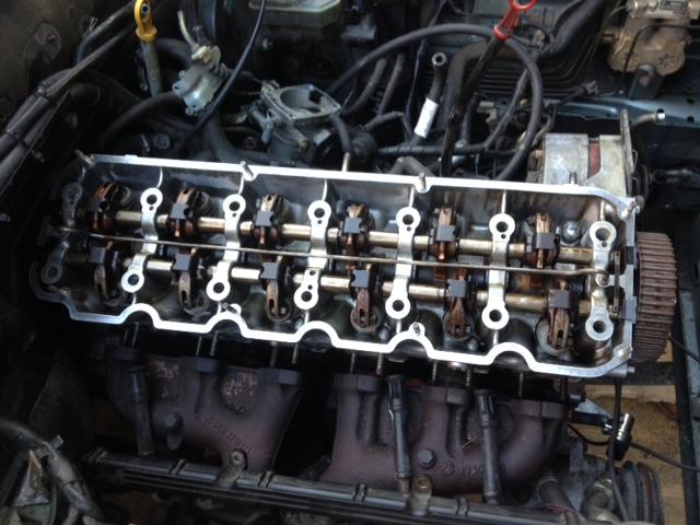

Made really good progress on Friday. Got the timing belt on and nearly complete. Only thing left is to put the fan on and put the coolant in, then hope that it starts and runs right.
I assume that putting the antifreeze in goes like usual; pour in through overflow tank with engine running, heater defroster on and bleed screw cracked? Haven't refilled a coolant-less engine in quite a while.
