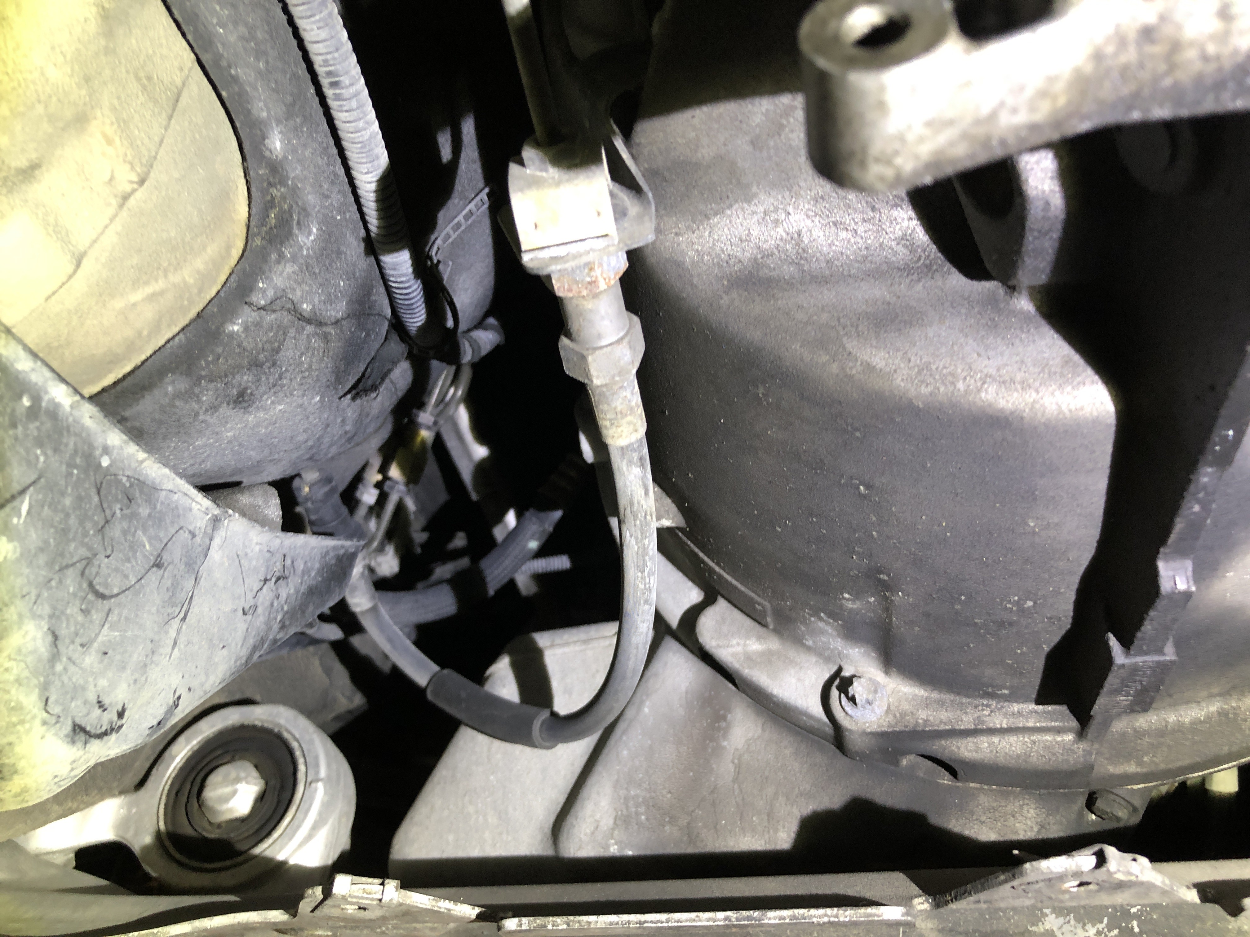

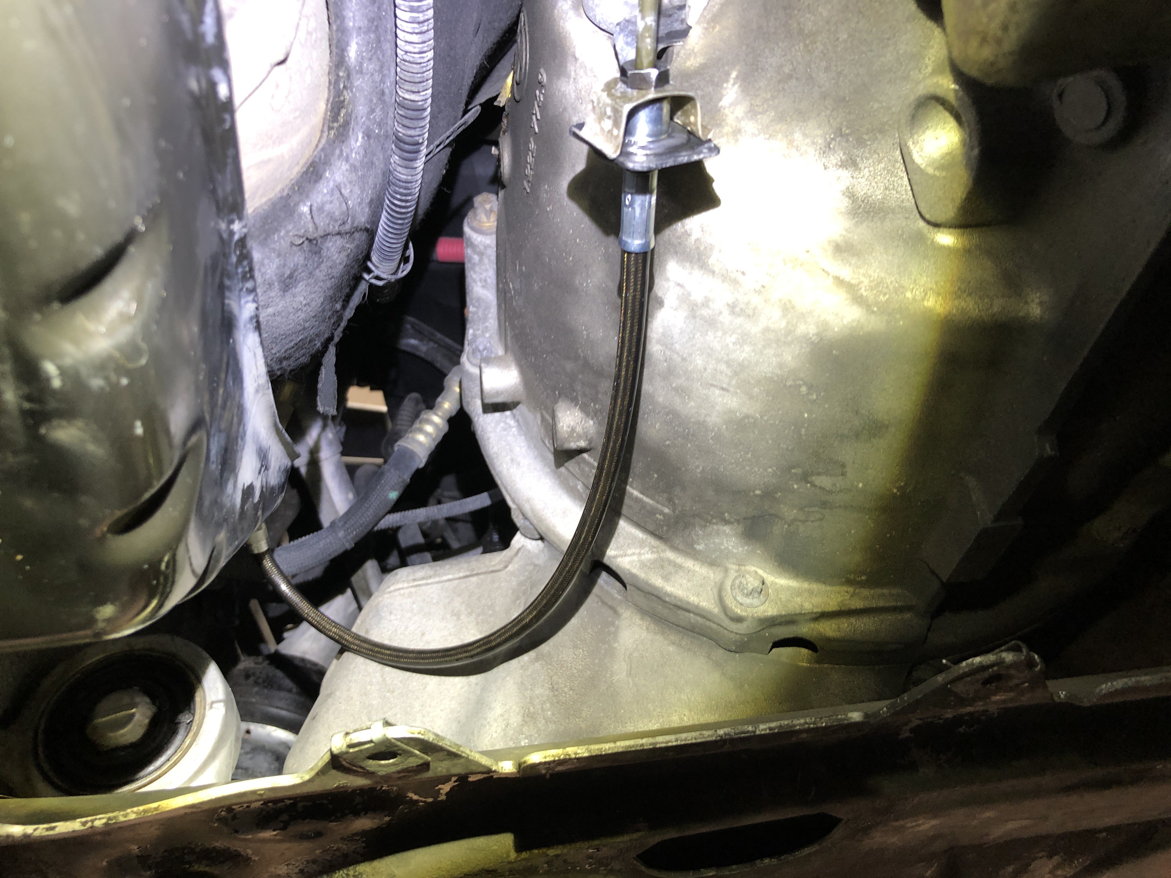

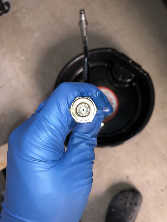

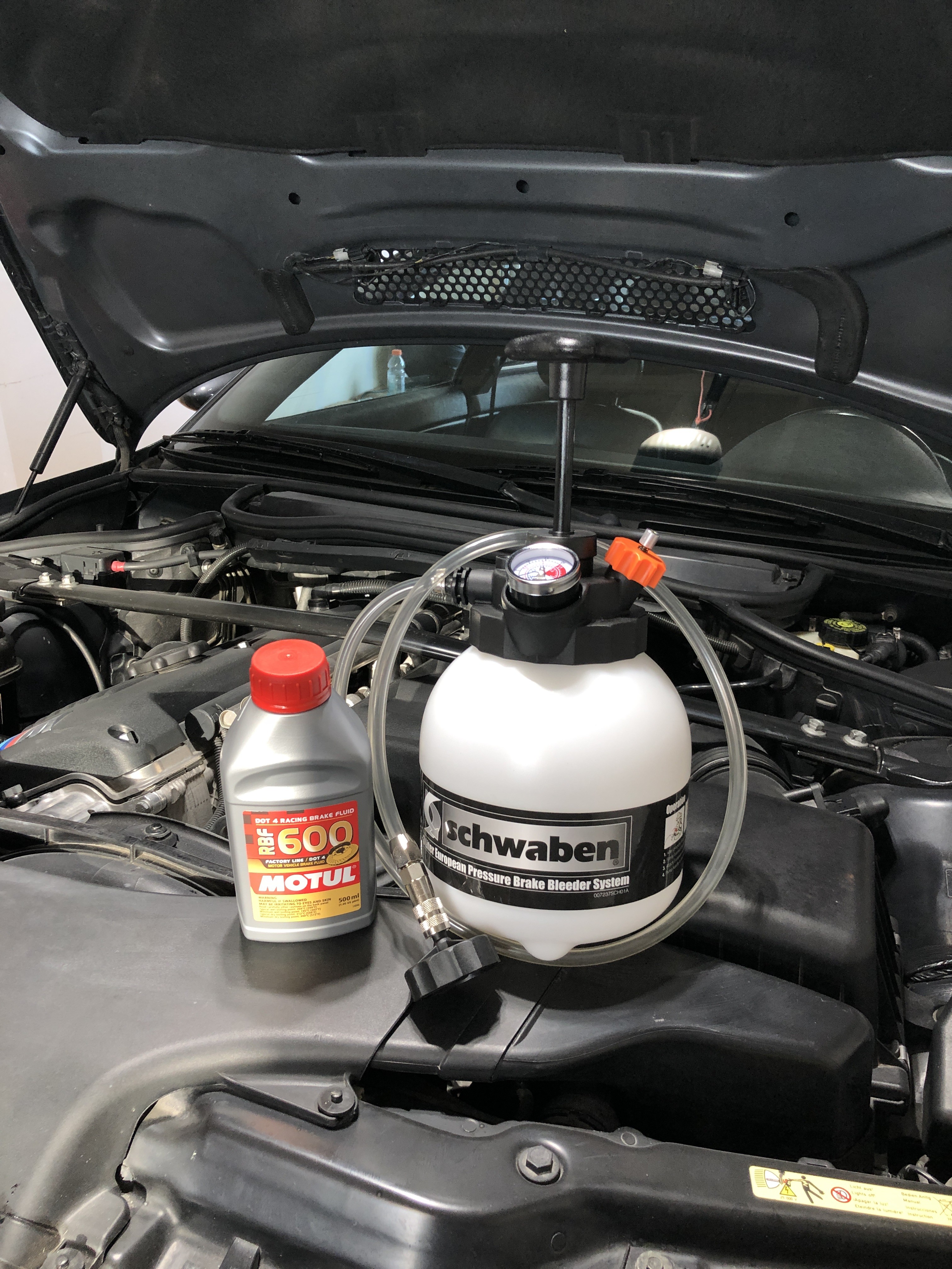

pynacl Posted September 5, 2021 Author Report Share Posted September 5, 2021 Finally installed the Rogue Engineering stainless clutch line I've had on the shelf for months. Mainly did this to remove the clutch delay valve for a more responsive clutch feel. Job was messy as all hell but a power bleeder made the bleeding process a breeze. Took it for a test drive and it definitely feels more responsive. Not a night and day difference per say, but totally worth it. Frig I love this car straight6pwr, Rekpoint, Jdesign and 1 other 4 Quote Link to comment Share on other sites More sharing options...

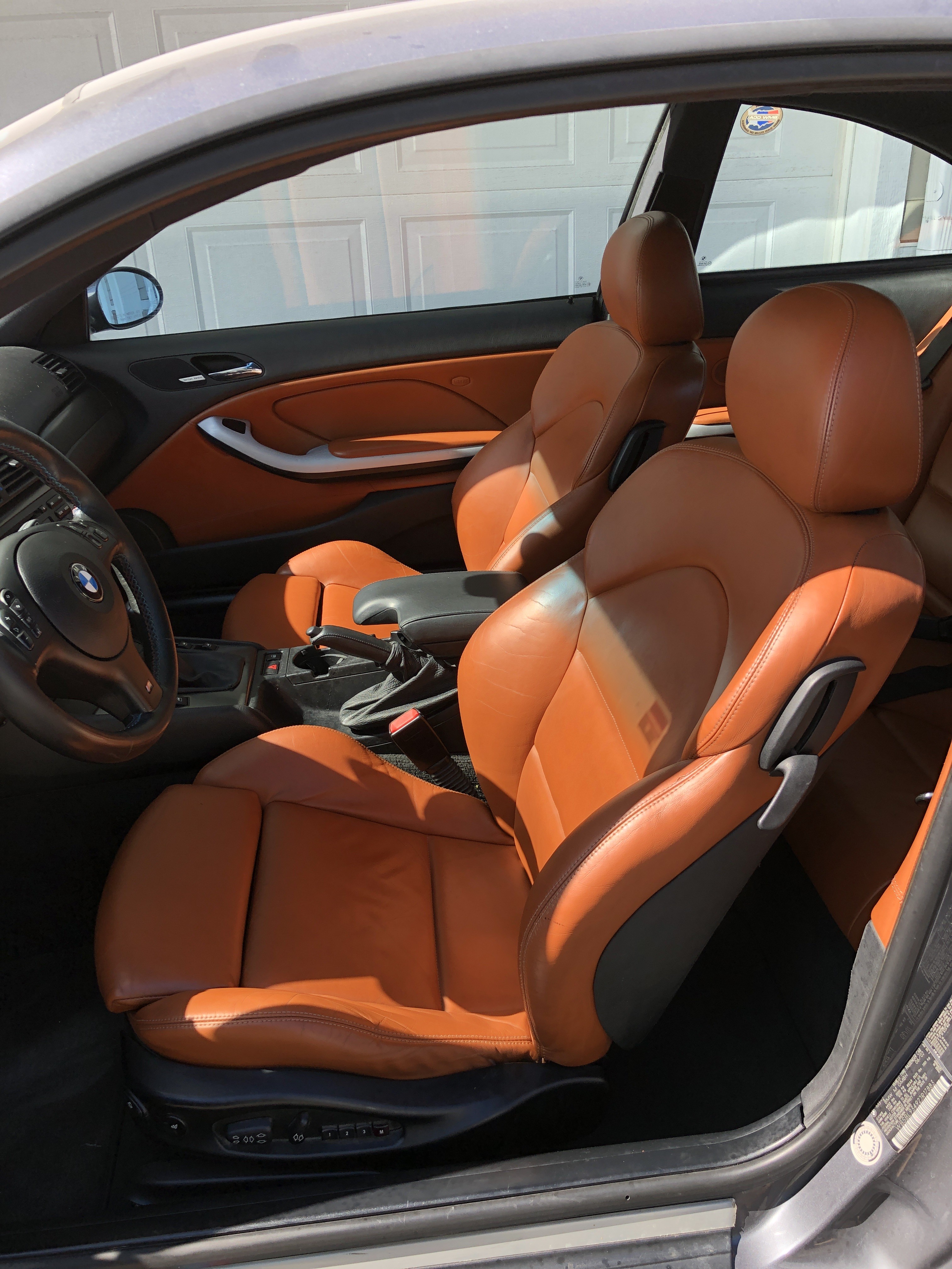

pynacl Posted September 13, 2021 Author Report Share Posted September 13, 2021 Where might a great condition cinnamon interior be hiding? In a rebuilt title, dumpster of an M3 of course! Bought this 110k Imola on cinnamon E46 M3 yesterday to be a donor car. I'm swapping the cinnamon interior into my Steel Gray M3, then selling the car for a break even price to another for the motor/trans. Free cinnamon interior Also found the car has a sweet Eisenmann exhaust setup. I'm donating it to @Rekpoint for all his help dismantling the interior and helping with the swap, everybody wins! Rekpoint, Jdesign, patsbimmer1 and 1 other 4 Quote Link to comment Share on other sites More sharing options...

pynacl Posted September 13, 2021 Author Report Share Posted September 13, 2021 The seats were REAL shiny. I tried hitting them with some Lexol leather cleaner and a microfiber and it didn't put a dent in it. I know it's a sin, but I VERY carefully used a magic eraser (with zero pressure applied) and Adam's interior detail as lubricant. I was careful to only buff off the oils/grease and not damage the protective "clear coat" layer. Hard to tell from photos, but they look night and day different. edit: still need to swap the front door cards, just haven't had time yet Before: After: GunMetalGrey, P_Roloff, Rekpoint and 2 others 5 Quote Link to comment Share on other sites More sharing options...
GunMetalGrey Posted September 14, 2021 Report Share Posted September 14, 2021 Looks great, its amusing that shiny seats look bad, but yet here we are! The car you got them from was a sweet color combo! Quote Link to comment Share on other sites More sharing options...
pynacl Posted September 14, 2021 Author Report Share Posted September 14, 2021 18 hours ago, GunMetalGrey said: Looks great, its amusing that shiny seats look bad, but yet here we are! The car you got them from was a sweet color combo! Haha right? We want everything else shiny, except for those! Definitely agree the donor was a sweet spec. Unfortunately it has rear trunk floor and major quarter panel damage from the wreck so it’s just not worth saving. Although it was “rebuilt”, and you can’t tell from the outside, the quarter panel has major bondo and the trunk floor has signs it’s folded in before. Might make a cool drift car or something! Quote Link to comment Share on other sites More sharing options...

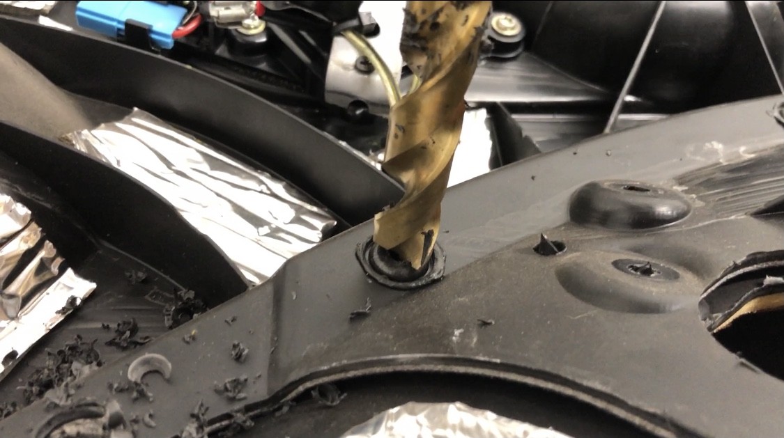

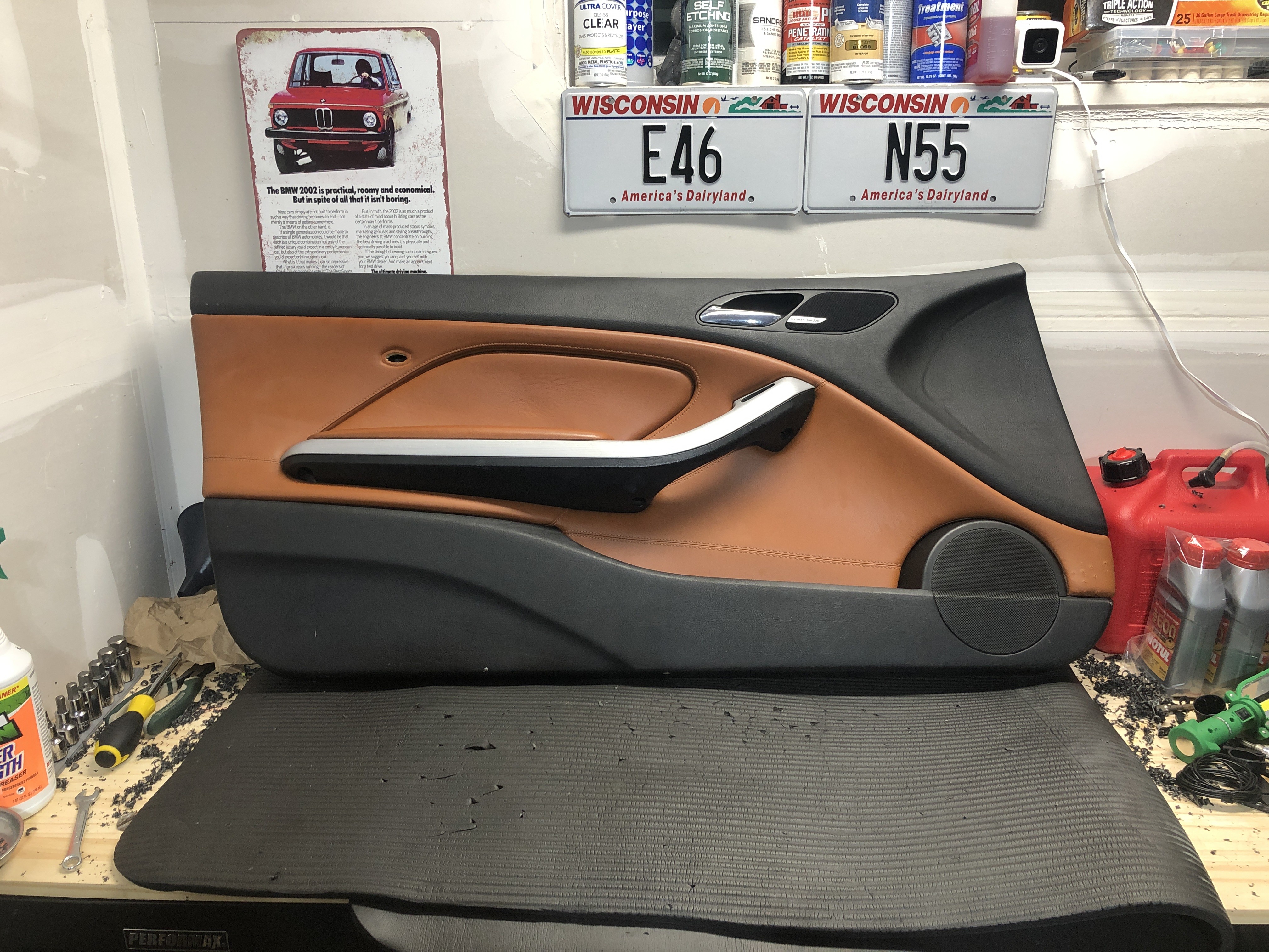

pynacl Posted September 17, 2021 Author Report Share Posted September 17, 2021 Saved the door cards for last since they were going to be the most involved. The previous owner cut the door cards for some janky ass aftermarket speakers, and used what looks like wood glue and Joann Fabrics clearance shelf felt to put it back together. So it wasn't going to be as simple as swapping door cards. The good news is the damage was exclusively the door card, and not the cinnamon insert. I was able to use a 1/2" drill to drill out the 25 or so plastic welds holding the pieces together and get the cinnamon off in perfect shape. Now I just have to do this a few more times and swap all the panels, then use some very short self tappers/glue to re-secure them in my good condition door cards. Quote Link to comment Share on other sites More sharing options...

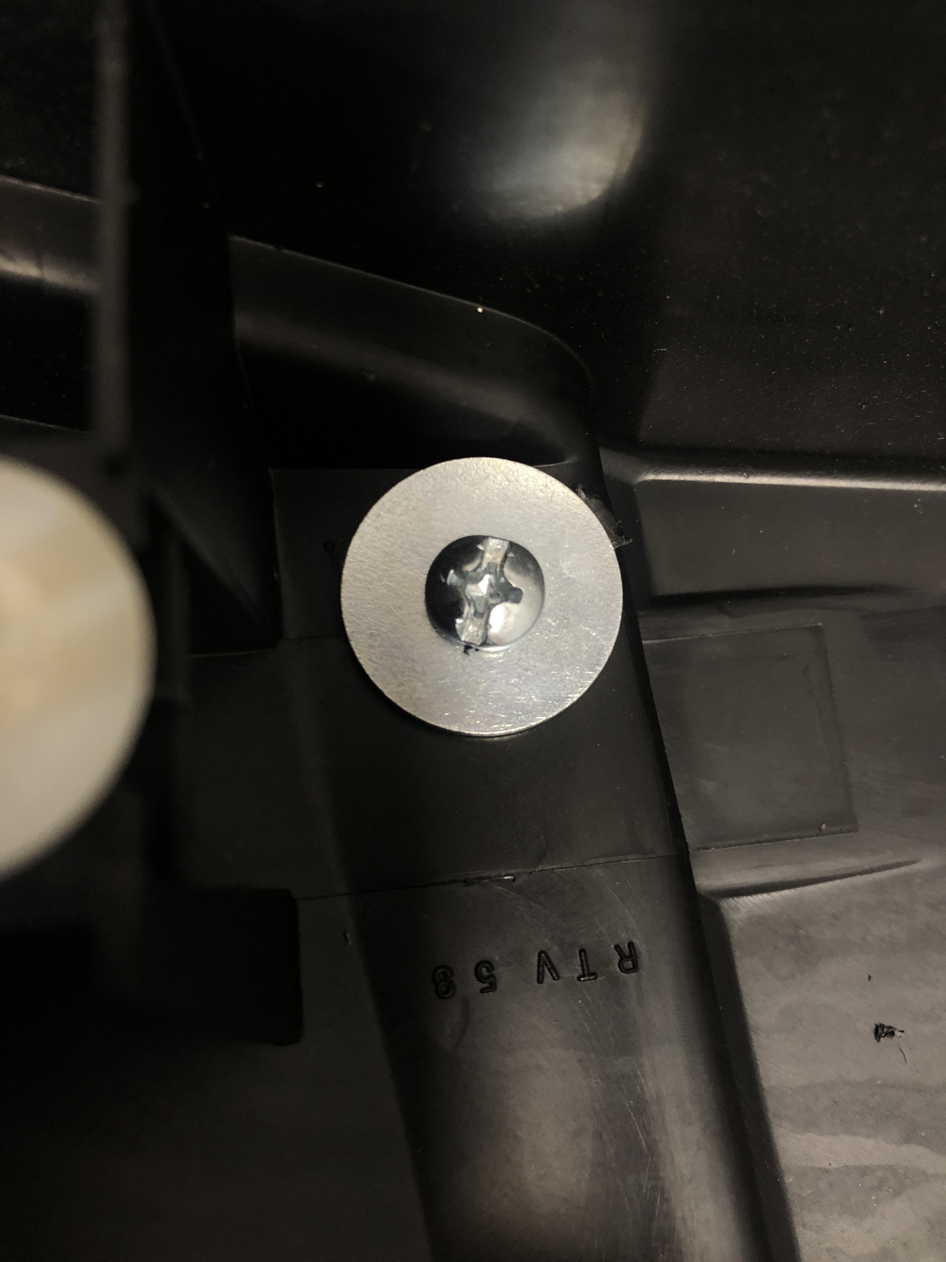

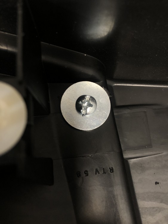

pynacl Posted September 18, 2021 Author Report Share Posted September 18, 2021 Finished drilling out like a million plastic rivet heads and reassembled the inserts into my door cards! Probably not the best solution but I resecured them using short self tappers (3/4”) and fender washers (20mm). Fit and finish is perfect, super jazzed how the swap turned out. Rekpoint, i_love_cars, P_Roloff and 2 others 5 Quote Link to comment Share on other sites More sharing options...

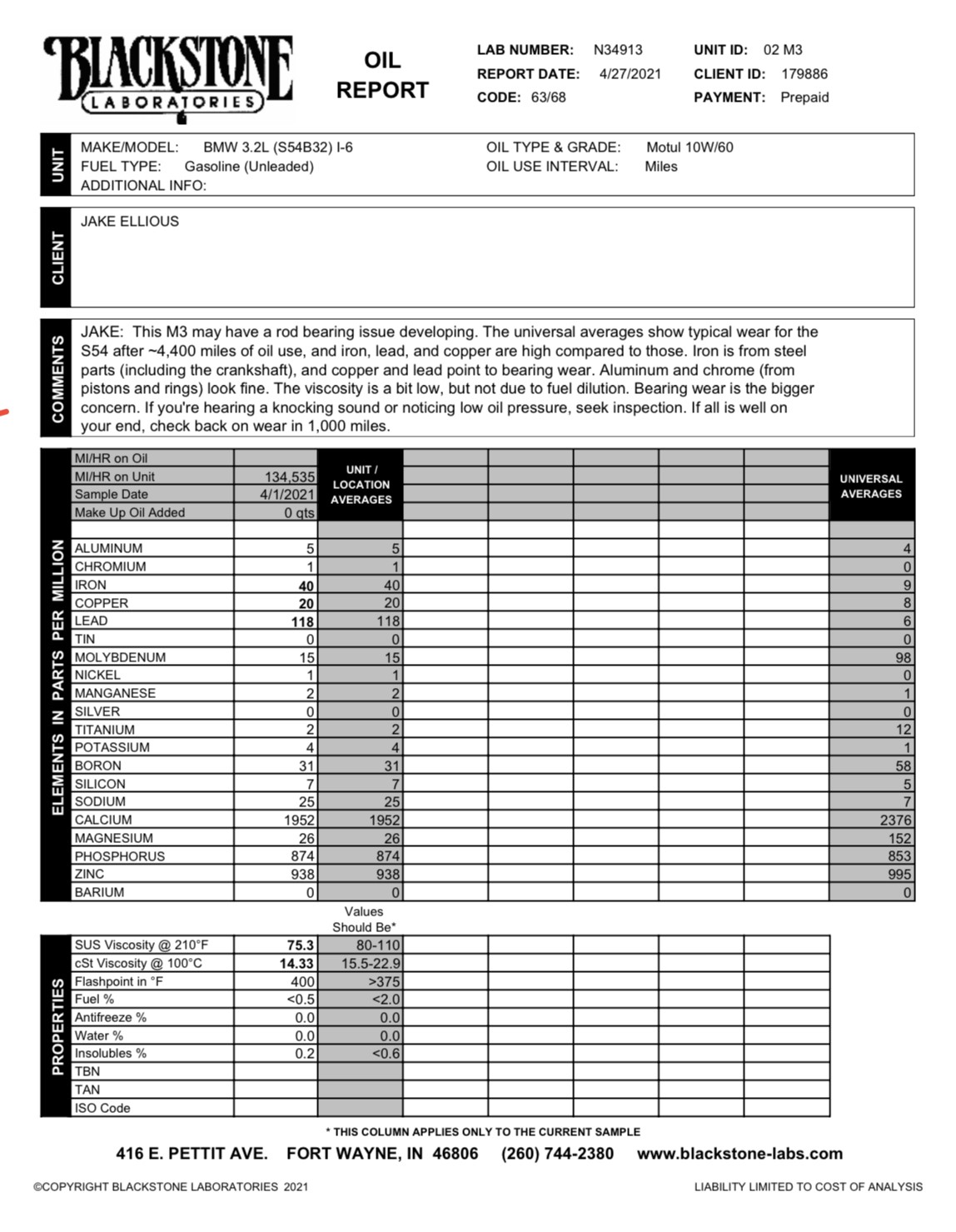

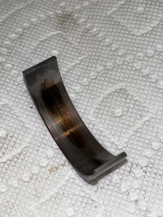

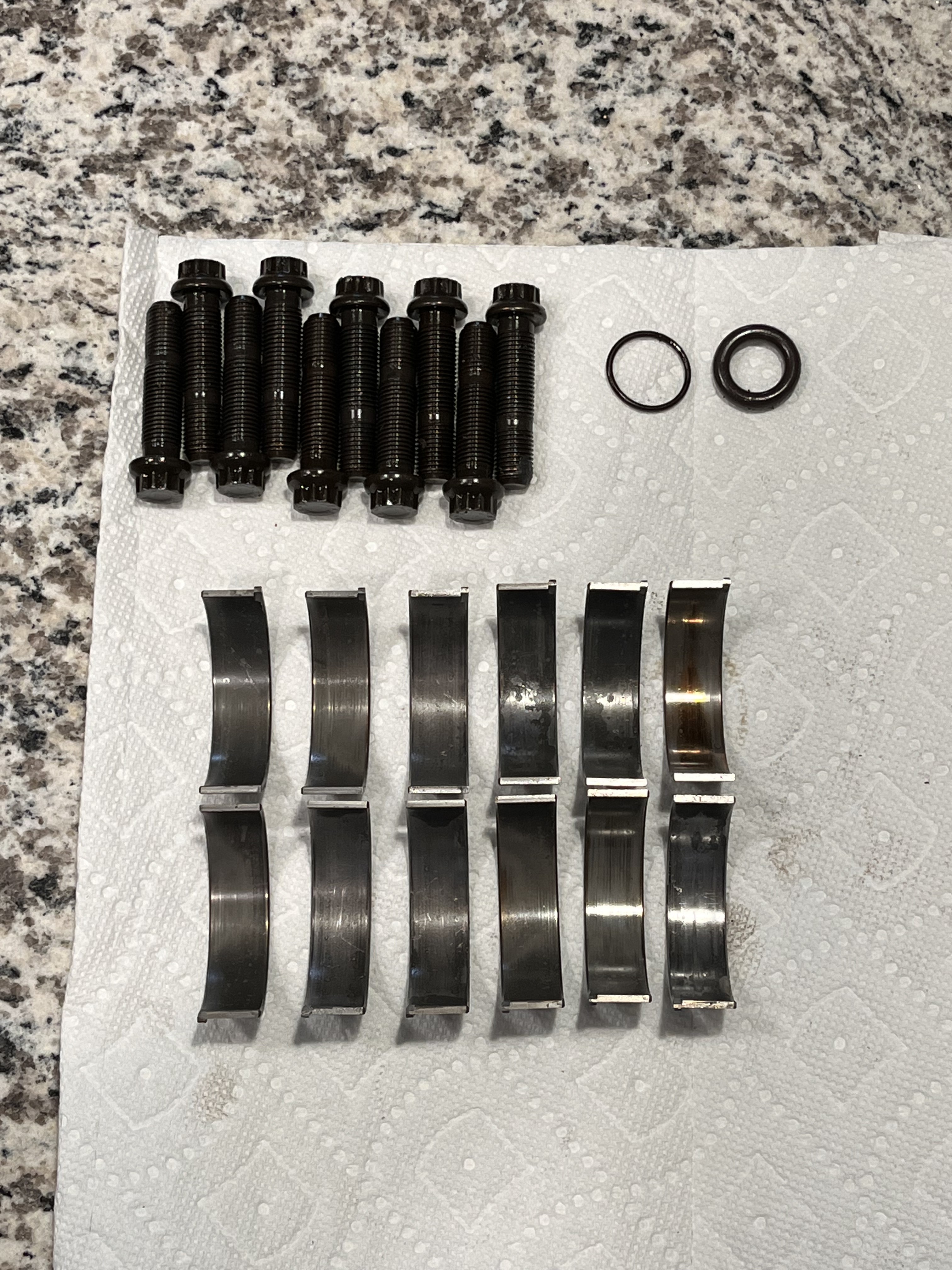

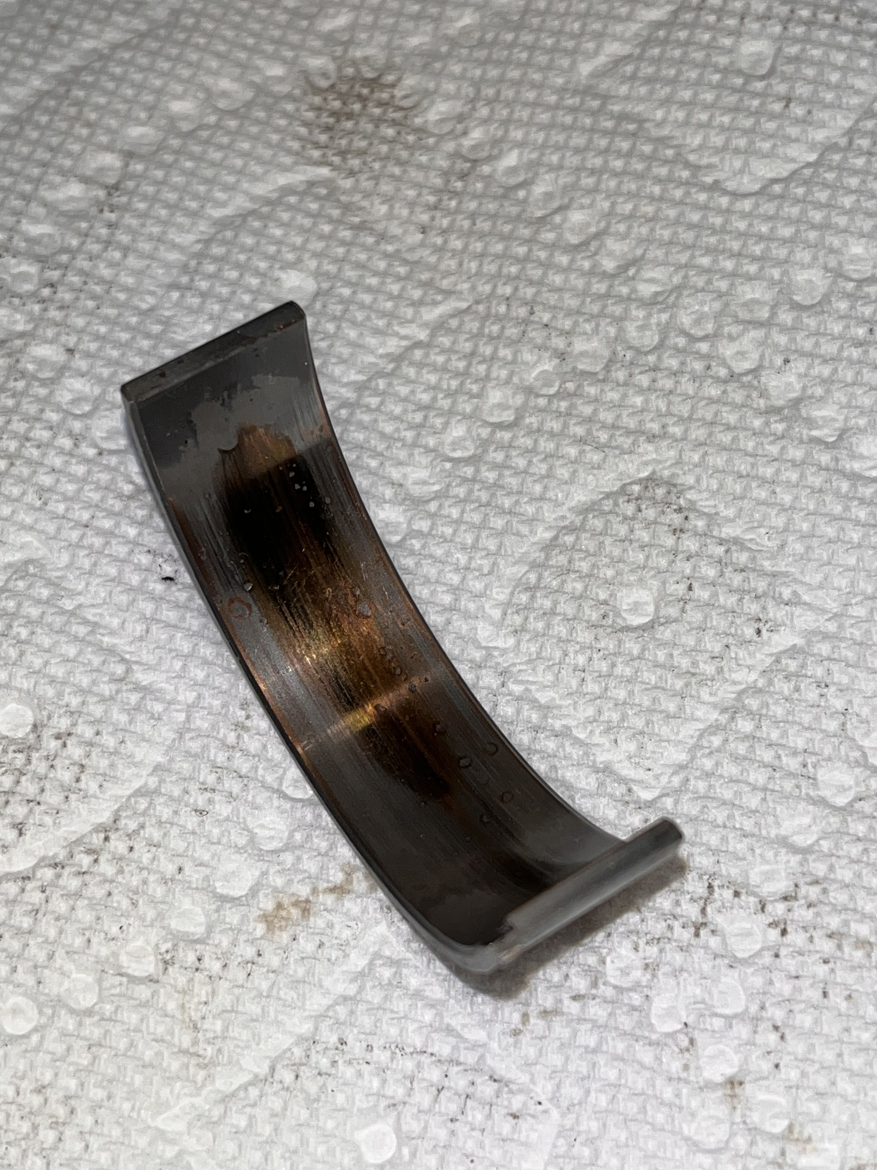

pynacl Posted October 23, 2021 Author Report Share Posted October 23, 2021 Finally sucked it up and committed to getting the rod bearings done. This car had them done as part of the recall way back in ‘06 at 66k miles (car is at 135k now), but black stone tests had me a bit nervous. Once they were pulled they honestly didn’t seem that bad. Seems like cylinder 6 was the main culprit to the test results. Went with WPC treated OE bearings and ARP bolts. Also replaced the oil pan gasket, oil pump seals, motor mounts and a leaking power steering line while it was apart. Rekpoint 1 Quote Link to comment Share on other sites More sharing options...

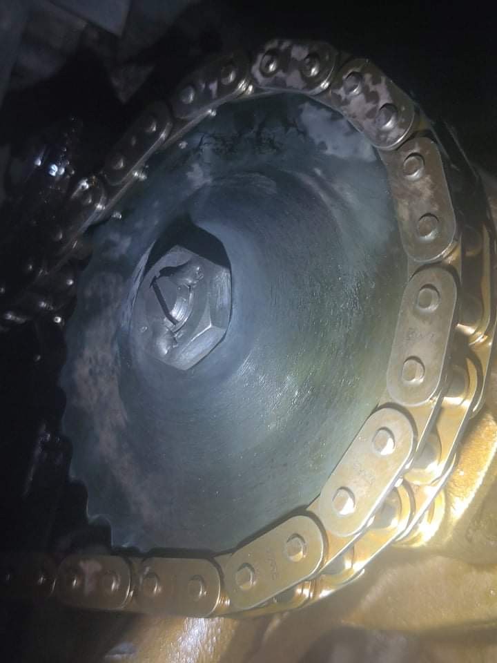

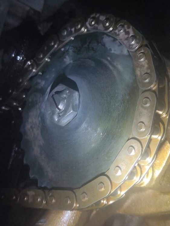

pynacl Posted October 23, 2021 Author Report Share Posted October 23, 2021 Just remembered I also had the oil pump nut tack welded on. Was reading it was rare, but possible for the nut to back off and then boom. I know I should have used a safety wire nut, but since this component will never need to be removed (if I upgrade, I’ll get the VAC kit with sprocket included), I didn’t care as long as it was a permanent fix. Rekpoint 1 Quote Link to comment Share on other sites More sharing options...

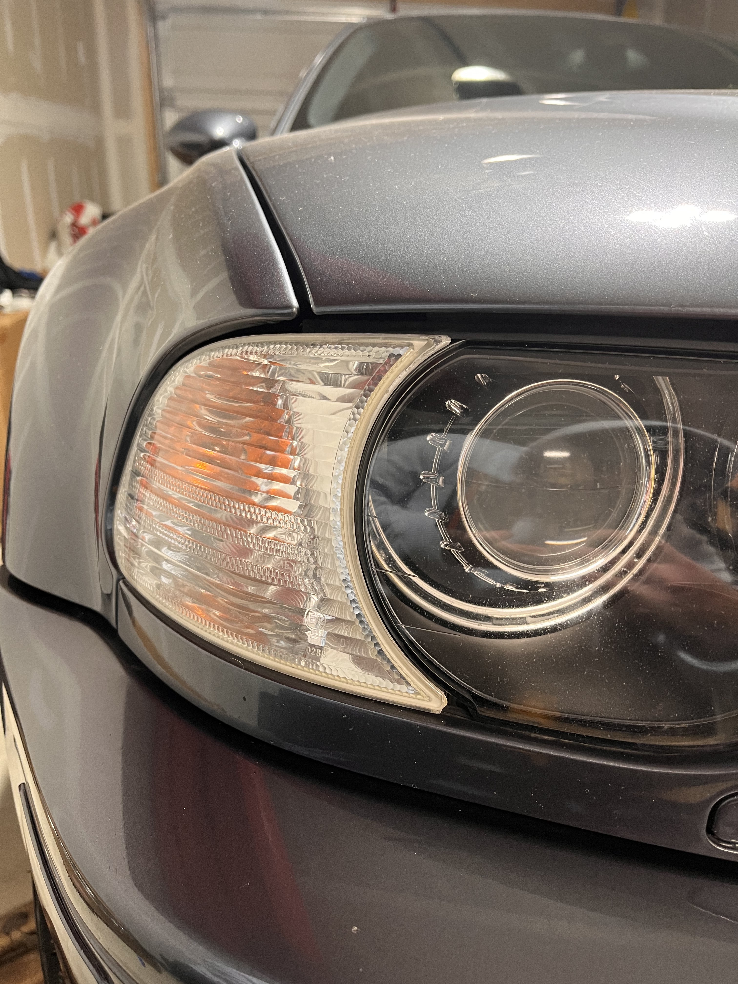

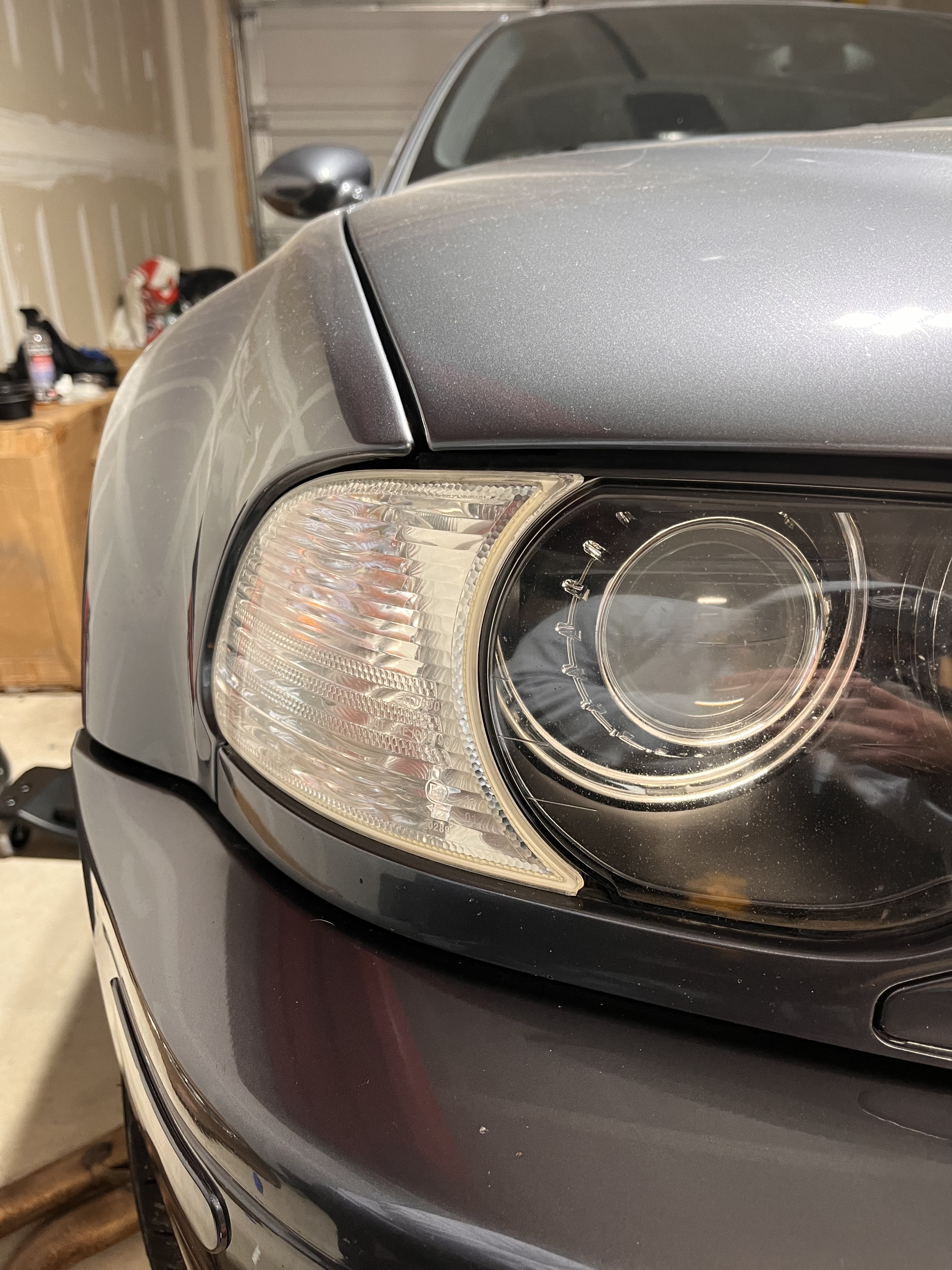

pynacl Posted November 22, 2021 Author Report Share Posted November 22, 2021 Tiny change, but swapped out the indicator bulbs with chrome coated ones. Barely noticeable but I think it’s subtly better looking in the clear housing. Good tip @Rekpoint Rekpoint, Jdesign and patsbimmer1 3 Quote Link to comment Share on other sites More sharing options...
