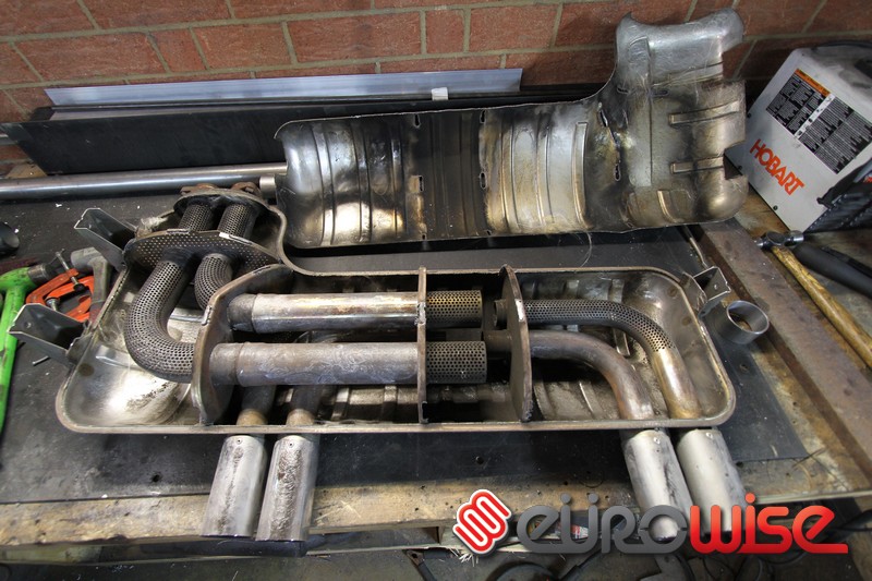

B C Posted April 14, 2021 Report Share Posted April 14, 2021 All videos with really good sounding S54s are deepfakes of an E36 M3 with a pitch adjustment /s It is entirely possible to have a great sounding S54 but I have yet to find a quiet setup that sounds good enough to spend money on. Loud enough to actually hear it while driving but quiet enough to hear the induction sound and not be a nuissance. When you see inside the stock muffler its a bit baffling at how they arrived at such a design. Rekpoint, Jdesign and pynacl 1 2 Quote Link to comment Share on other sites More sharing options...
P_Roloff Posted April 15, 2021 Report Share Posted April 15, 2021 43 minutes ago, B C said: All videos with really good sounding S54s are deepfakes of an E36 M3 with a pitch adjustment /s It is entirely possible to have a great sounding S54 but I have yet to find a quiet setup that sounds good enough to spend money on. Loud enough to actually hear it while driving but quiet enough to hear the induction sound and not be a nuissance. When you see inside the stock muffler its a bit baffling at how they arrived at such a design. Most of the nice sounding ones are running catless headers+resonators with an aftermarket muffler and are just stupid loud. It seems that adding back quieter mufflers just seems to cut the noise but maintain the rasp, which is exactly what I would want to get away from. I wonder if going to quad resonators, x-pipe, catless headers, and a moderately quiet muffler would be the solution? Have any pics of said muffler guts? Rekpoint 1 Quote Link to comment Share on other sites More sharing options...
B C Posted April 15, 2021 Report Share Posted April 15, 2021 27 minutes ago, P_Roloff said: Most of the nice sounding ones are running catless headers+resonators with an aftermarket muffler and are just stupid loud. It seems that adding back quieter mufflers just seems to cut the noise but maintain the rasp, which is exactly what I would want to get away from. I wonder if going to quad resonators, x-pipe, catless headers, and a moderately quiet muffler would be the solution? Have any pics of said muffler guts? note the perforated pipes Interestingly the Z4M seems to have better luck with muffler options that sound good. The stock exhaust sound isnt BAD, it is unique if not just a little bit exotic, but it isnt a sound that gives James May a fizzing sensation. The risk comes with modified exhaust as you can really ruin it, making it worse than stock. @pynacl I wish you godspeed, just not a Godspeed exhaust Rekpoint, pynacl and P_Roloff 3 Quote Link to comment Share on other sites More sharing options...

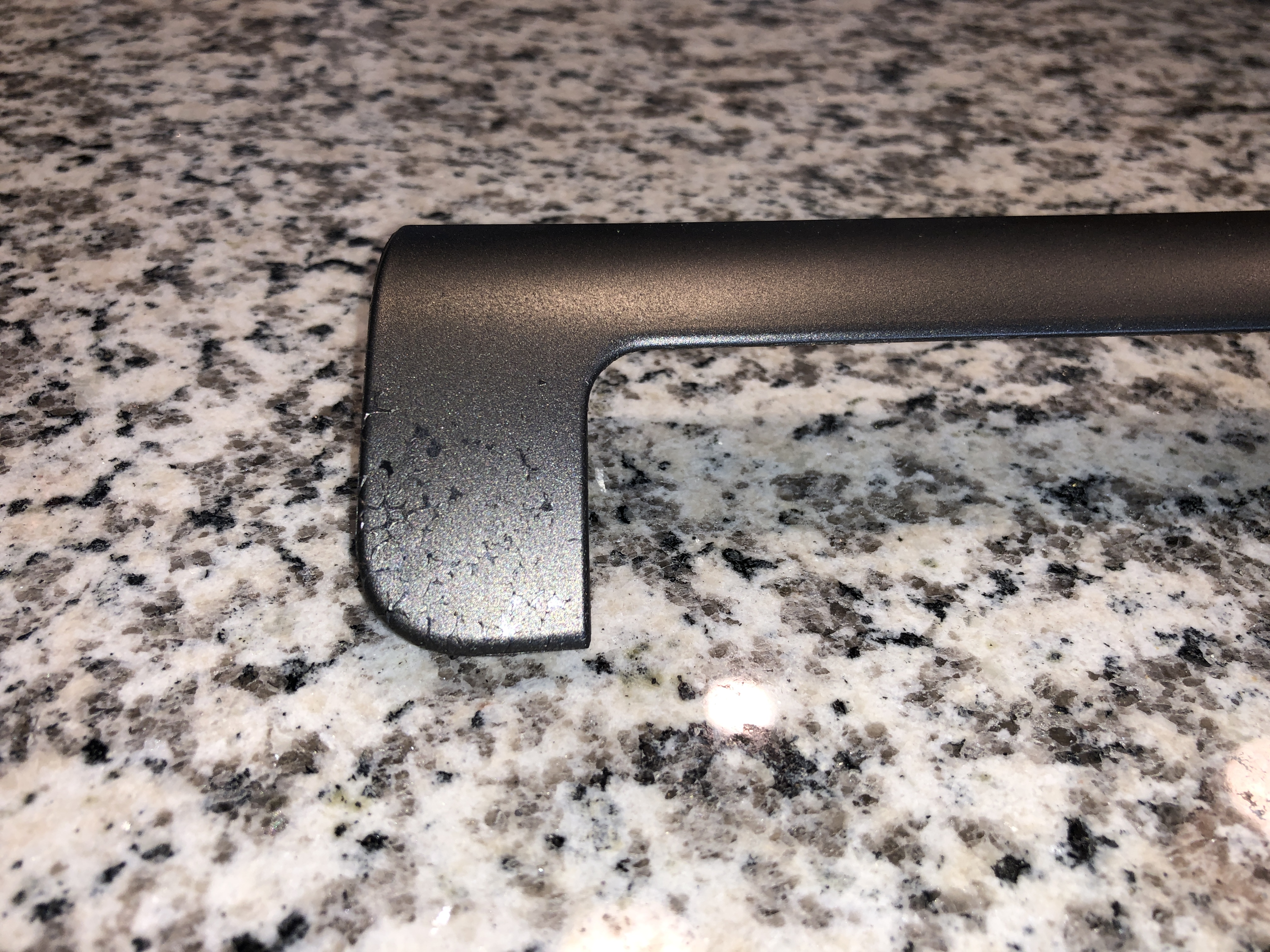

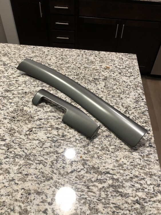

pynacl Posted June 12, 2021 Author Report Share Posted June 12, 2021 Titan trim sucks. Such cheap build quality it shouldn't have even been an option on these cars. Mine was peeling/bubbling on every panel like you see in the photo below. I took all the pieces out, sanded them down with 200/600 grit, then primered and re-painted. Took me two tries because for whatever reason, if you don't use primer, paint has a strange reaction to the bare material and it'll bubble instantly. I ended up using Dupli-color "Storm Gray", which I believe is a GM color. Closest match I could and honestly would be hard to tell the difference. Seems like factory has a bit more warmer hue to it, but even side-by-side it's really close. Also new trim clip pins are $5 a pop!? Edit: I want aluminum trim patsbimmer1, Rekpoint, KaiserRolls and 2 others 5 Quote Link to comment Share on other sites More sharing options...

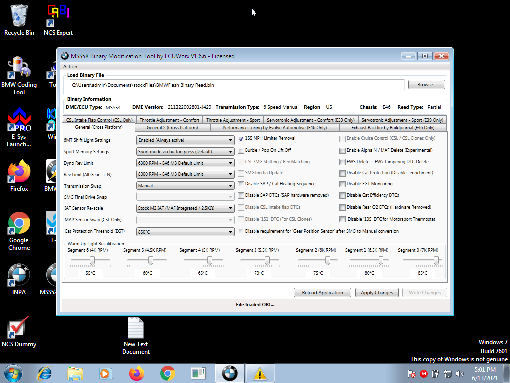

pynacl Posted June 14, 2021 Author Report Share Posted June 14, 2021 Took @B C advice and downloaded ECUWorx and modified my M3 a bit this afternoon. Most notably disabled top speed limiter, enabled shift lights (flashes all segments at 7.5k RPM) and re-calibrated the warmup light sequence to more reasonable temps that doesn't promote WOT at 140F on those poor RBs. Below is a before / after on what I changed. I wrote up a blog post on how to use the software step by step here if anyone is interested: https://www.pynacl.com/blog/tune-your-e46-m3-yourself. Thanks Brian for your work in discovering and learning to use this software! Stock: Final: patsbimmer1 1 Quote Link to comment Share on other sites More sharing options...

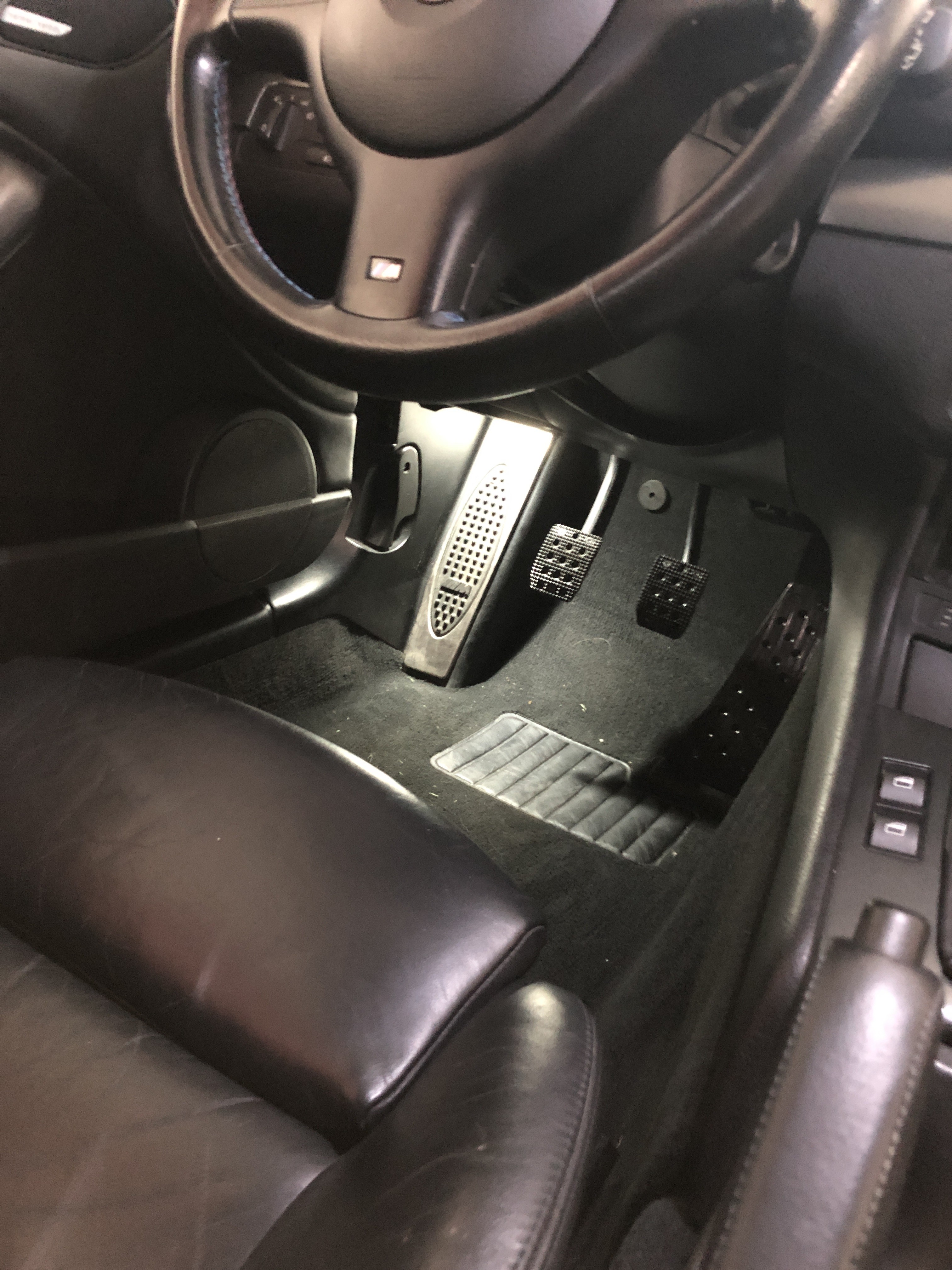

pynacl Posted July 26, 2021 Author Report Share Posted July 26, 2021 Was trying to get an ECS order high enough to get free shipping, so decided to scoop an LED interior kit. Figured this would be a tasteful upgrade in the lighting department Rekpoint and patsbimmer1 2 Quote Link to comment Share on other sites More sharing options...
