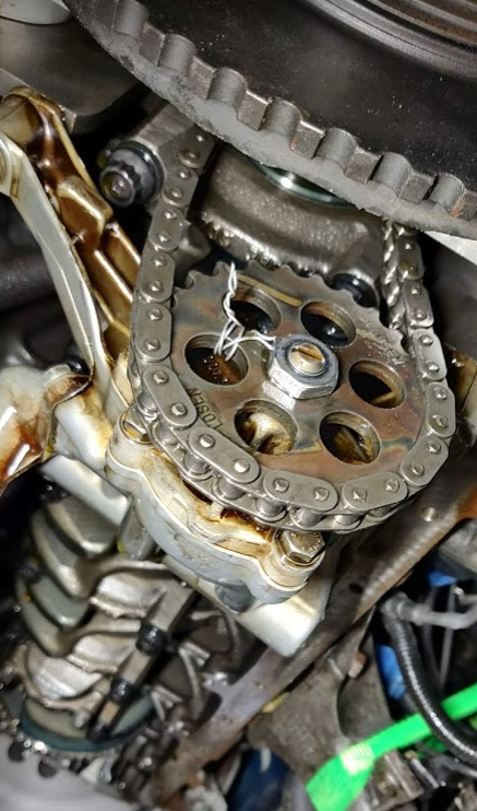

GunMetalGrey Posted June 7, 2021 Author Report Share Posted June 7, 2021 I've been chasing down a tick from the rear of this engine for a bit now, and had some findings yesterday. The previous work I've done was removing the cams and opening and cleaning all the lifters, which didn't change anything. I then replaced lifters on cylinder 5 and 6, which did not change the noise. I tried heavier oil which helped reduce the noise a bit, but then was loud again, thin oil made it much worse. I am seeing metal in the oil so it was time to pull the pan and see what bearing I was losing. The piece upper right was from something else, but this is what was coming out of the back corner of the oil pan as I was pulling it. I found the oil pump chain to be very slack, but intact. I can't leave the chain that loose so I'll be pulling the engine seeing as I'm opening up a larger can of worms here than intended. I have not seen any glaring signs of bearing failure which is good (no discolored caps) but I have yet to pull any caps. That'll wait until the engine is on a stand. Fun with engines! Quote Link to comment Share on other sites More sharing options...

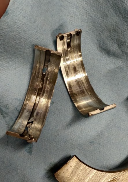

GunMetalGrey Posted June 8, 2021 Author Report Share Posted June 8, 2021 Bearings from rear most main cap, that'll do it. Crank looks fine, bearings didn't spin. Will be taking the crank out and redoing all the bearings and verifying clearance along with replacing the oil pump chain. P_Roloff 1 Quote Link to comment Share on other sites More sharing options...
