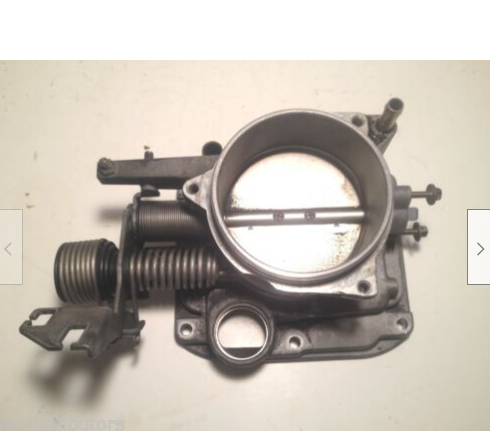

YoungCR Posted February 26, 2021 Report Share Posted February 26, 2021 3 hours ago, GunMetalGrey said: Anyone want an M60 throttle body? haha Possibly? Send me the part number Ben plz Jdesign, B C and SteelBlue 3 Quote Link to comment Share on other sites More sharing options...
GunMetalGrey Posted February 26, 2021 Author Report Share Posted February 26, 2021 15 hours ago, YoungCR said: Possibly? Send me the part number Ben plz Identical pic from the bay of e1742010 is what is on the throttle boy. Ben Plz'd B C 1 Quote Link to comment Share on other sites More sharing options...
