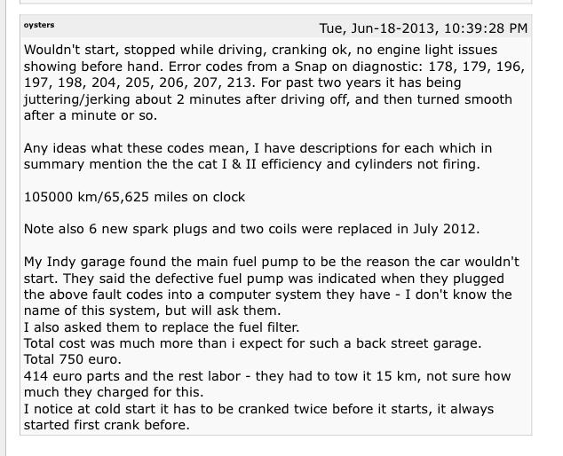

B C Posted July 3, 2019 Author Report Share Posted July 3, 2019 patsbimmer1, P_Roloff, Rekpoint and 2 others 5 Quote Link to comment Share on other sites More sharing options...
