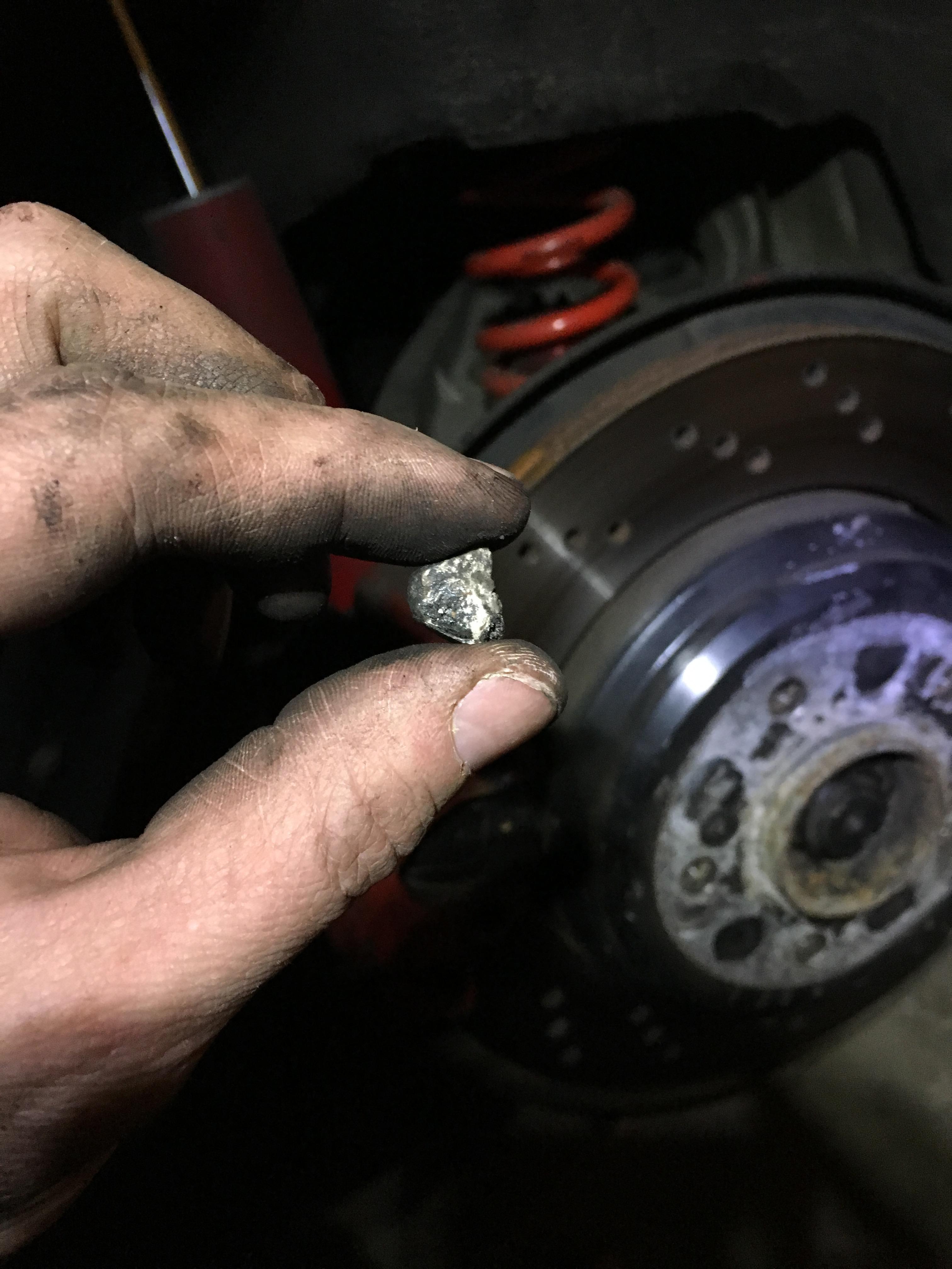

B C Posted April 26, 2019 Author Report Share Posted April 26, 2019 I have logged about 400 miles on the car since taking ownership. Today I made a home depot run and transported a 2x4 in it and made use of the fold down rear seats. on my way home from work though it developed a brake squeal. As it turns out the caliper caught a rock. While I was under the car I checked for loose hardware, tightened up a heat shield screw that contributed to some rattling and became acquainted with the underside of the car. I match-marked the bolt heads with a sharpie for quick checking of loose fasteners in the future. @andyhundley gave some really good advice about the potential rabbit hole one can go down on with all the preventative fixes that you can do on these cars/anxieties you can generate by browsing BMW forums: ”get off the forums and just drive it” Jdesign and patsbimmer1 2 Quote Link to comment Share on other sites More sharing options...

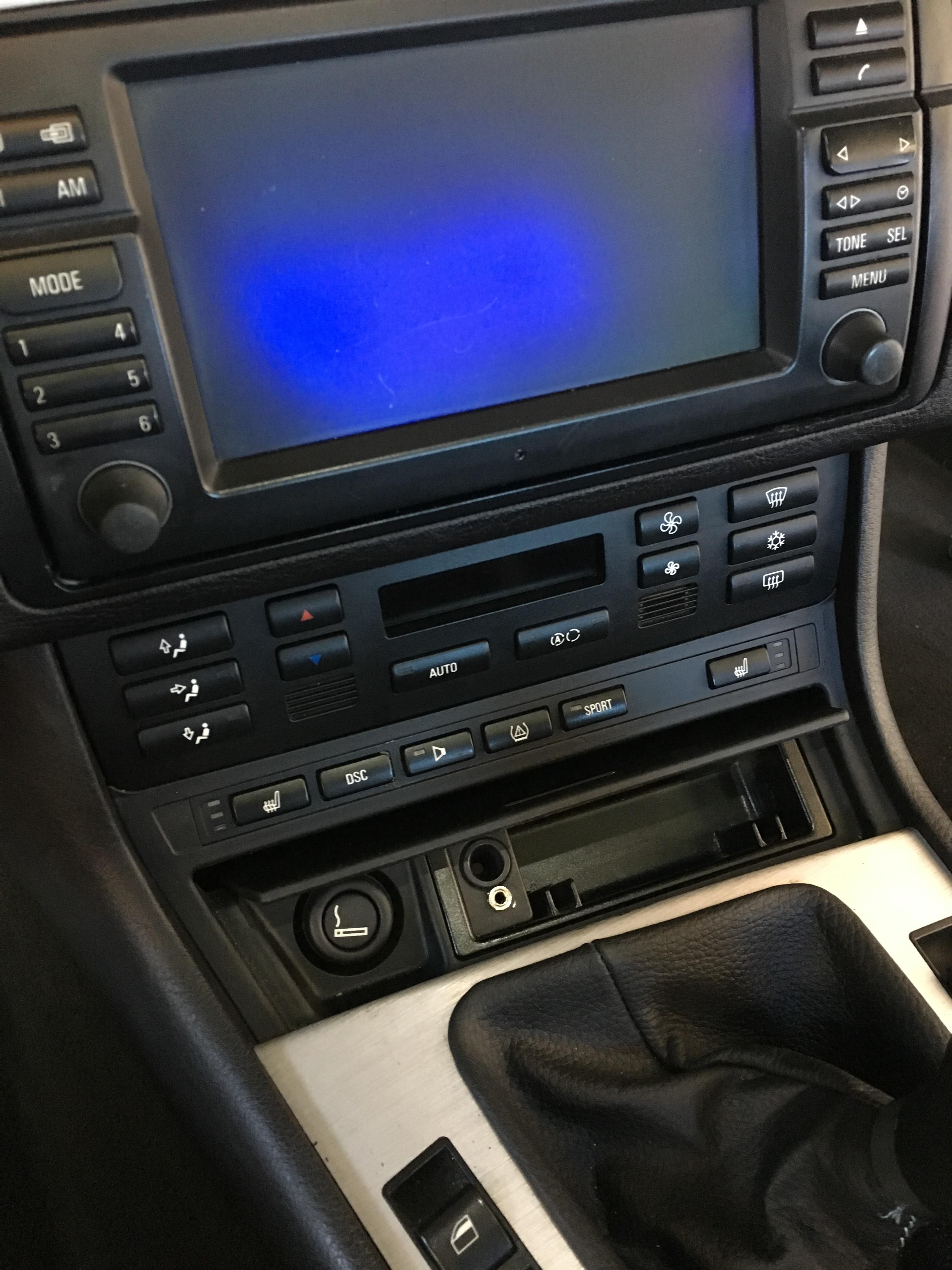

B C Posted April 26, 2019 Author Report Share Posted April 26, 2019 Installed the factory aux input cord and mounted it to the ashtray. Normally it geta mounted inside the glovebox. (Silver female headphone input) P_Roloff and m42b32 2 Quote Link to comment Share on other sites More sharing options...
YoungCR Posted April 27, 2019 Report Share Posted April 27, 2019 20 hours ago, B C said: Installed the factory aux input cord and mounted it to the vape juice tray. Normally it geta mounted inside the glovebox. (Silver female headphone input) fixed Quote Link to comment Share on other sites More sharing options...

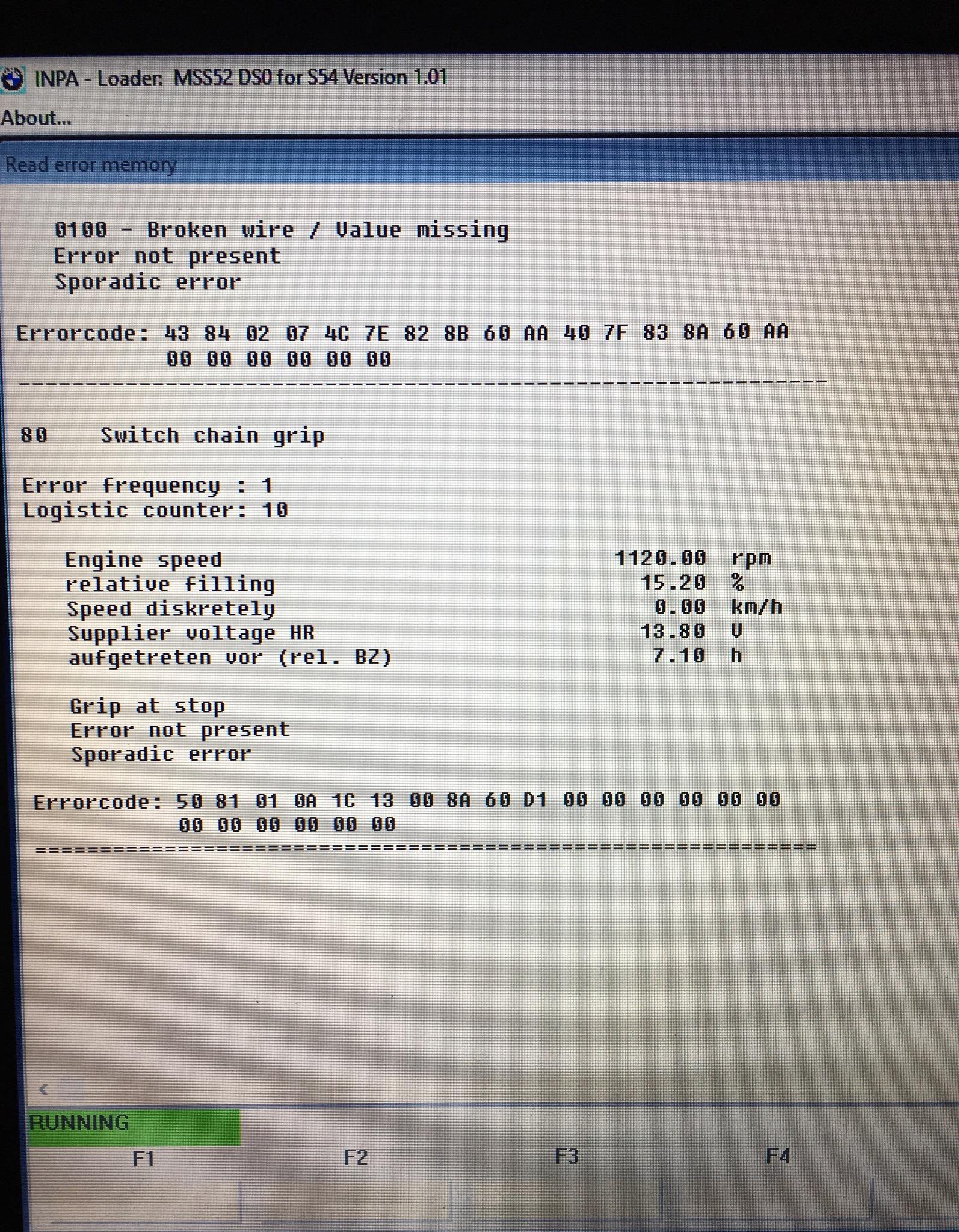

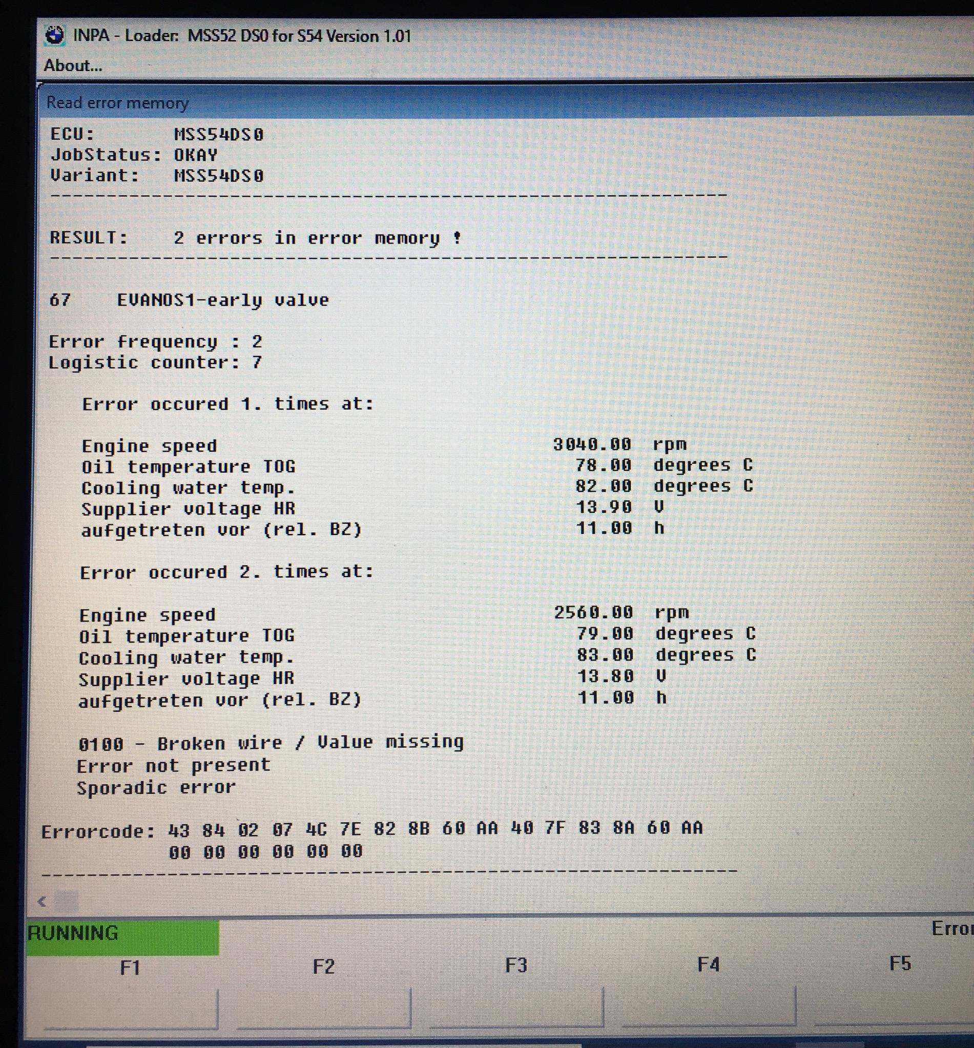

B C Posted April 30, 2019 Author Report Share Posted April 30, 2019 I got INPA working and waterboarded my DME, demanding that it spill the beans on everything it has seen. I got a code 80 and 67 Everything runs and drives phenomenally, save for an ever so slightly fluctuating cold idle. So I will clear these codes and see if they come back. No these codes do not generate a CEL. If they come back I will test out the VANOS solenoid and clutch switch to see if there is anything worth improving over winter. It is just nice to know I now have a little bit better diagnostic capability than a basic scanner if I ever need it. A very good list of codes can be found here http://www.chitownm.com/forums/showthread.php?p=61655 EDIT: link fixed m42b32, patsbimmer1, P_Roloff and 1 other 4 Quote Link to comment Share on other sites More sharing options...
