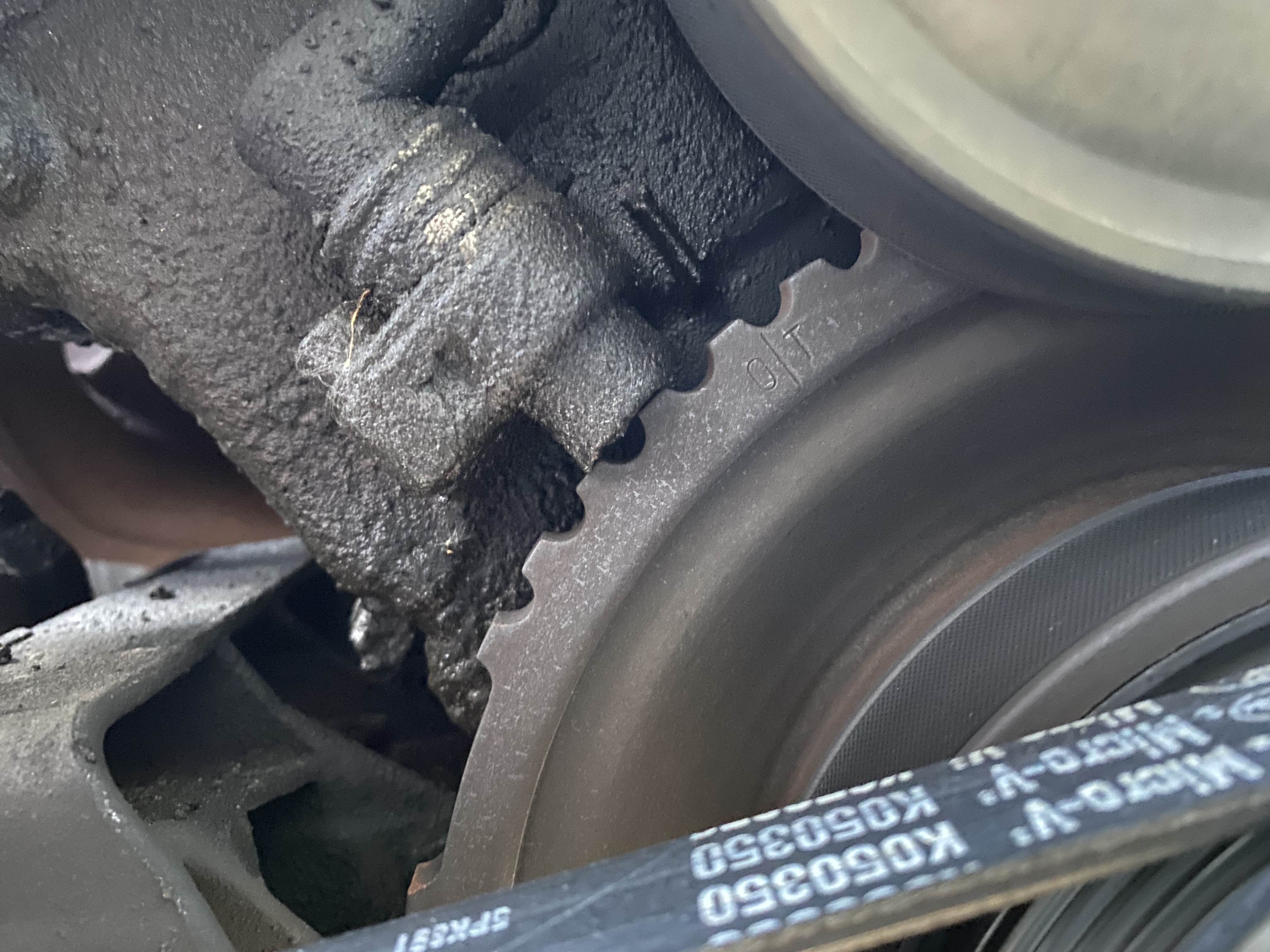

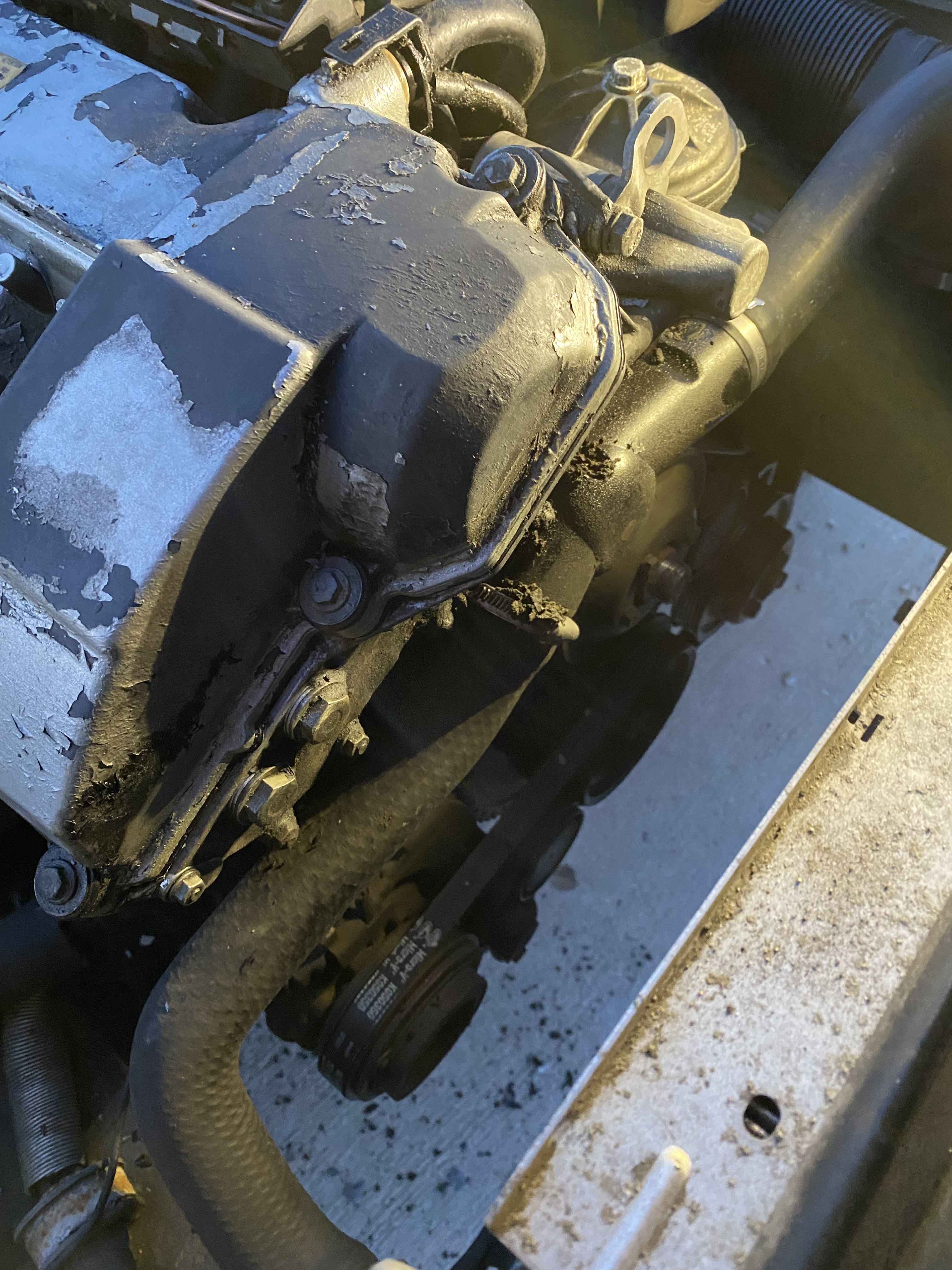

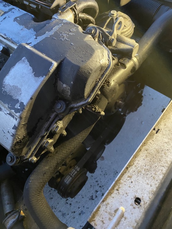

P_Roloff Posted April 6, 2023 Author Report Share Posted April 6, 2023 Car had a mystery fluid underneath it the other day, but the slick is now gone. Thinking brake fluid since it seemed to disappear after the rain. Brakes are still strong, so I’m guessing it’s clutch hydraulics. The clutch disengagement/shift feel has slowly been getting worse and I wonder if I have a slow leak at the slave or something. Could also be leakage from the trans itself, the output needs to be replaced but was not leaking enough to visibly drip on last inspection. Either way, I’ll get it up on ramps and check it out. Going to take care of the wiper linkage bushings, vacuum leak test, and maybe the VANOS seal/VCG while it’s laid up. Sunroof seal or drain line is leaking now too so that’ll be addressed as well. Quote Link to comment Share on other sites More sharing options...

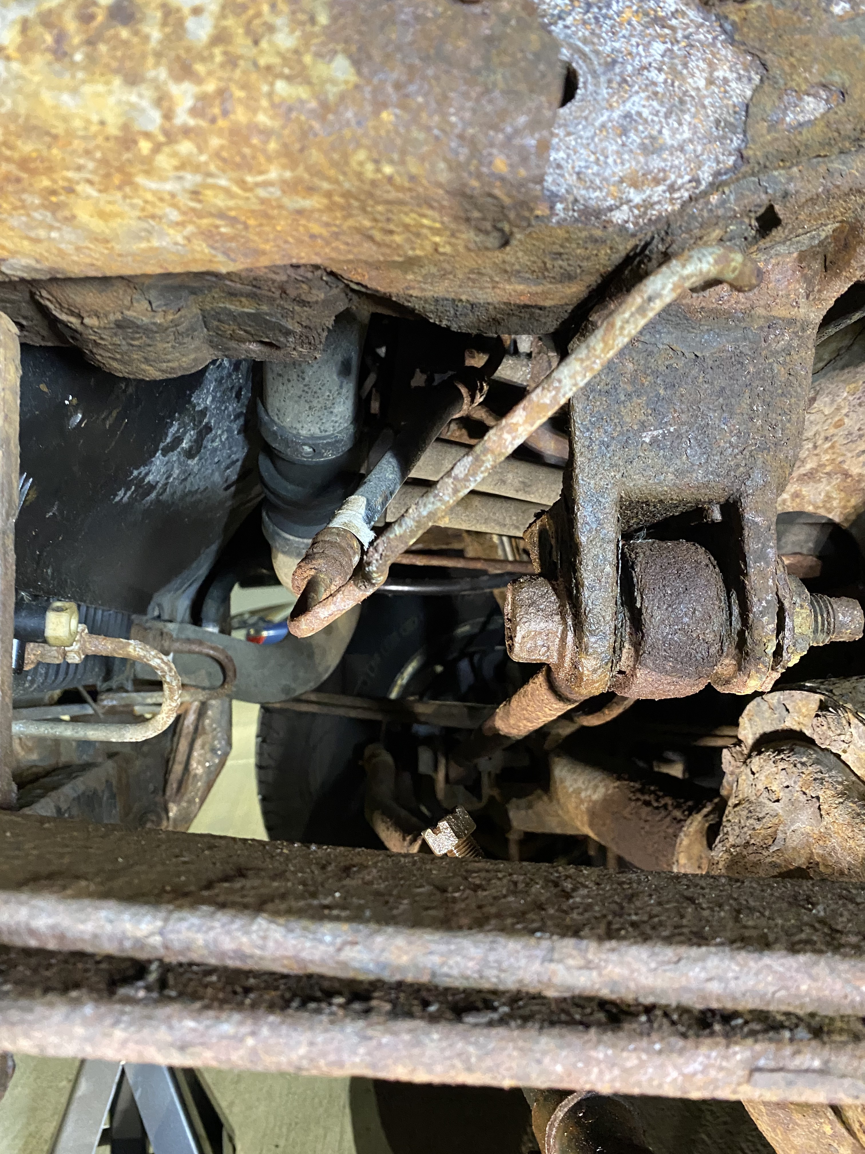

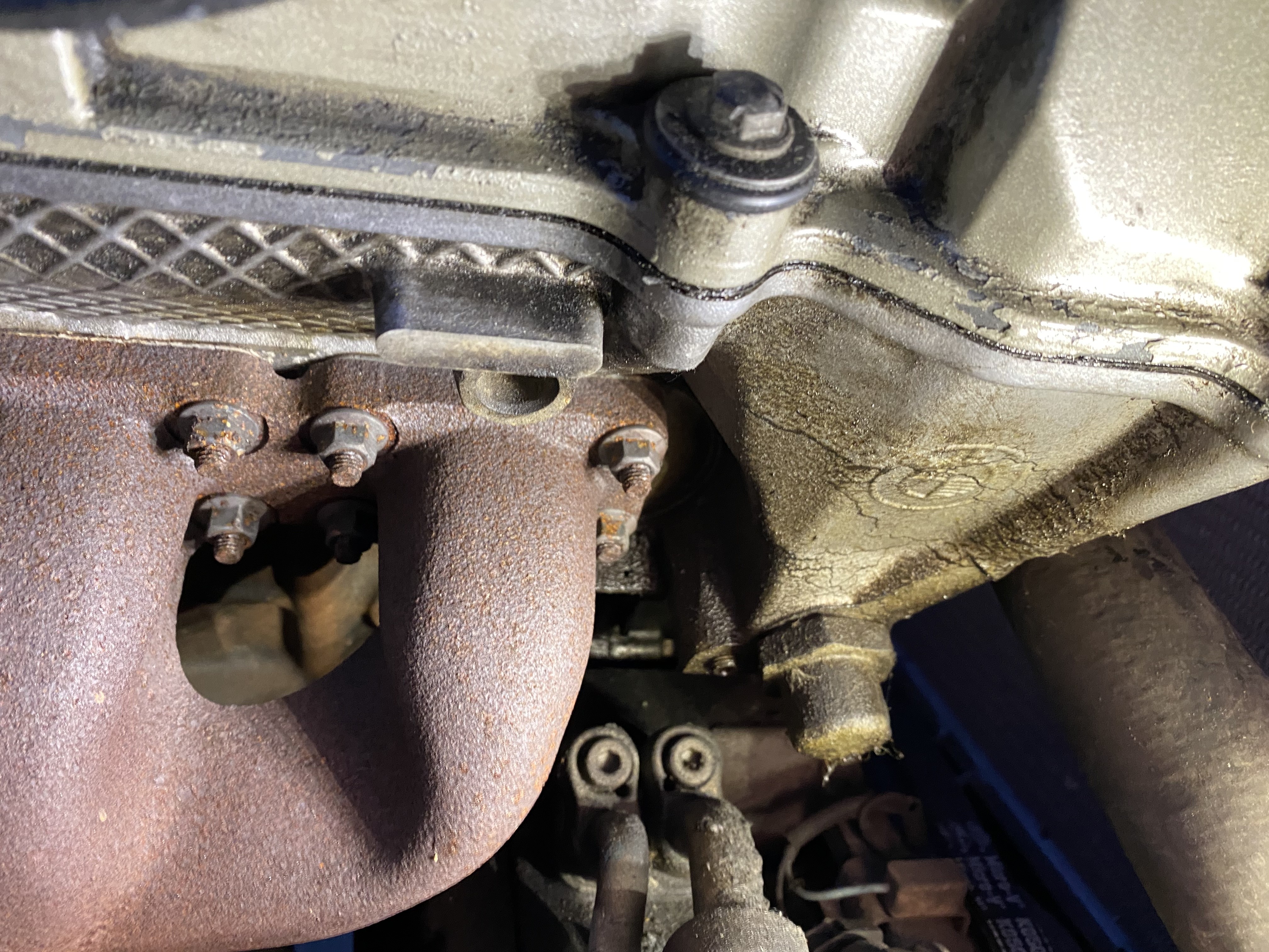

P_Roloff Posted April 28, 2023 Author Report Share Posted April 28, 2023 Got underneath and found the transmission output seal(s) were toast (or so I thought). Fresh fluid was covering everything pretty heavily and had leaked enough that it made its way to the front of the trans tunnel from the spray and seepage. Trans was only down a quarter quart or so, so not thinking it did any damage but definitely had lost measureabke fluid amounts. New output seal went on pretty easy, and found when pulling it that the output nut was finger tight. No bueno. Output flange came off with only a mild yank. I’m guessing most of the leakage was from that, but decided to do the seals anyways while I was there. I drove a new shift shaft seal over the old one (nearly impossible to pull the old one out without the transmission out of the car) and was not able to get it fully seated but it only protrudes slightly and would be pretty easy to pull to replace if needed now. It’s now double sealed so should be OK. Fixed the windshield wiper rattle too! Turns out the bushings were fine; the rubber grommet between the linkage and body had deteriorated and was letting it knock around. Tightened the nut after removing the old grommet and the issue is gone. Finally getting to the VCG and VANOS job as well. Wasn’t able to get the flywheel lock pin through the block hole after an hour of trying, so I used the wheel hanger pin from the factory toolkit to make sure the hole is right where it needs to be and double checked off the crank hub timing marks. The cam lock blocks will also be used so I think I’ll be fine. I’m certainly not the only one to do it like this, anyon with a LTW flywheel doesn’t even have the alignment hole so they have to do it this way. Got the VC off without issue, and in the process realized the oil leakage was far worse than I thought. I knew about the oil in the spark plug holes, but the rest of it was a bit excessive. I’ll clean up the VC when it’s off and the block a little more once all the new stuff is back on so I don’t get crud in the engine. Looks pretty clean in there overall! Not bad for 130k and nearly 30 years. A bit odd that the rear cylinder cam lobes look darker, but nothing is grooved or scored at all so I’m not worried about it. The original M20 cam was far worse when I replaced that and it still was fine. Going to pull the VANOS unit next week, rebuild with seals and an anti rattle kit as a preventative measure, and toss it all back in. This car is finally coming back together and getting some much needed love! KaiserRolls and Jdesign 2 Quote Link to comment Share on other sites More sharing options...

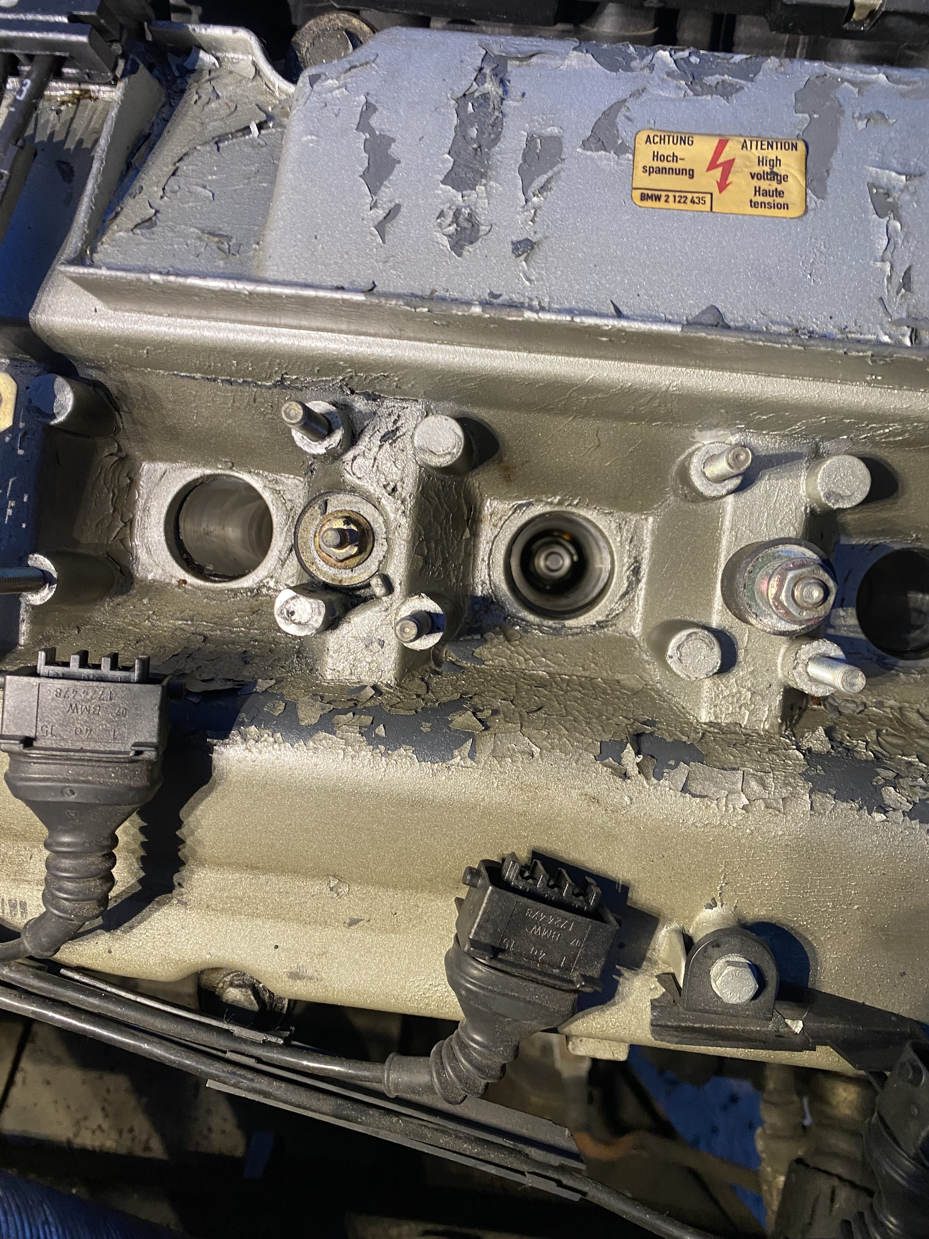

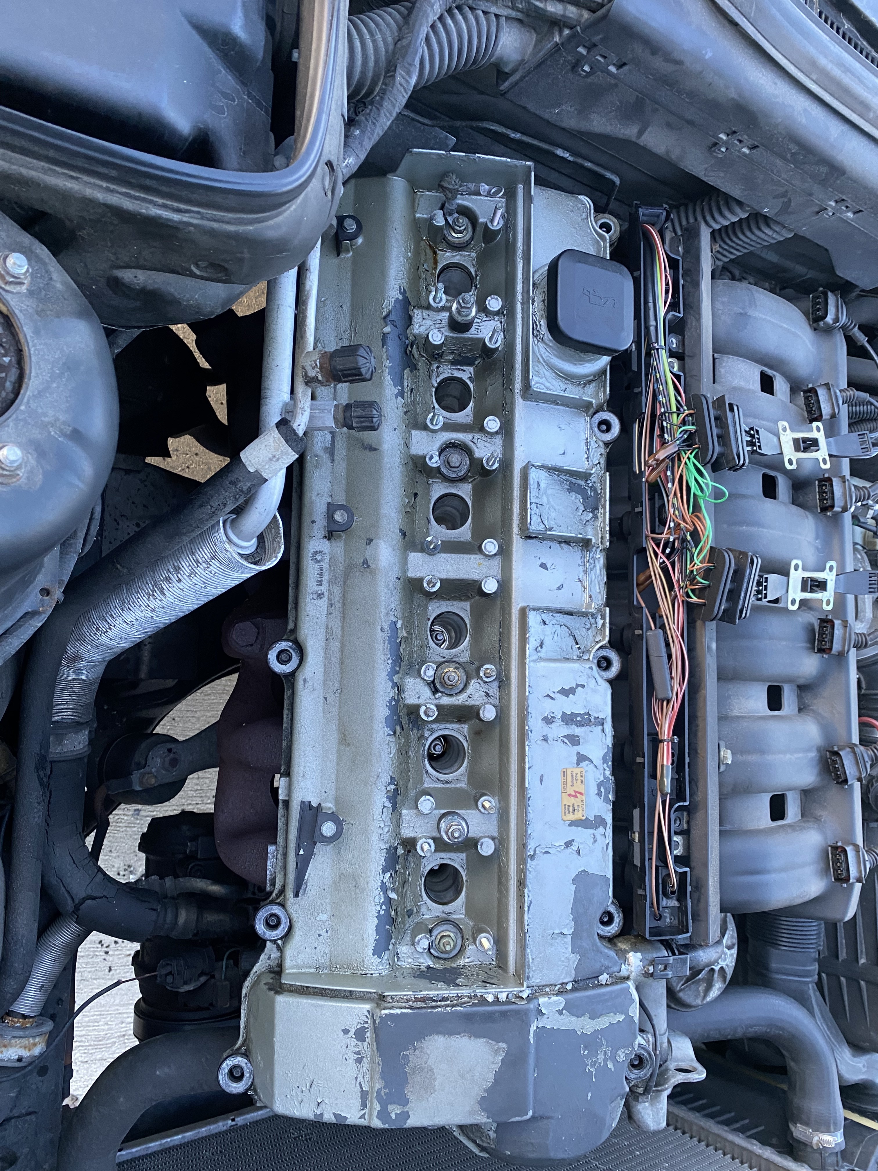

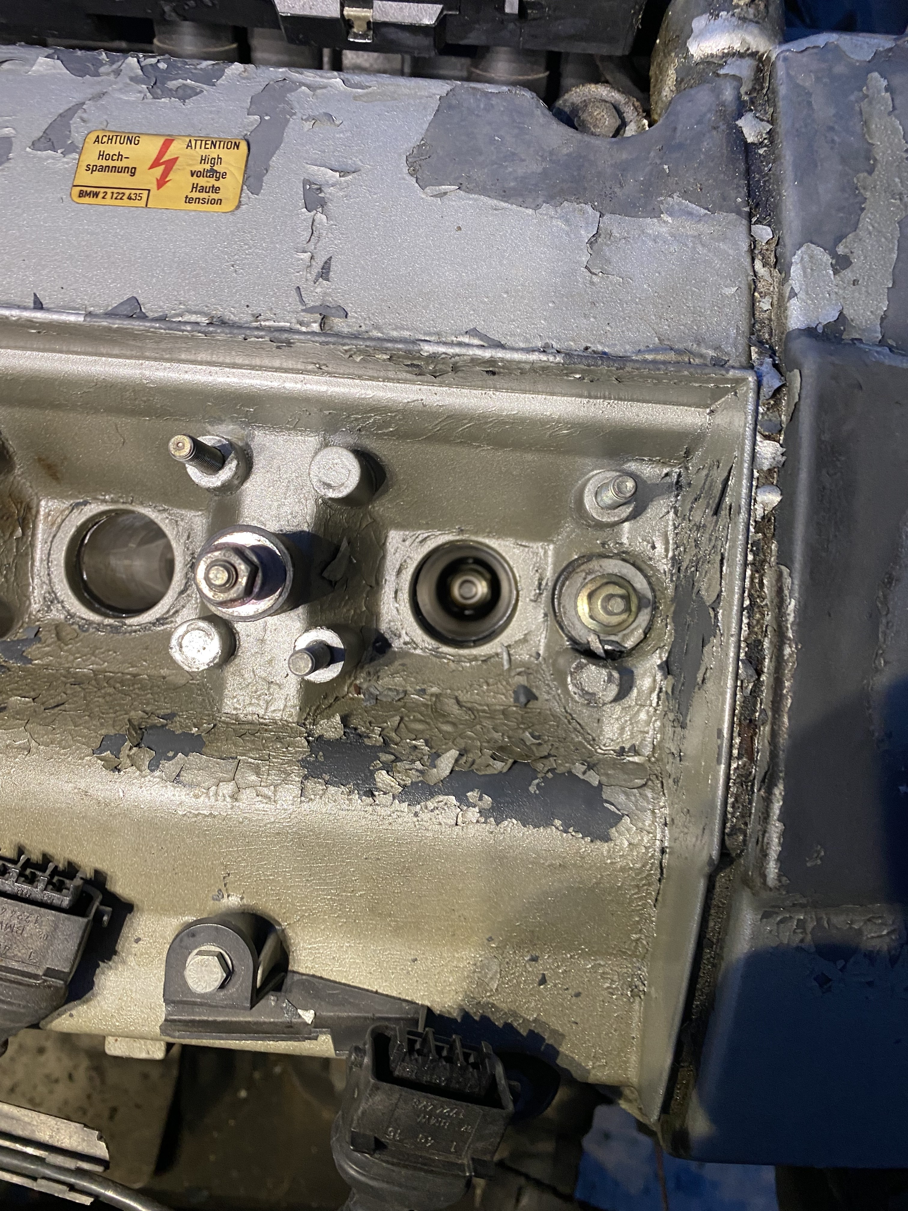

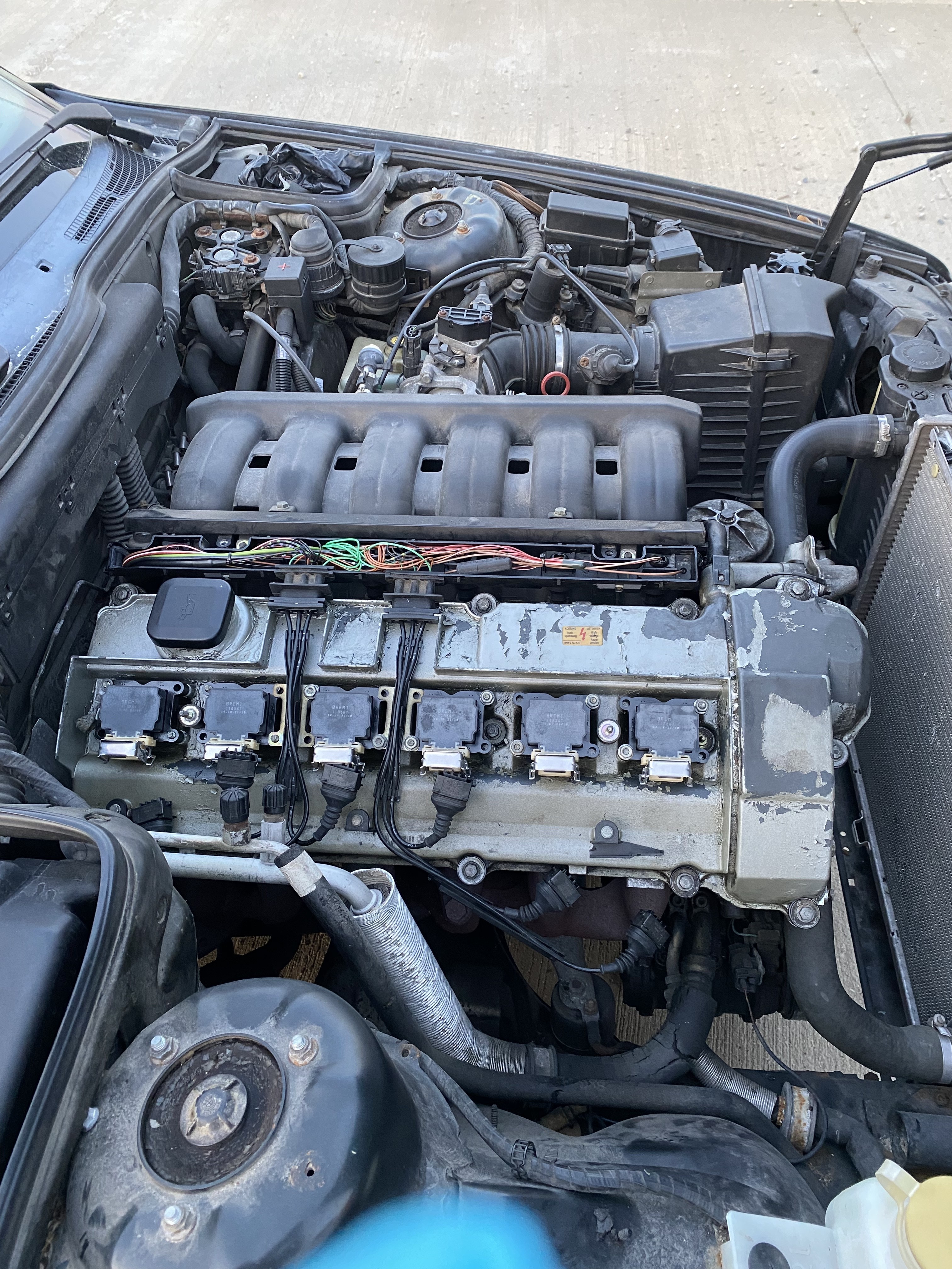

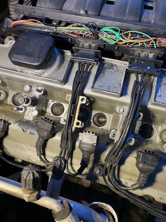

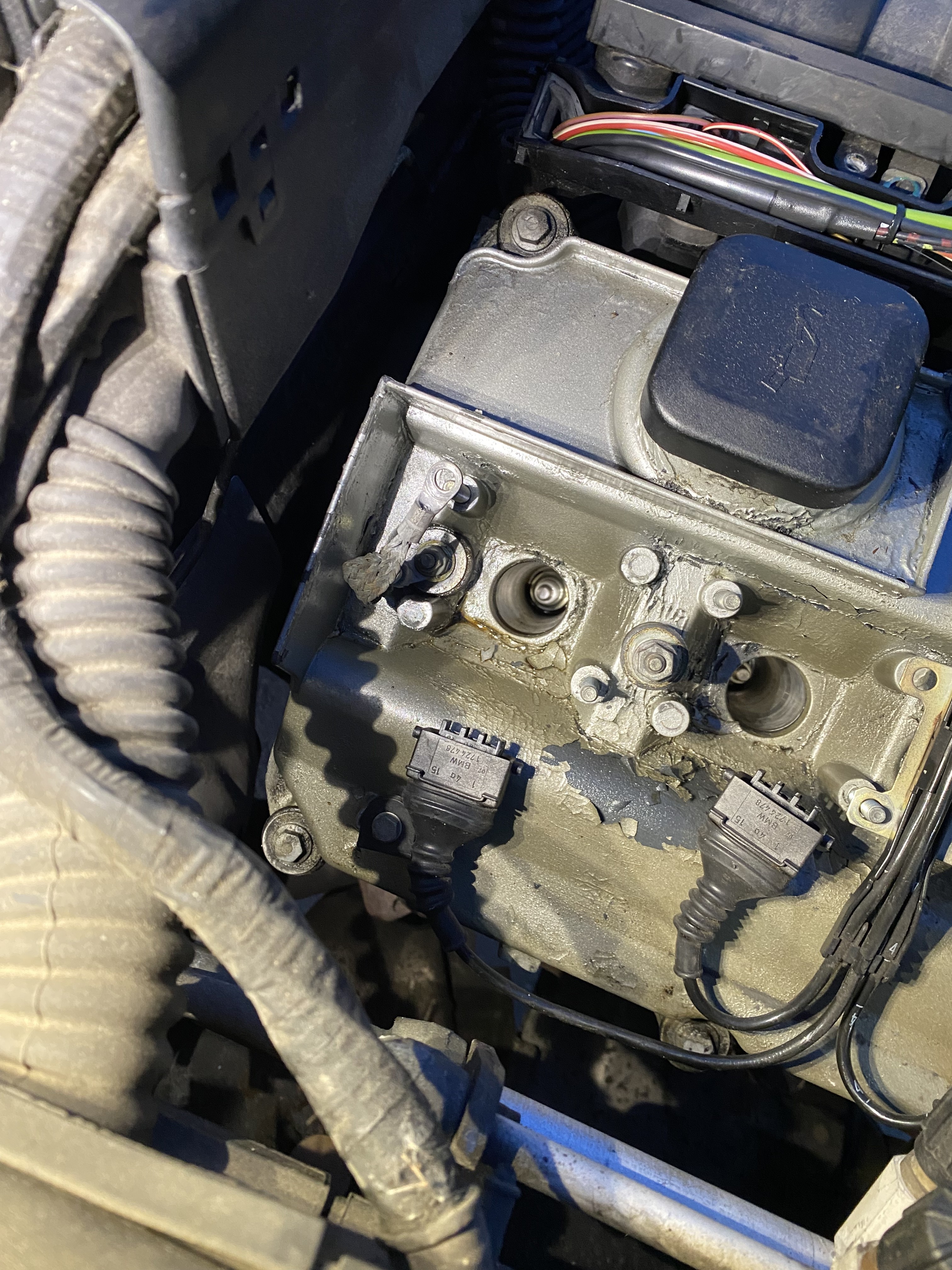

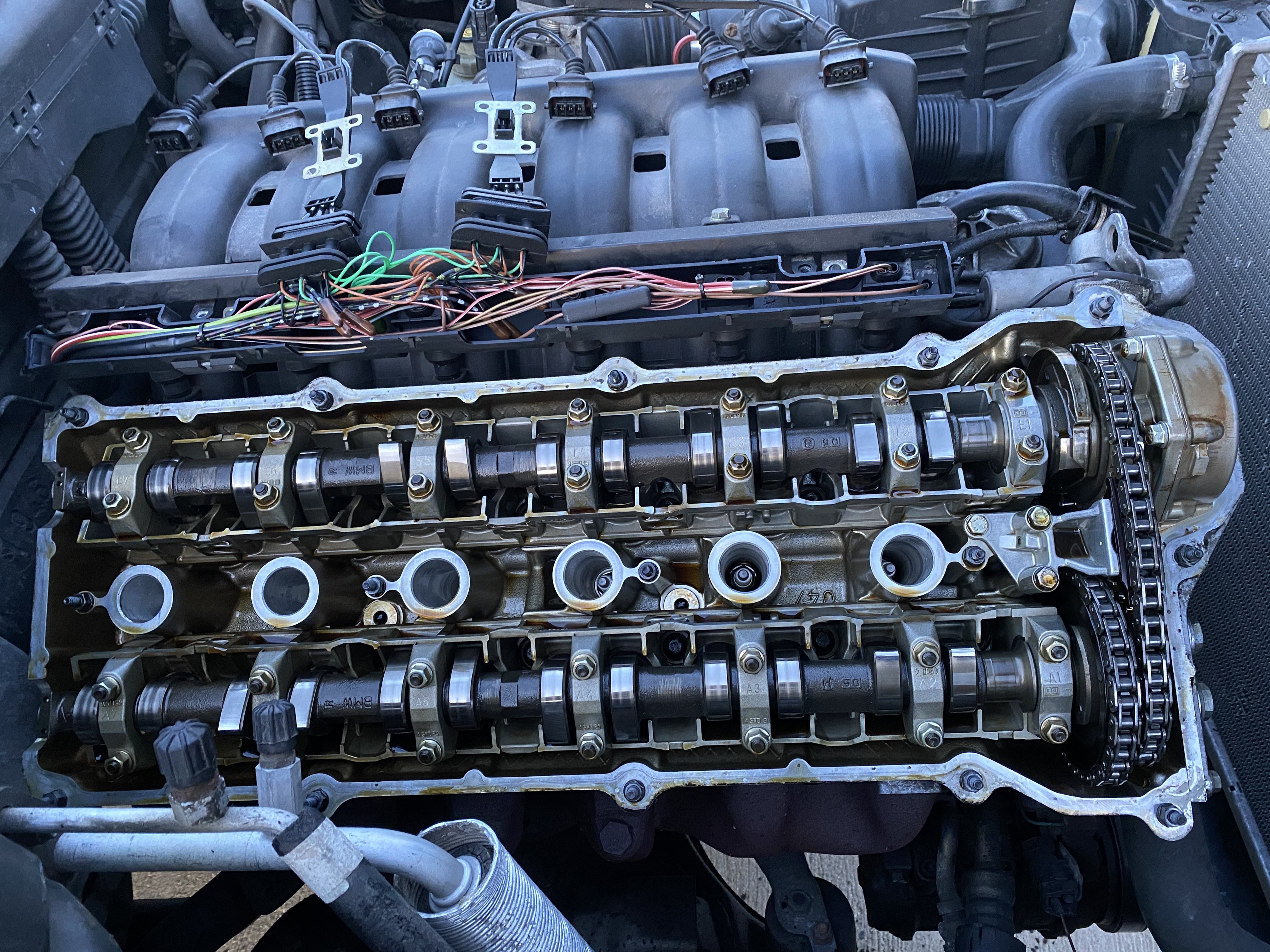

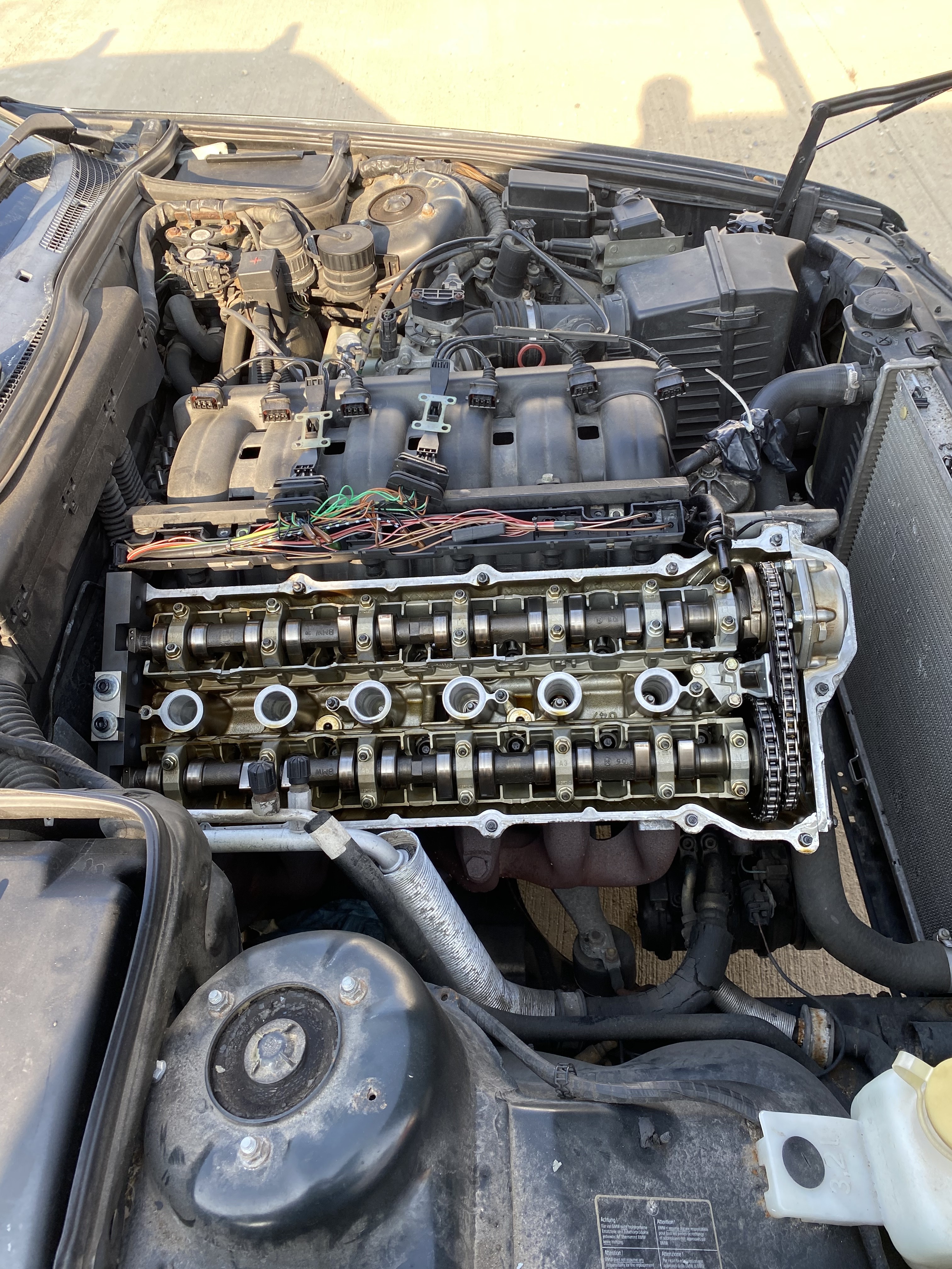

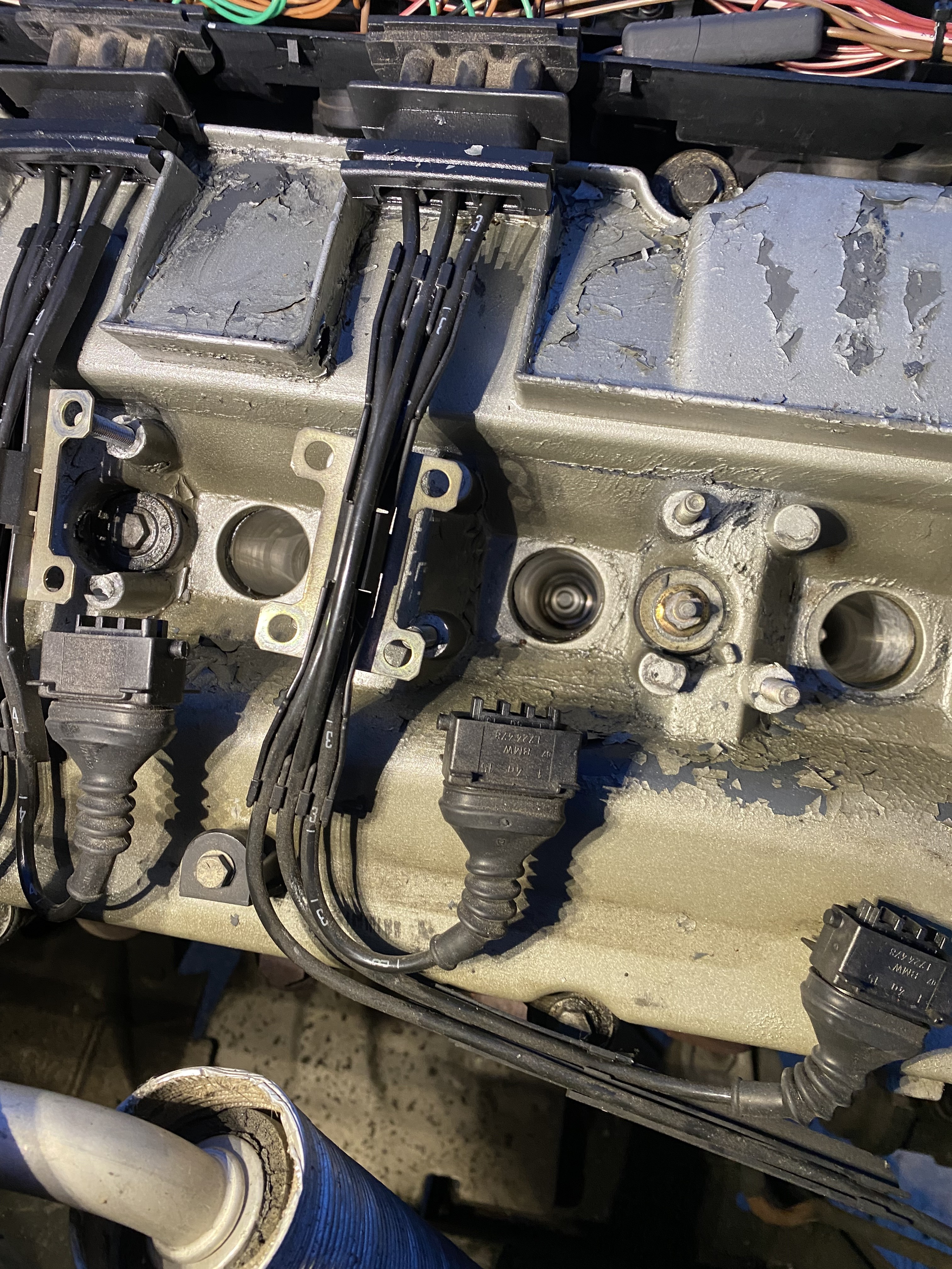

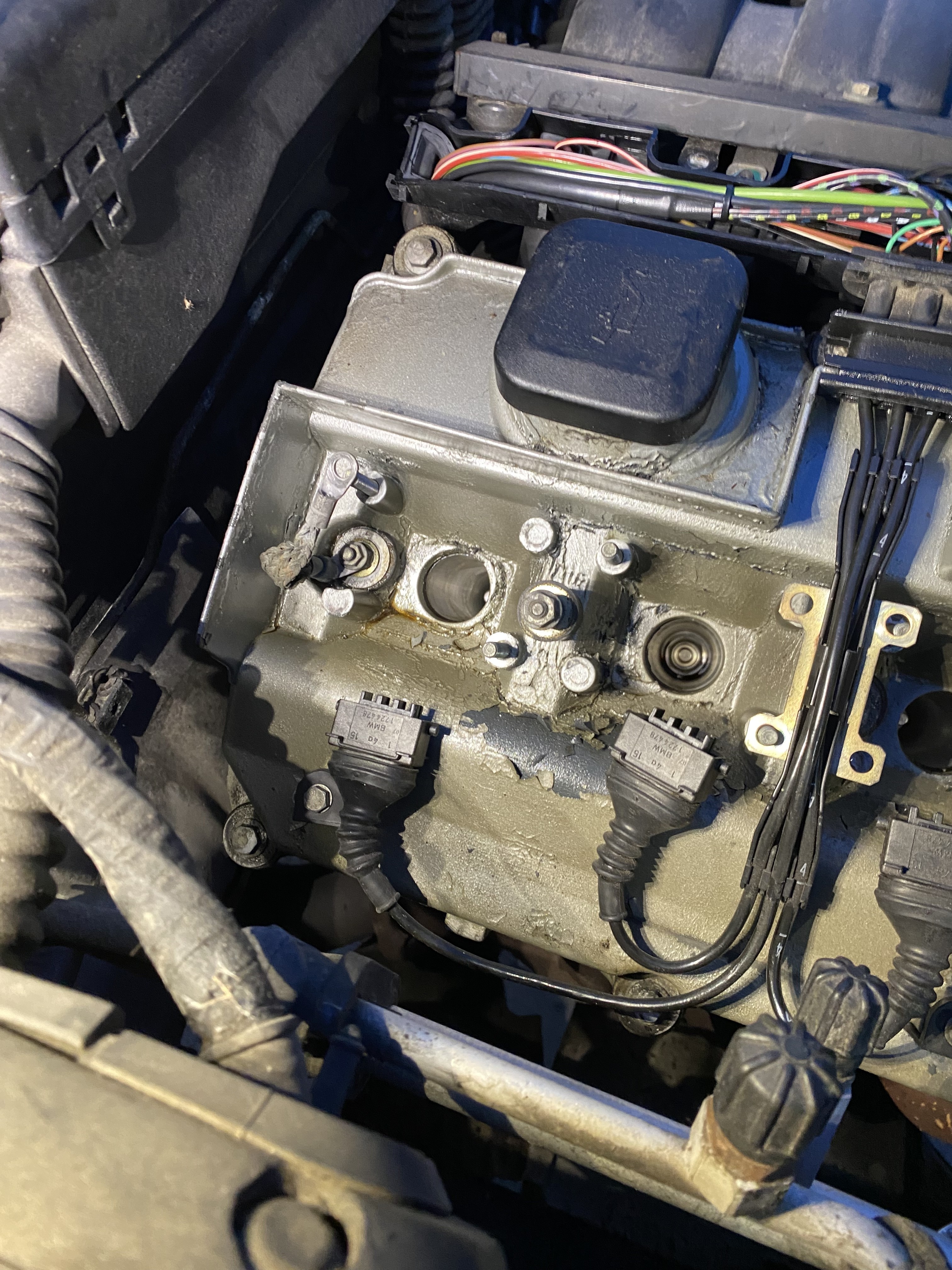

P_Roloff Posted June 8, 2023 Author Report Share Posted June 8, 2023 Finally got the VANOS unit installed and the car buttoned back up. Decided to forgo the anti rattle kit and just do seals because it wasn’t making noise and I just wanted the car back together. Idled rough on the first start, but then shut it off and restarted and was much better. Powerband is now smooth again without the rubber band effect when VANOS kicks in, yo! and overall drivability is way, way better. Hoping to see some MPG improvements too! Going to start driving this to keep miles off the E91, this still needs some things here and there but mostly minor stuff. Rear suspension work will probably continue to get put off, but 🤷♂️ KaiserRolls and m42b32 2 Quote Link to comment Share on other sites More sharing options...
