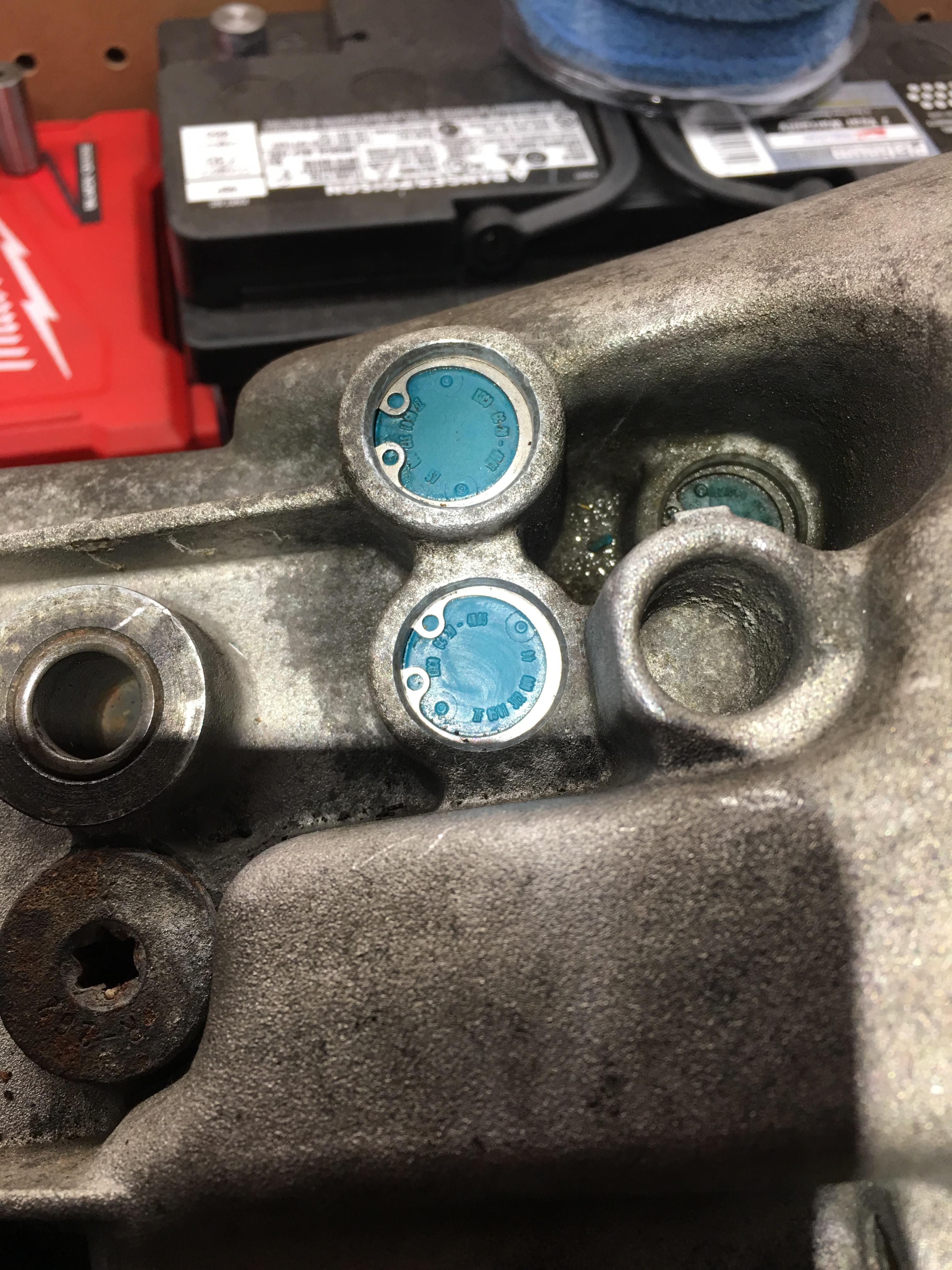

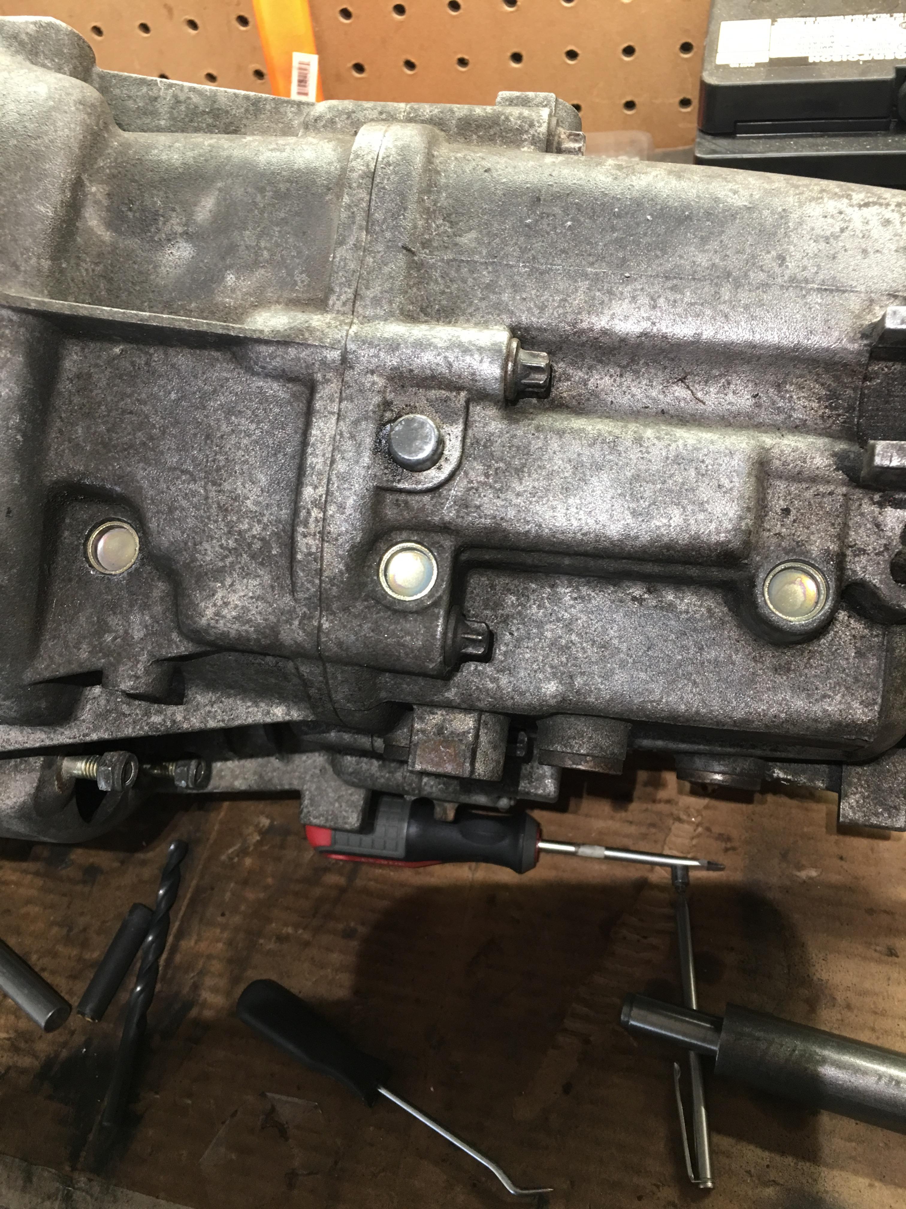

KaiserRolls Posted May 28, 2019 Author Report Share Posted May 28, 2019 This weekend I got around to doing the detent service on the zf. Thanks to @m42b32 for the trans tools rental. It’s pretty easy to do, most annoying part was when I had a snap ring fuck-off into a low earth orbit and bounce off the evo/Miata/garage door. Found it after a few minutes luckily. m42b32, Jdesign, P_Roloff and 1 other 1 3 Quote Link to comment Share on other sites More sharing options...

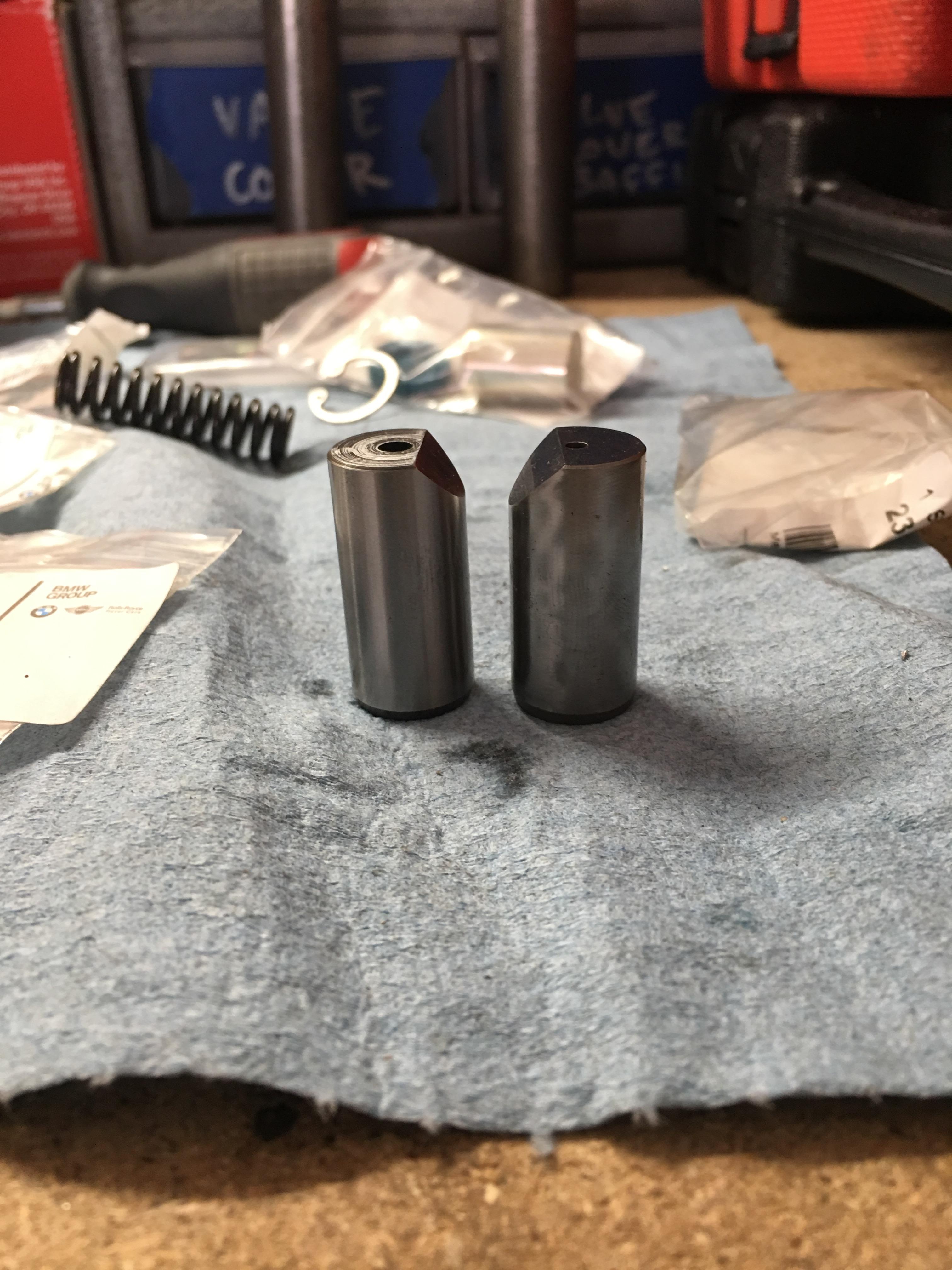

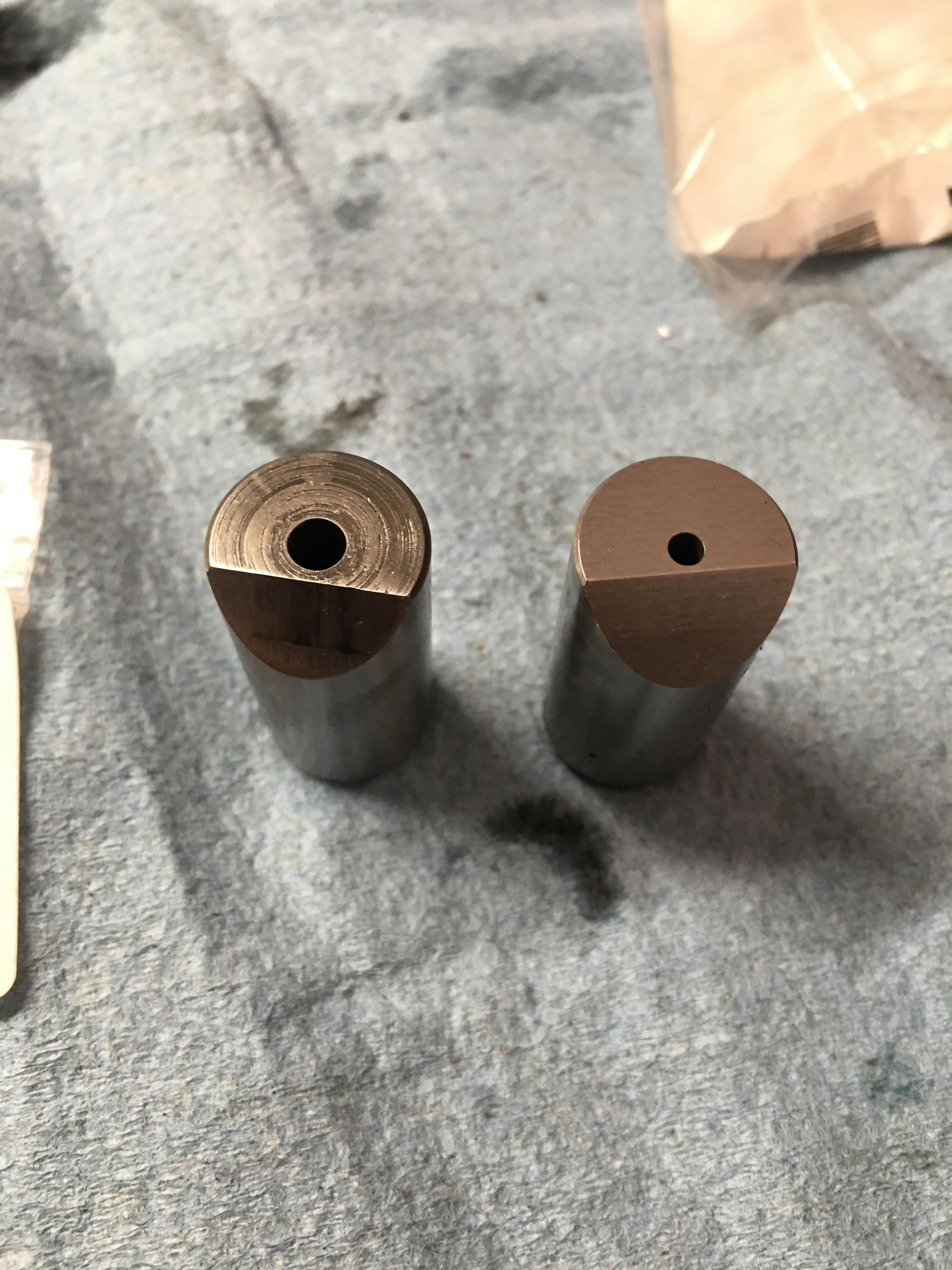

KaiserRolls Posted May 28, 2019 Author Report Share Posted May 28, 2019 Mobile is a real dick with putting text where I want without having to go in and edit the post so here’s the difference between the old 5th gear detent and the new 5th gear detent. (New detent on right) Quote Link to comment Share on other sites More sharing options...

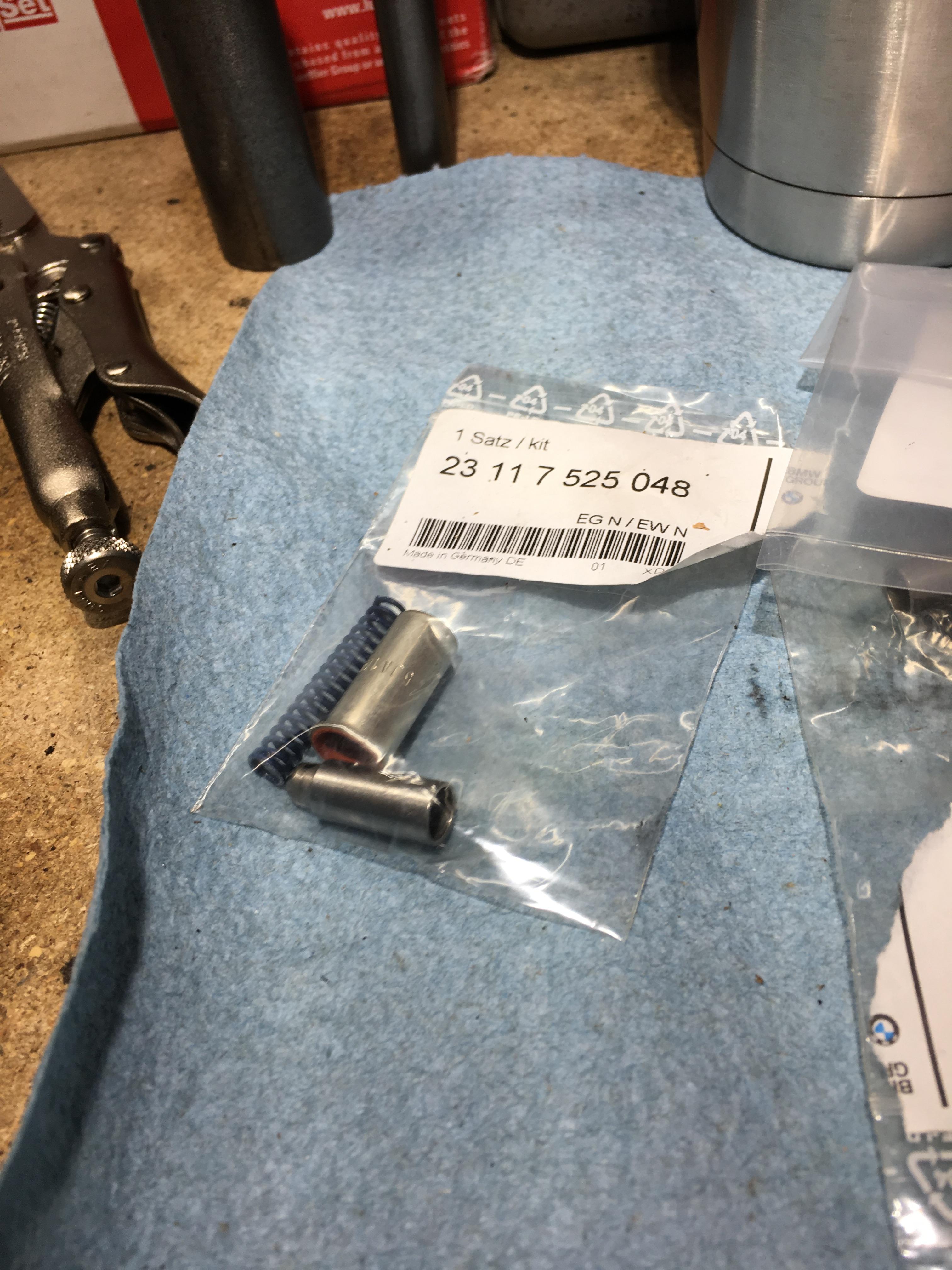

KaiserRolls Posted May 28, 2019 Author Report Share Posted May 28, 2019 Also they totally revised the pins on the top of the trans and added a coated bushing/sleeve instead of having the detent ride in a machined bore Quote Link to comment Share on other sites More sharing options...

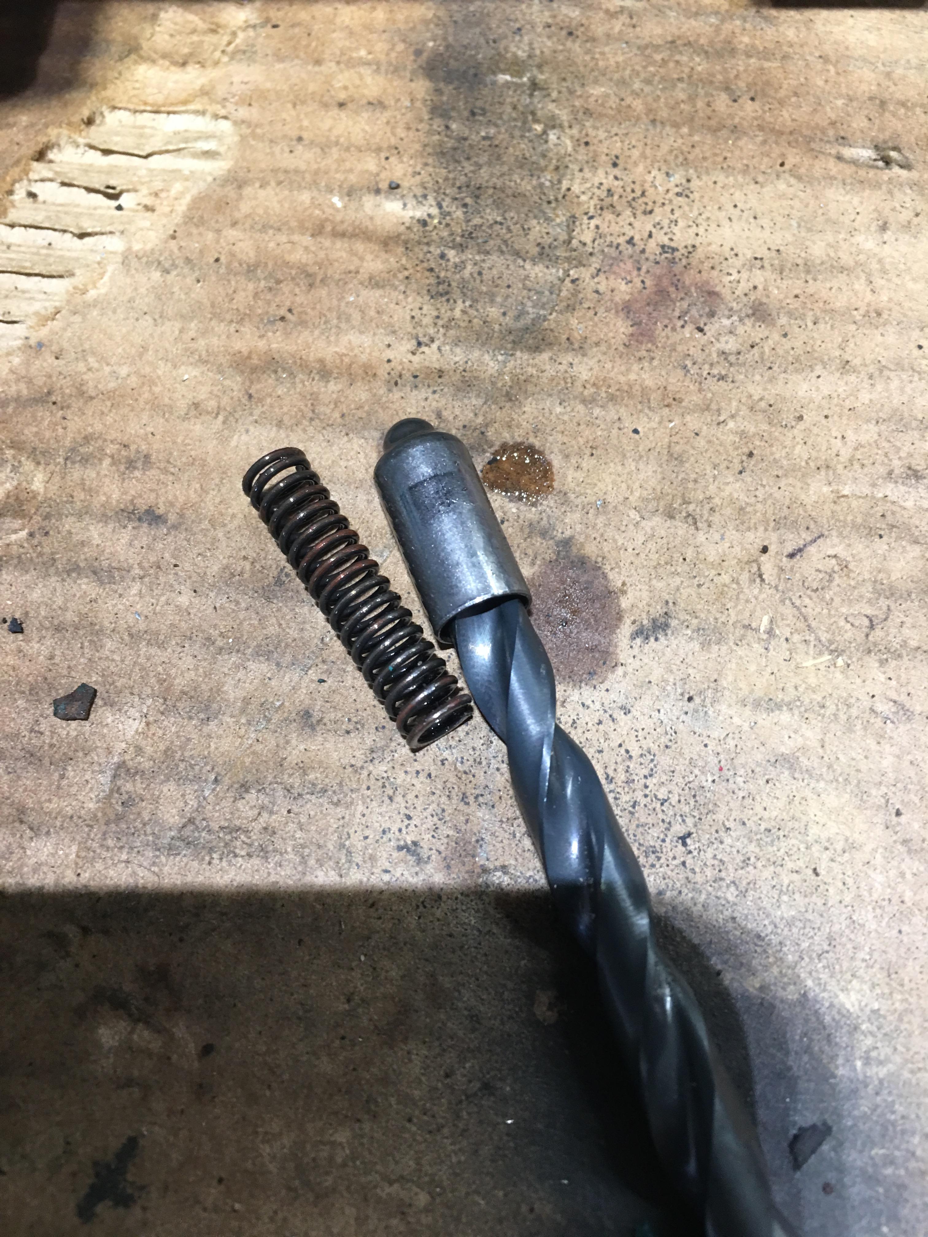

KaiserRolls Posted May 28, 2019 Author Report Share Posted May 28, 2019 None of my pins were frozen in the bores, but I figured I’d knock this out while the trans was out. A few definitely showed signs of wear though. Overall pretty easy to do and hoping it wasn’t pointless. Jdesign 1 Quote Link to comment Share on other sites More sharing options...

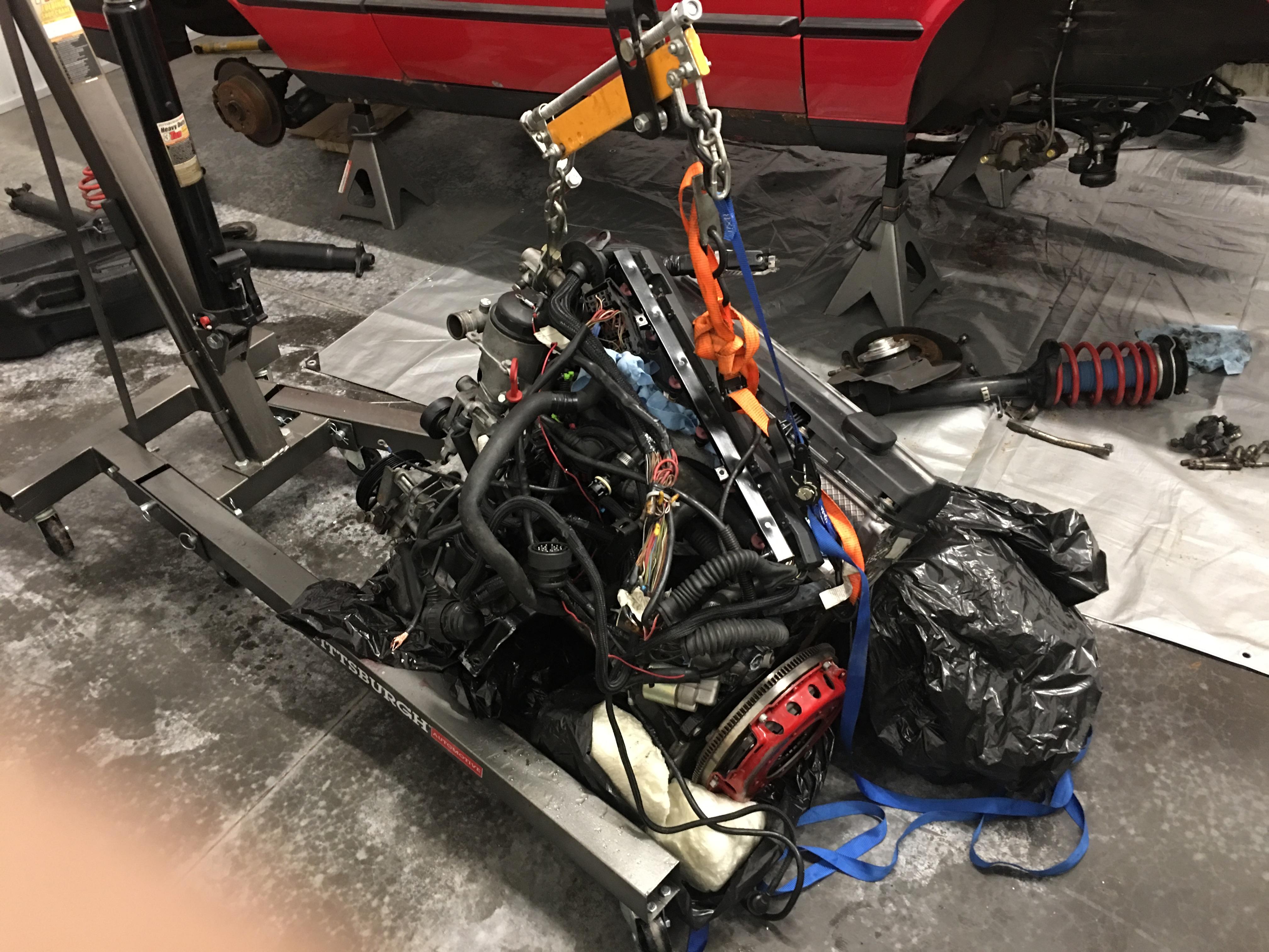

KaiserRolls Posted June 3, 2019 Author Report Share Posted June 3, 2019 Started pulling the g260, got carried away Jdesign, SteelBlue, B C and 1 other 4 Quote Link to comment Share on other sites More sharing options...

SteelBlue Posted June 4, 2019 Report Share Posted June 4, 2019 Why did you end up pulling it? Quote Link to comment Share on other sites More sharing options...
KaiserRolls Posted June 4, 2019 Author Report Share Posted June 4, 2019 2 minutes ago, SteelBlue said: Why did you end up pulling it? Insulation was still present on trans tunnel, couldn’t get to the hardware, loosening mounts and tilting motor until it hit firewall was not giving me enough room sans insulation and it could’ve stayed put Quote Link to comment Share on other sites More sharing options...

SteelBlue Posted June 4, 2019 Report Share Posted June 4, 2019 8 hours ago, KaiserRolls said: Insulation was still present on trans tunnel, couldn’t get to the hardware, loosening mounts and tilting motor until it hit firewall was not giving me enough room sans insulation and it could’ve stayed put Guess that means mine will have to come out as well... Quote Link to comment Share on other sites More sharing options...
KaiserRolls Posted June 4, 2019 Author Report Share Posted June 4, 2019 45 minutes ago, SteelBlue said: Guess that means mine will have to come out as well... I ended up tilting and pulling the motor enough to where I could get to the hardware on the back of the block. Then slipped the trans off. So it doesn’t necessarily need to come all the way out, but reinstalling with the engine dangling would be quite annoying Quote Link to comment Share on other sites More sharing options...
