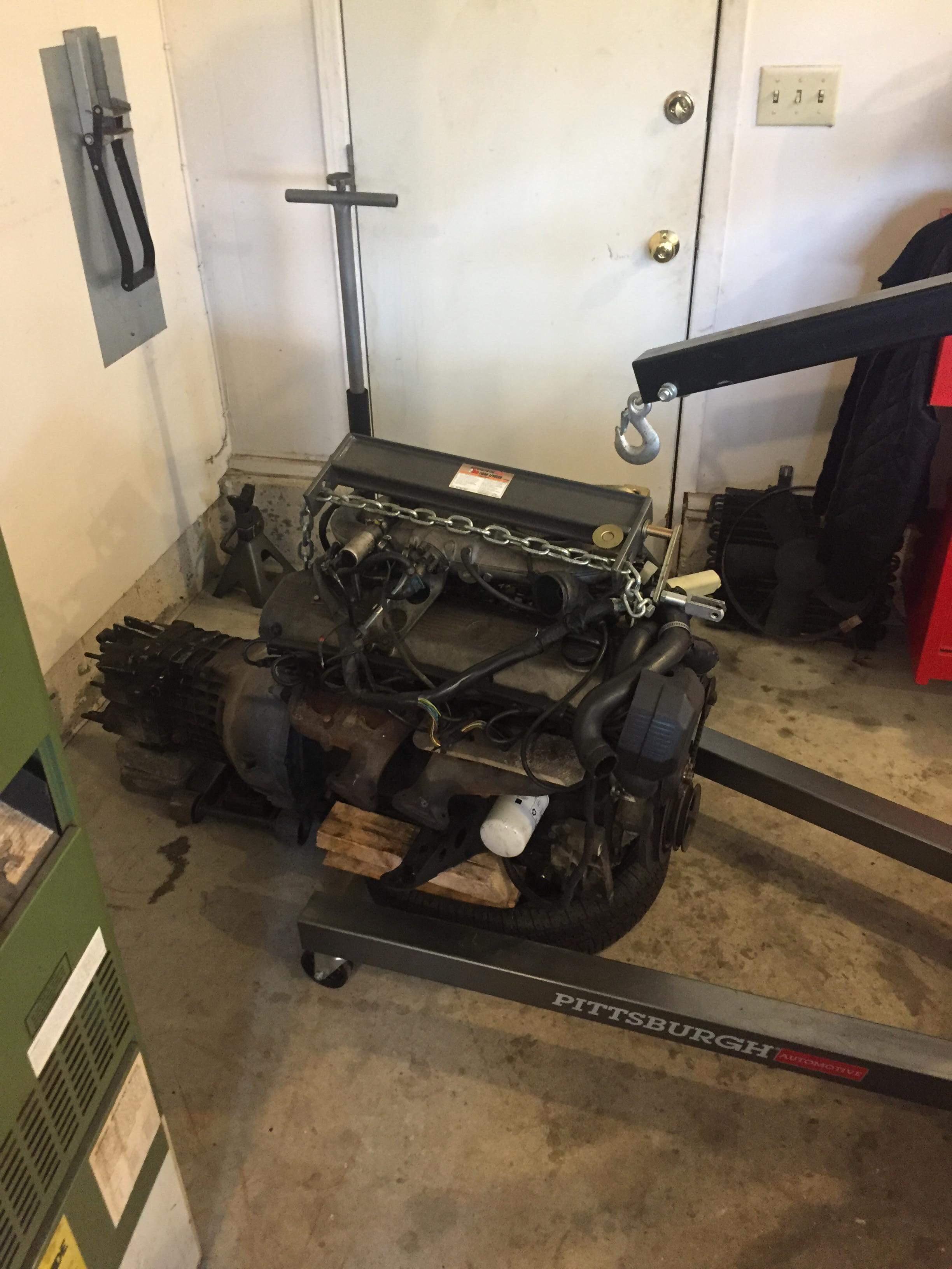

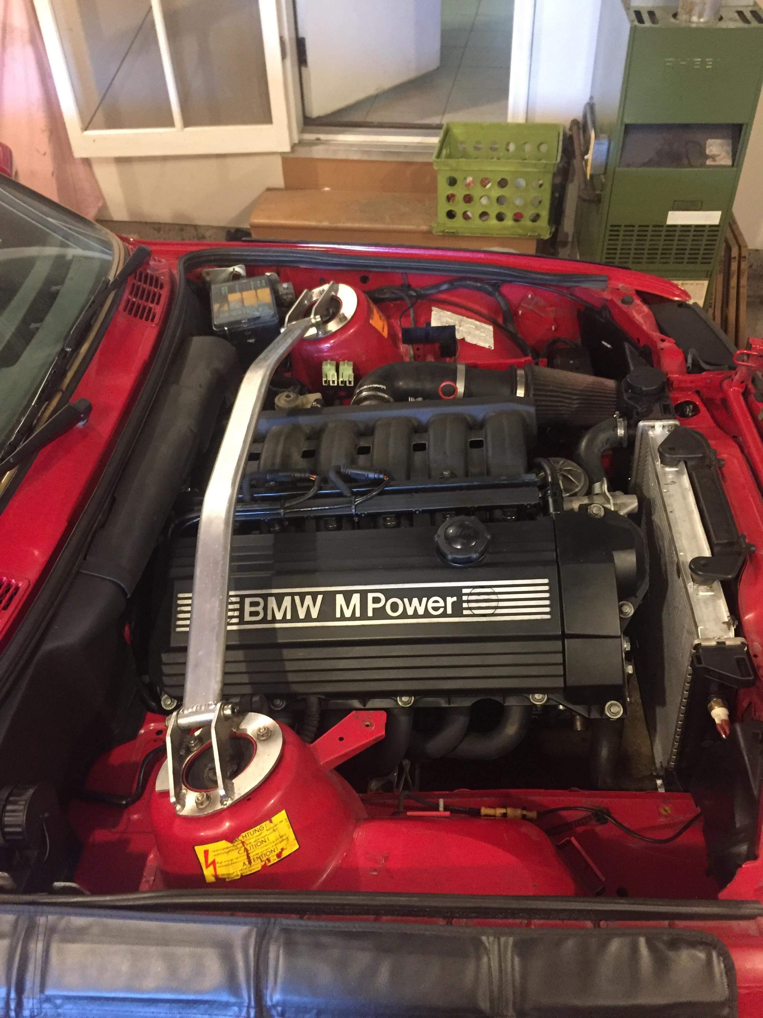

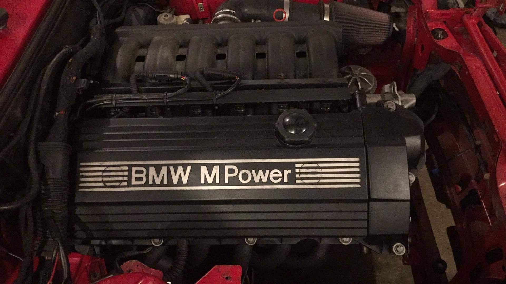

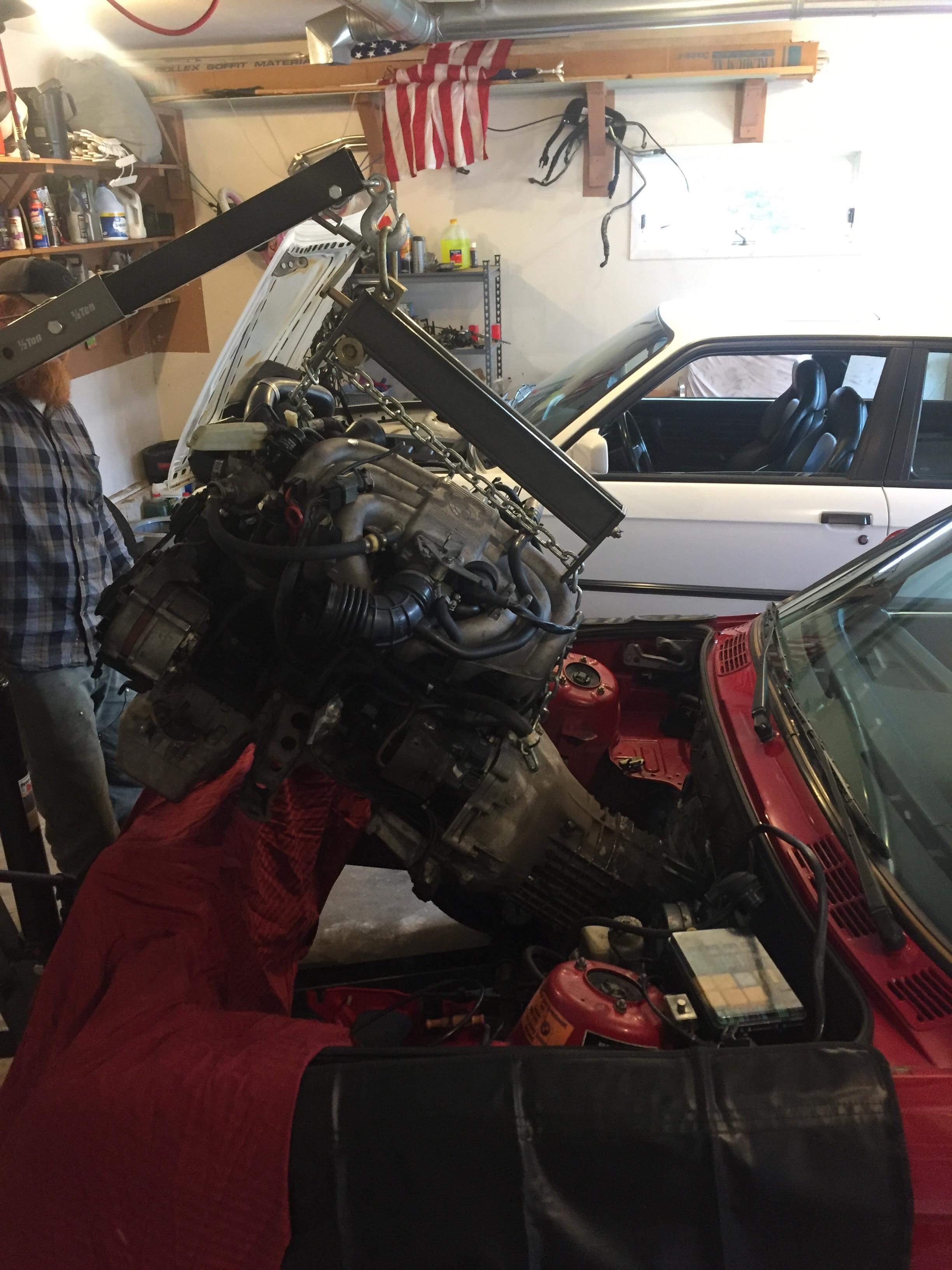

timmer Posted September 29, 2018 Author Report Share Posted September 29, 2018 FALL UPDATE I’ve finally made the decision with the drivetrain, and the 2.7i is our the door, and S52 is in... 😀 I found a nice, refreshed/bulletproofed S52 and ZF 5-speed for sale in Belvidere Illinois, and the car is heading down today to have its heart transplant... The S52 is built nice with Schrick 264/256 cams, 3.5” MAF, 24# flow matched injectors, 93 octane tune with 7,200k redline, full obd2, ews/emissions delete, and a host of other goodness. Stay tuned for build pics! -Tim straight6pwr, jc43089, AsparagusMike and 3 others 6 Quote Link to comment Share on other sites More sharing options...

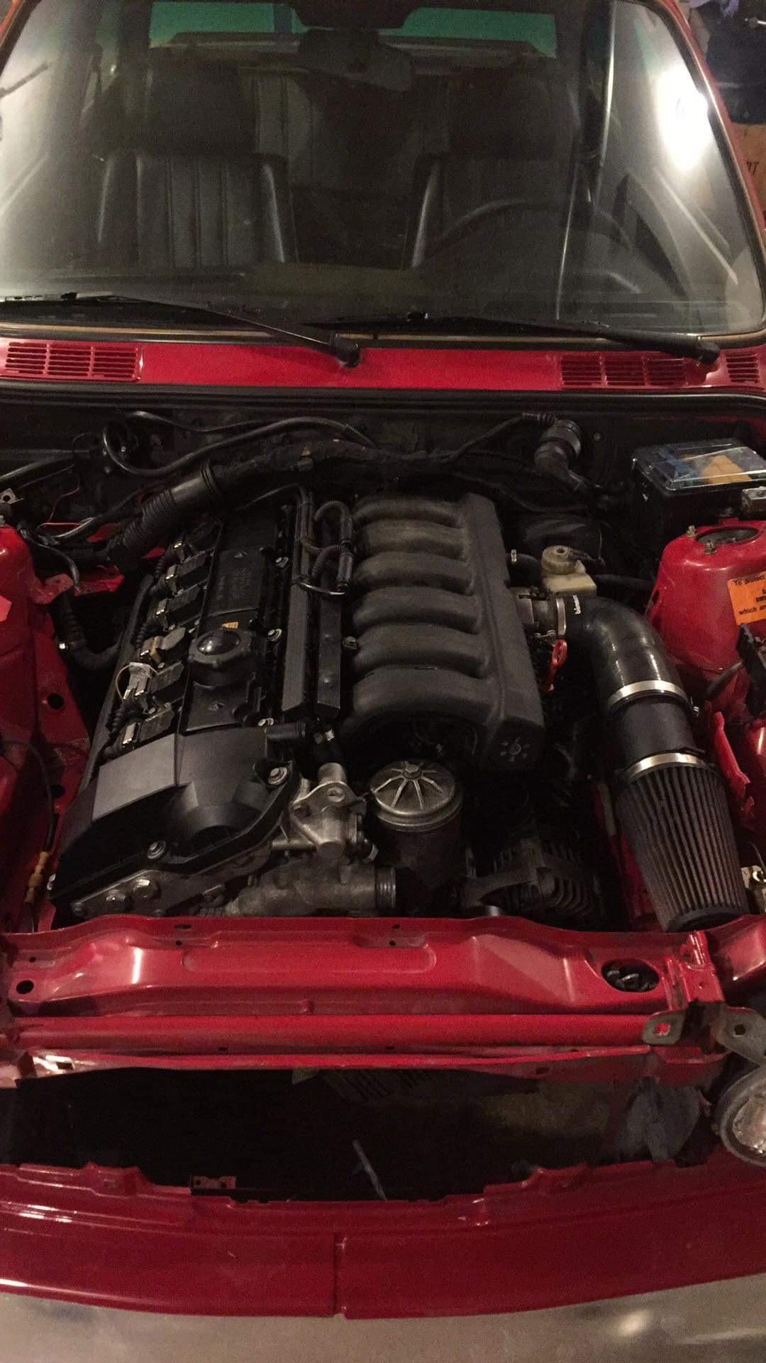

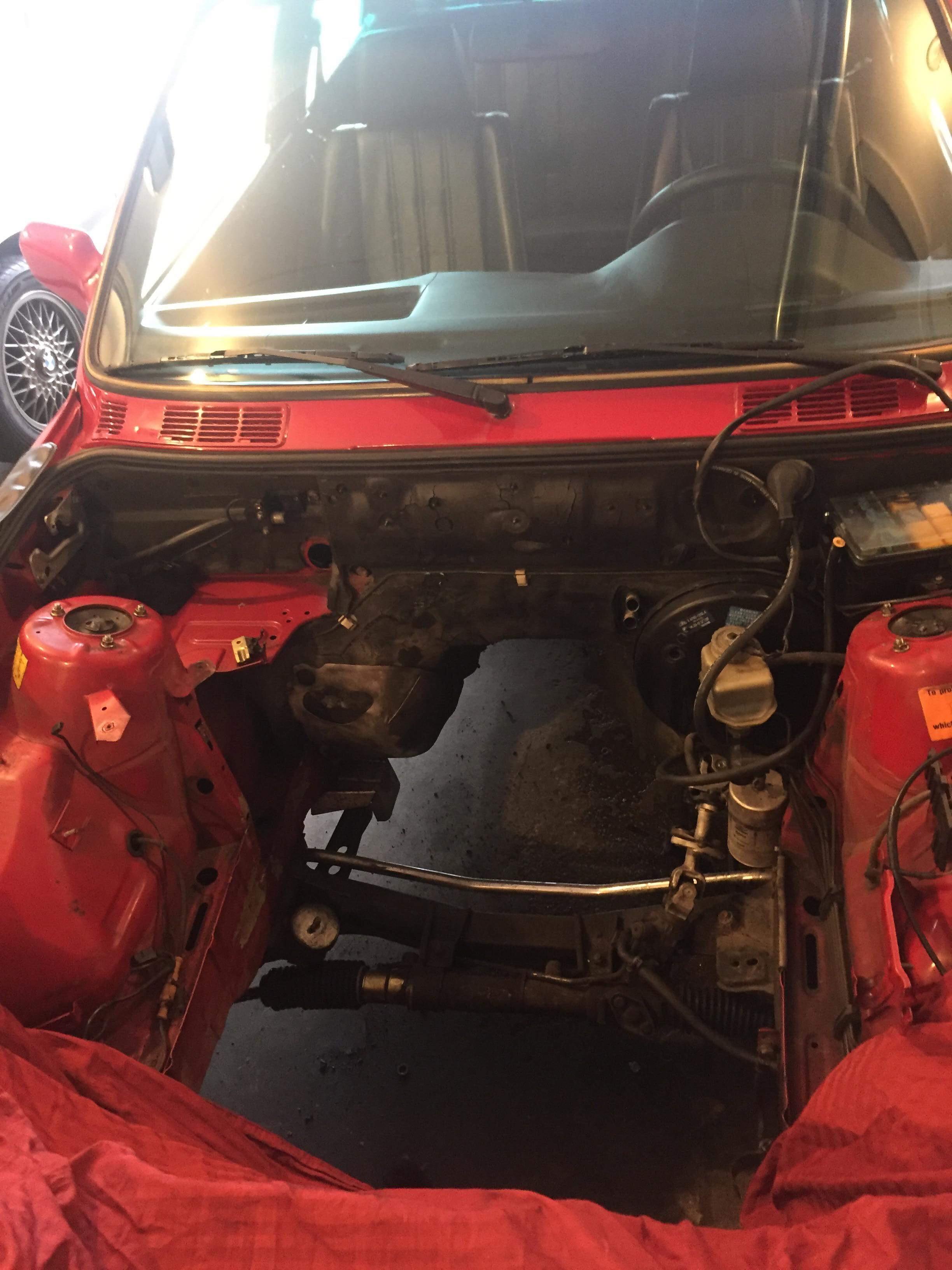

timmer Posted October 3, 2018 Author Report Share Posted October 3, 2018 Progress... Quote Link to comment Share on other sites More sharing options...
SteelBlue Posted October 3, 2018 Report Share Posted October 3, 2018 Relocating stock booster or going ix/944? Staying OBD2? What's your plan for engine to body harness? Quote Link to comment Share on other sites More sharing options...
timmer Posted October 3, 2018 Author Report Share Posted October 3, 2018 Using an e21 brake booster, and a custom wiring harness...the guy doing the swap is a wizard at making harnesses. Keeping full OBD2 functionality. Quote Link to comment Share on other sites More sharing options...

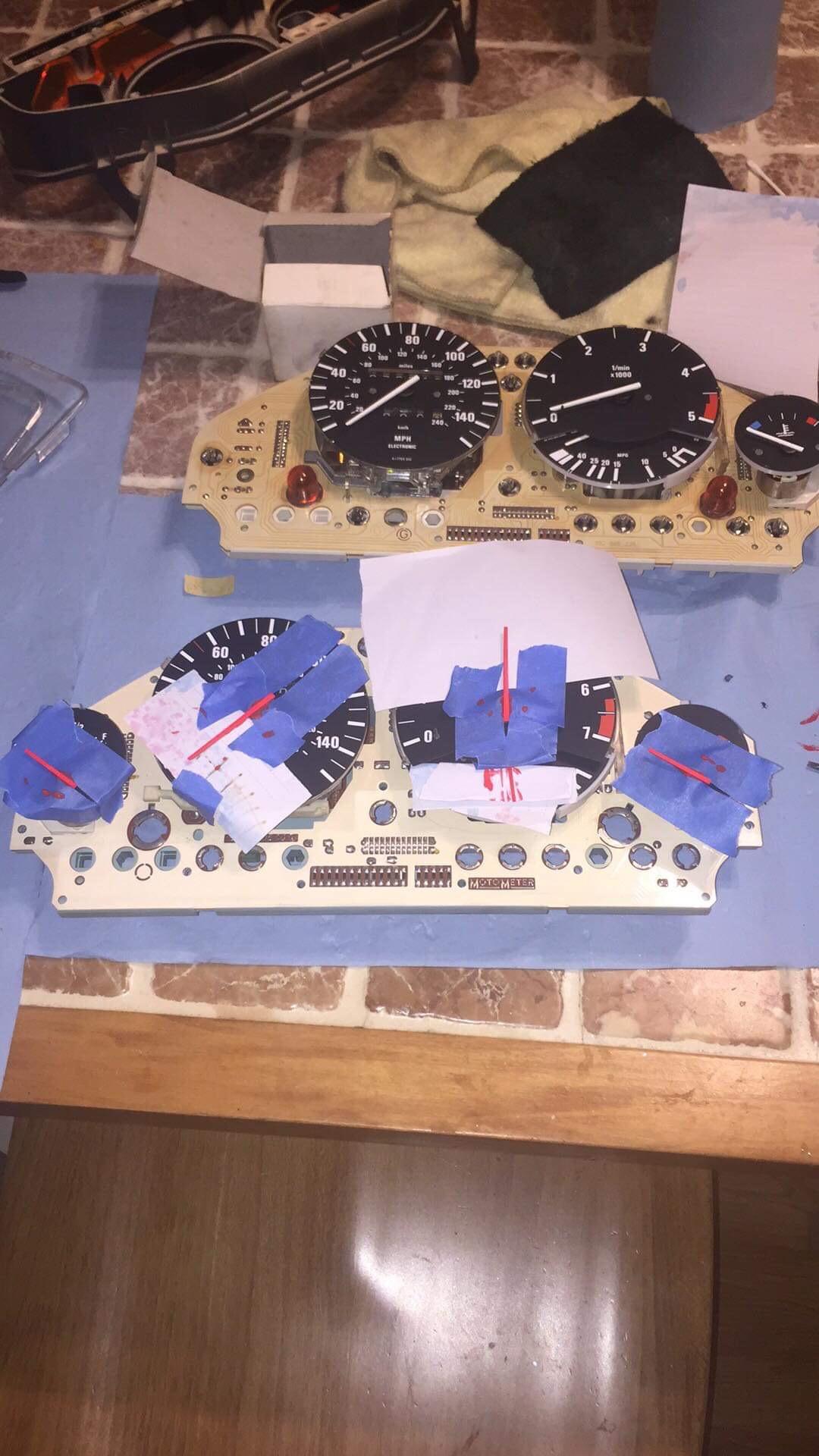

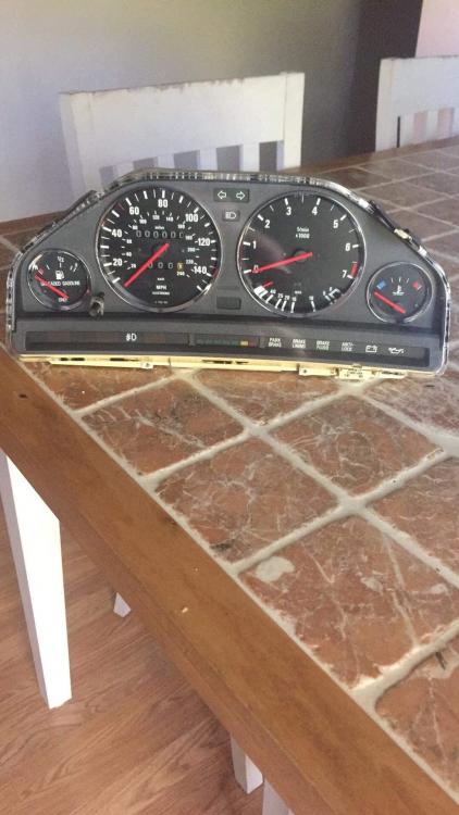

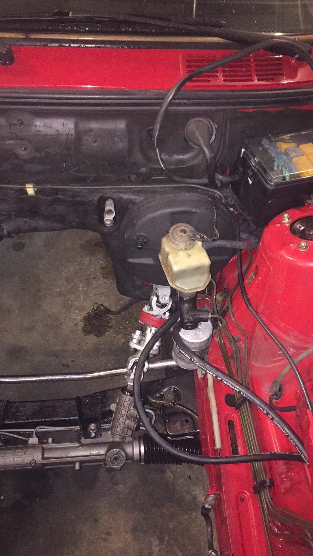

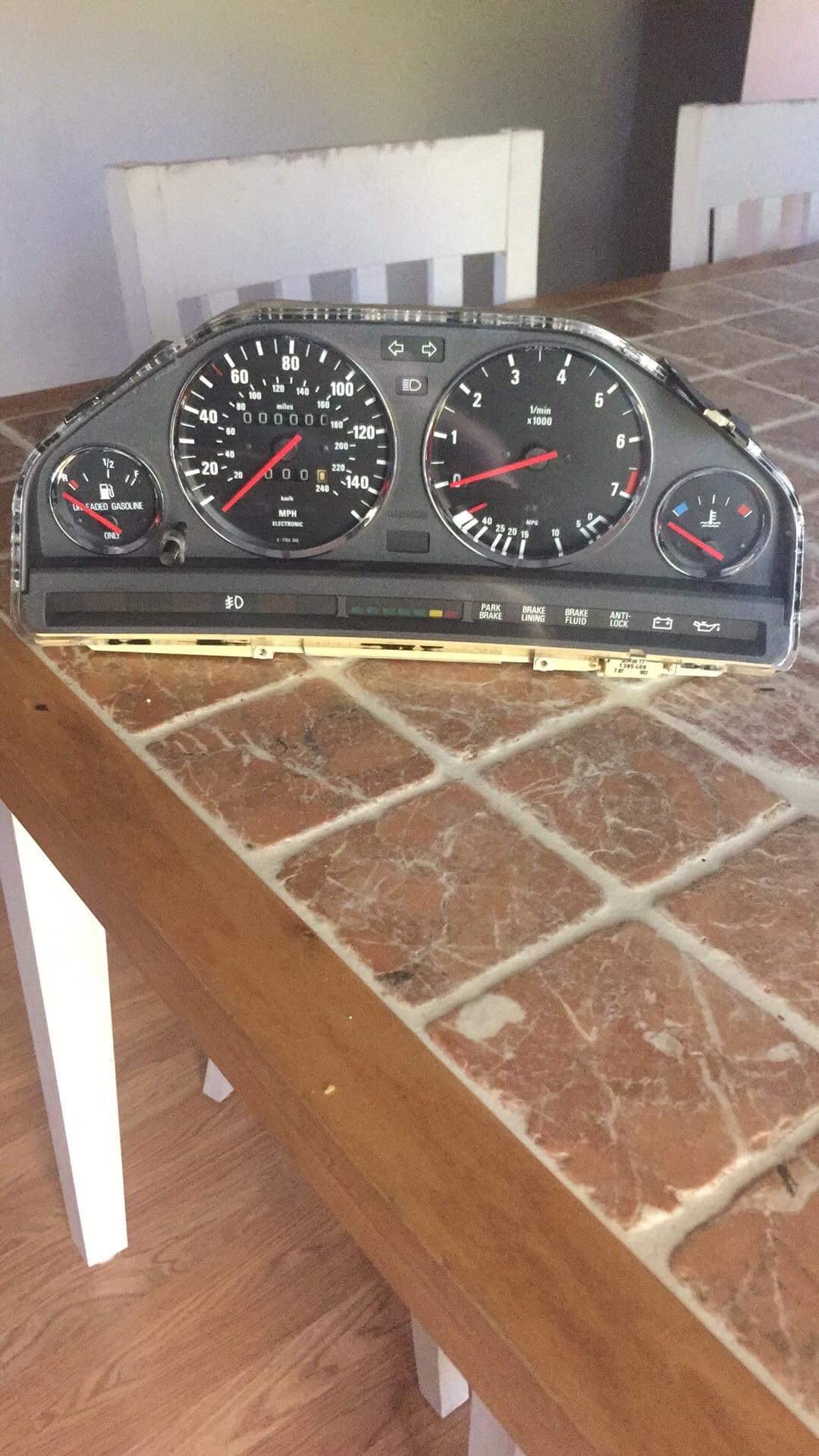

timmer Posted October 24, 2018 Author Report Share Posted October 24, 2018 Z3 steering rack is in, brake booster in, and refreshed the gauge cluster 😁 Jdesign 1 Quote Link to comment Share on other sites More sharing options...
m42b32 Posted October 24, 2018 Report Share Posted October 24, 2018 Cluster looks great! What did you use to paint the needles? Quote Link to comment Share on other sites More sharing options...
timmer Posted October 24, 2018 Author Report Share Posted October 24, 2018 1 hour ago, m42b32 said: Cluster looks great! What did you use to paint the needles? Fluorescent red needle paint... a couple coats will do! https://www.ebay.com/i/190281783139?chn=ps m42b32 1 Quote Link to comment Share on other sites More sharing options...
Jdesign Posted October 24, 2018 Report Share Posted October 24, 2018 1 hour ago, timmer said: Fluorescent red needle paint... a couple coats will do! https://www.ebay.com/i/190281783139?chn=ps Interesting. My biggest gripe with the E30 clusters is the lack of lighting. LEDs help a ton, but the needles are always hard to see at night. I really want to upgrade to illuminated needles, its just a lot of work! Nice job, I cant wait to see more updates! Quote Link to comment Share on other sites More sharing options...

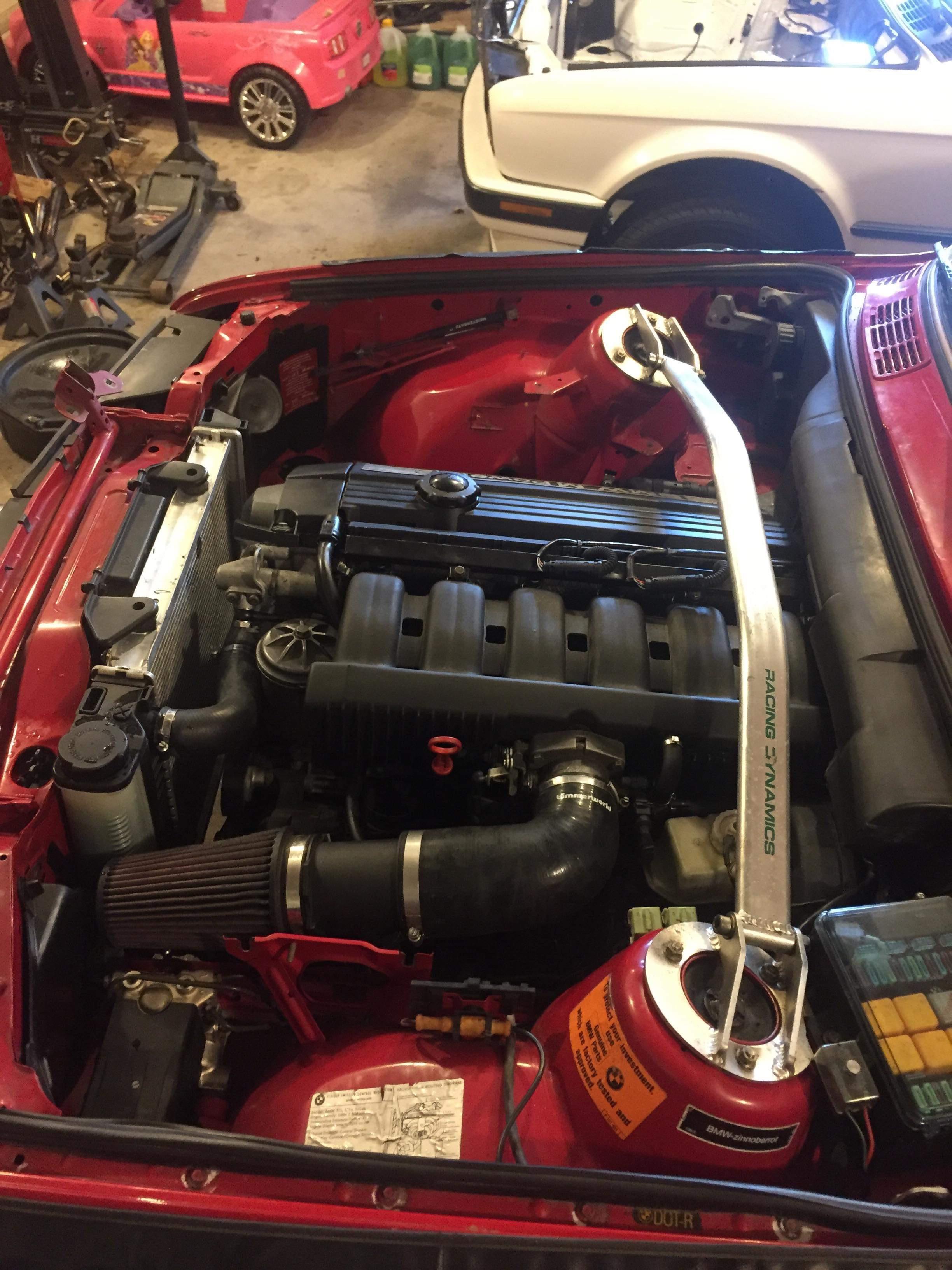

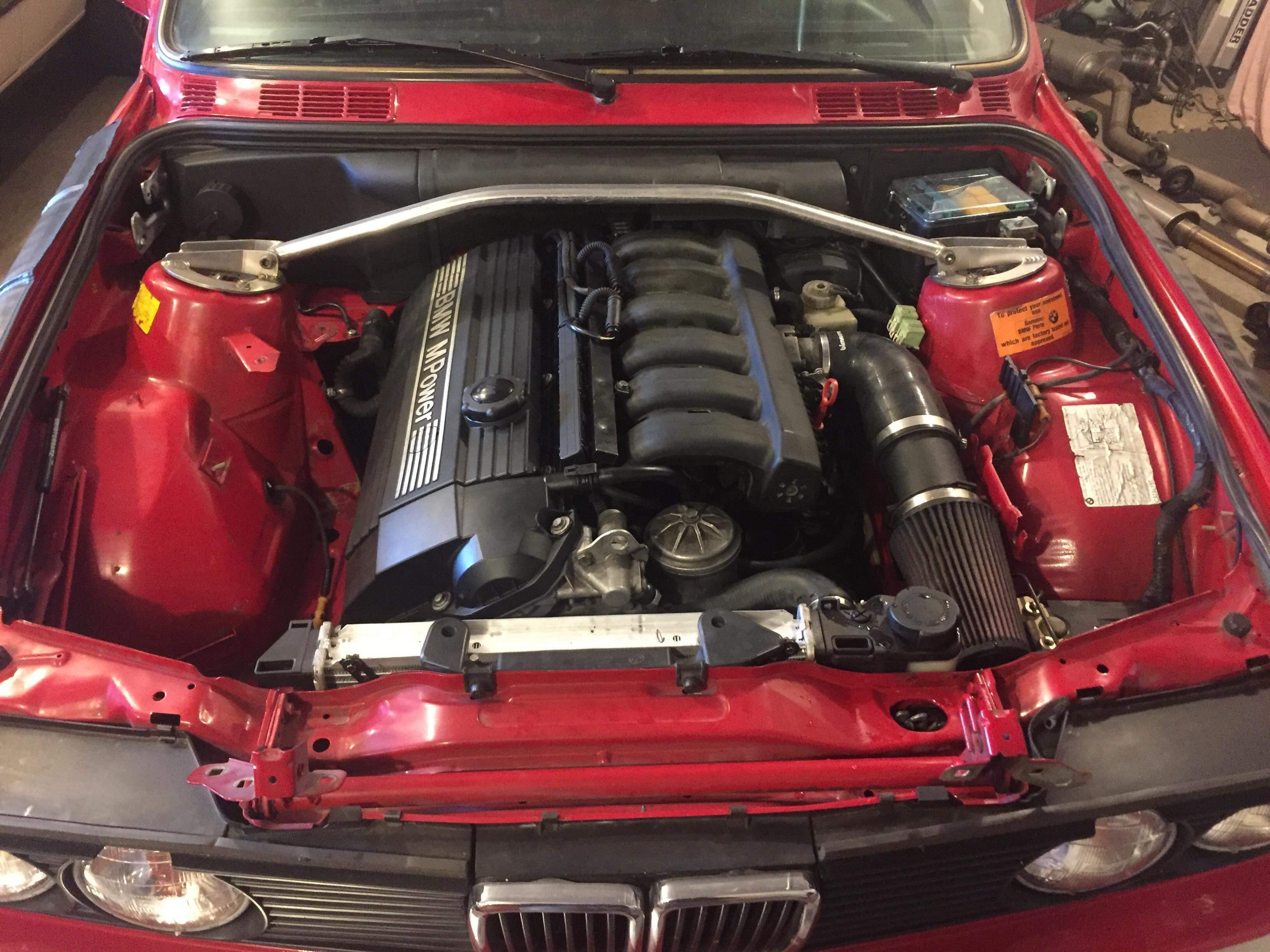

timmer Posted November 4, 2018 Author Report Share Posted November 4, 2018 Getting closer!! 😊 YoungCR, Jdesign and AsparagusMike 3 Quote Link to comment Share on other sites More sharing options...

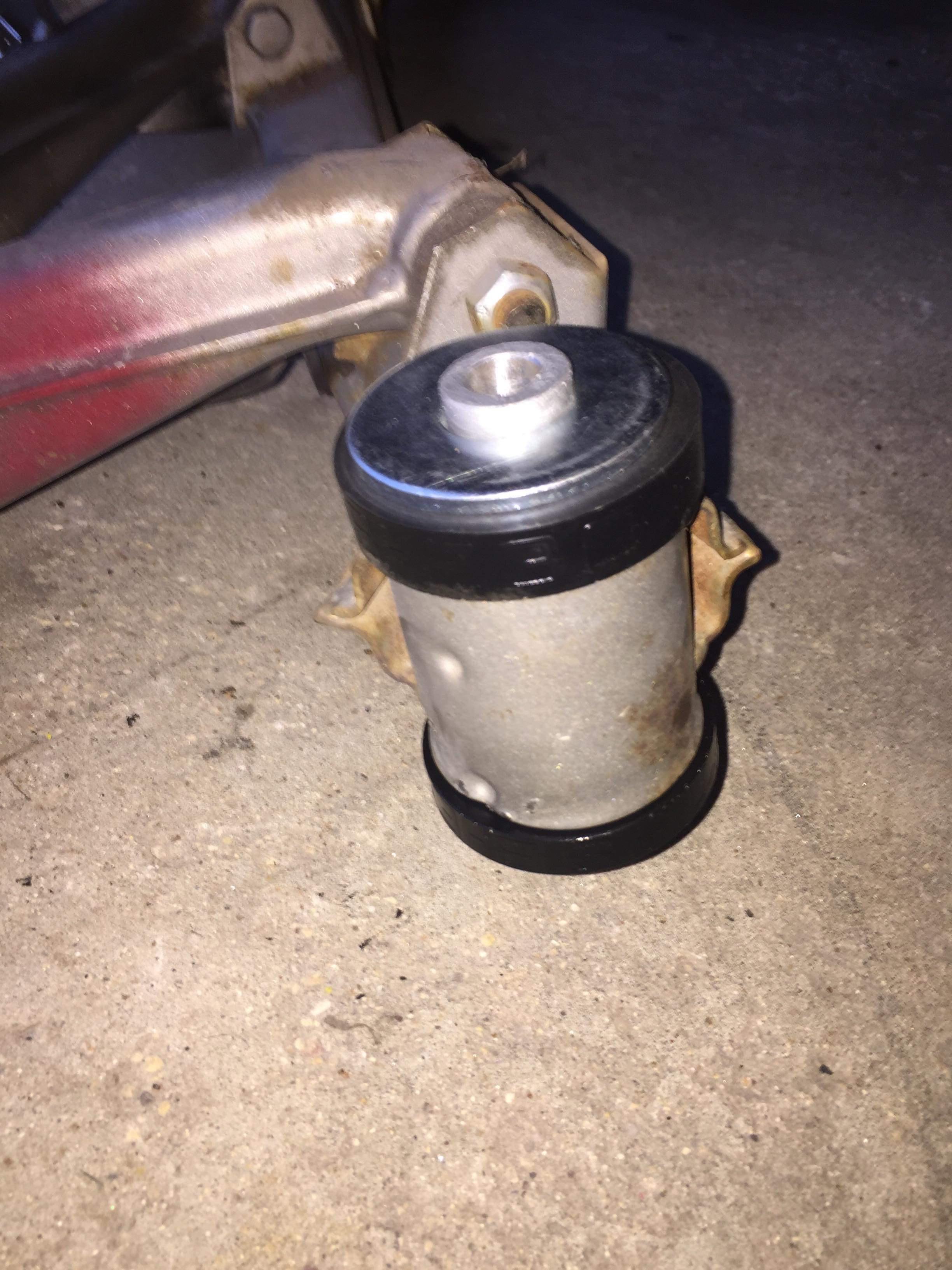

timmer Posted November 14, 2018 Author Report Share Posted November 14, 2018 She’s all buttoned up! Added uuc short shifter, new subframe bushings, and exhaust is installed... time to get her home!!! Too bad she will be going right into storage... Spring can’t come fast enough! SteelBlue, m42b32, P_Roloff and 3 others 6 Quote Link to comment Share on other sites More sharing options...

gilber33 Posted November 16, 2018 Report Share Posted November 16, 2018 What is that firewall cover? I love how it hides everything. Quote Link to comment Share on other sites More sharing options...
m42b32 Posted November 16, 2018 Report Share Posted November 16, 2018 21 minutes ago, gilber33 said: What is that firewall cover? I love how it hides everything. M42/S14 engine harness cover Quote Link to comment Share on other sites More sharing options...

gilber33 Posted November 16, 2018 Report Share Posted November 16, 2018 2 hours ago, m42b32 said: M42/S14 engine harness cover I want one. Do they fit with the m20? Quote Link to comment Share on other sites More sharing options...
timmer Posted November 17, 2018 Author Report Share Posted November 17, 2018 On 11/15/2018 at 12:42 PM, snap said: Very nice! Please post your driving impressions once you get around to driving it! Im excited for you man! Thanks Snap!! I had a chance to put a few miles on today, and all I can say is wow! With the schrick cams, it’s pretty docile around town under 4,000 rpms, and very streetable. Over 4K it is a beast and is hunting for traction. I couldn’t be happier! Too bad I have to put her under wraps soon... can’t wait for the E30 picnic! B C, Earl, Jdesign and 3 others 6 Quote Link to comment Share on other sites More sharing options...
