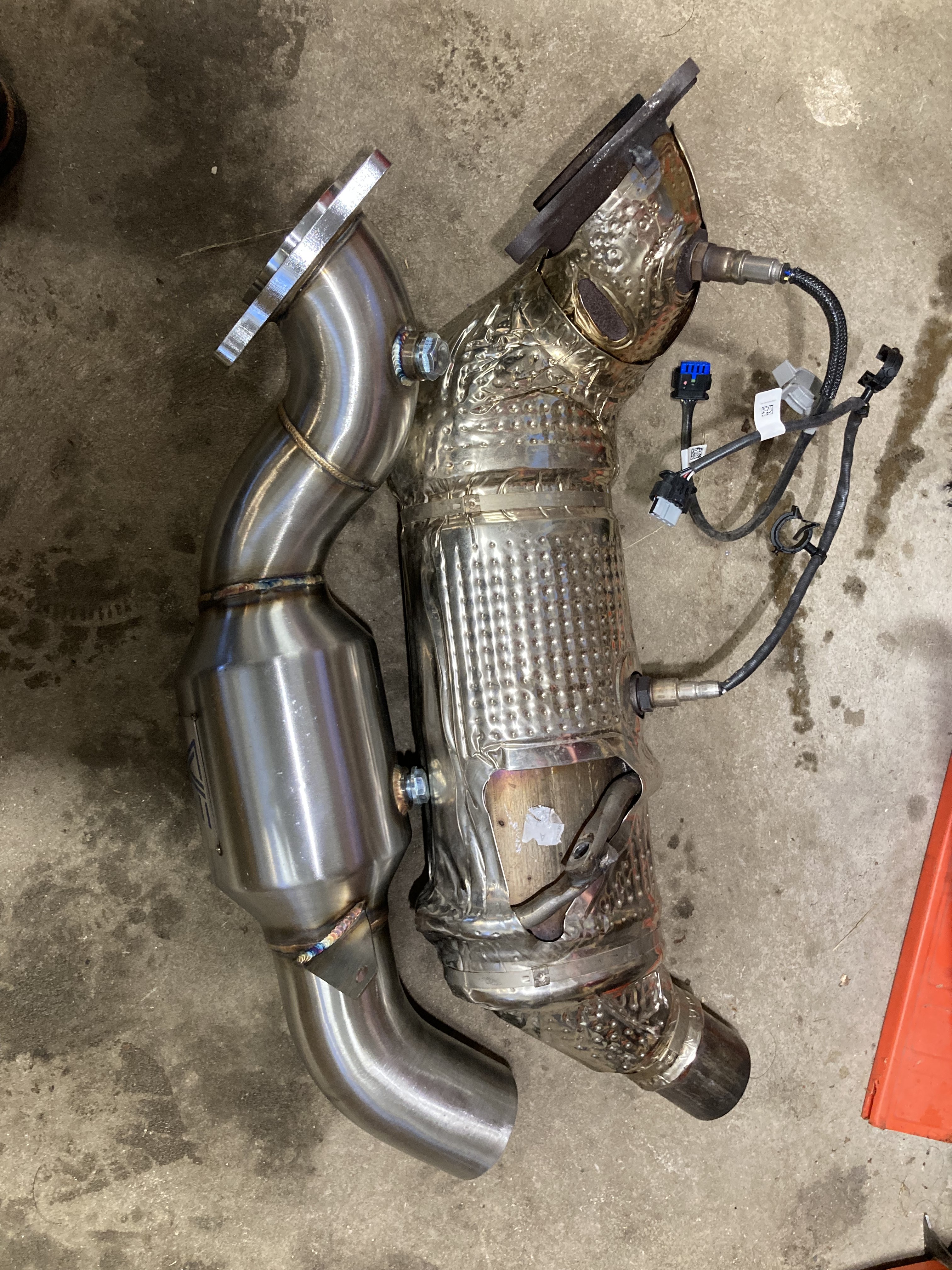

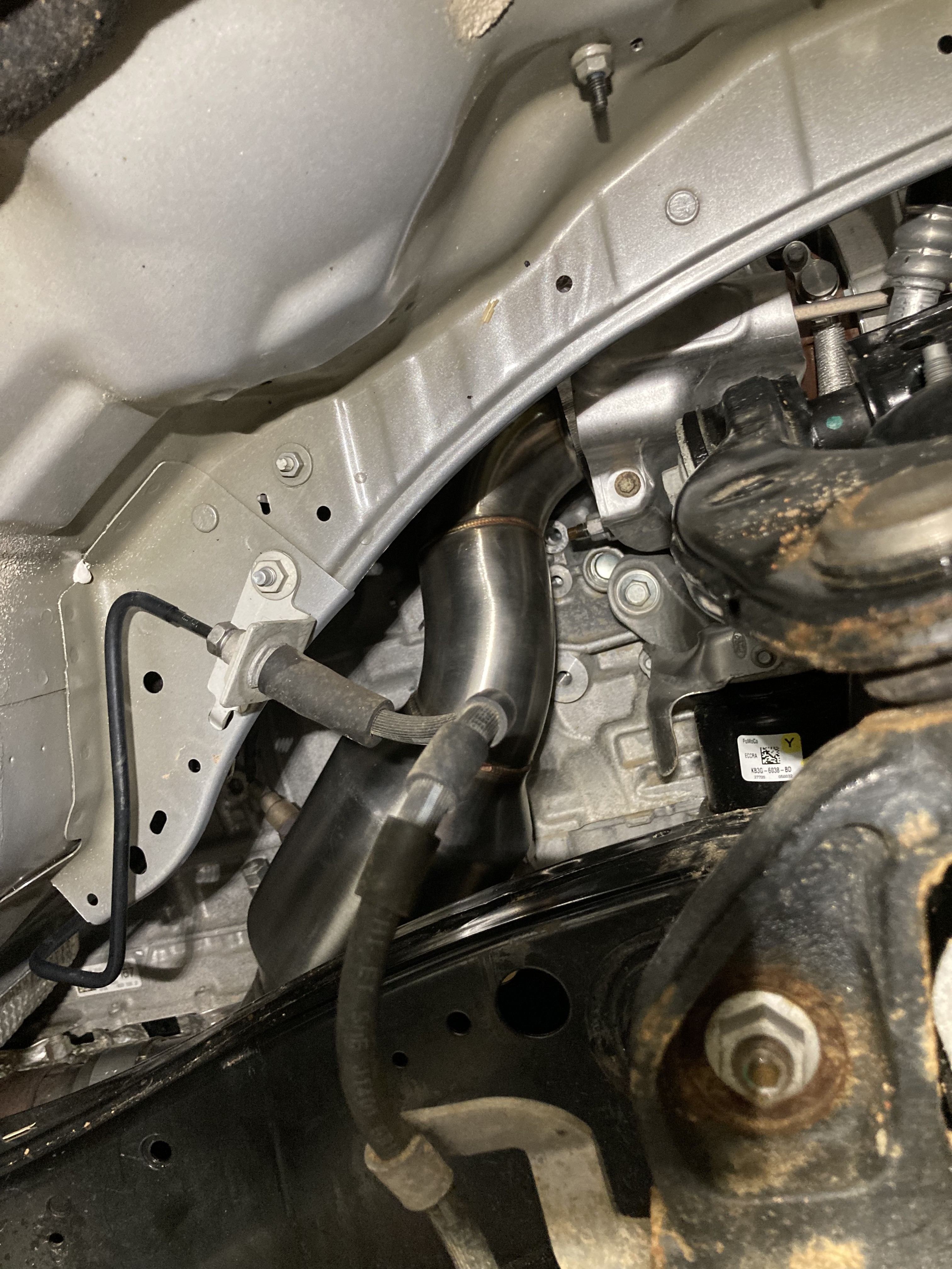

jc43089 Posted March 9, 2023 Author Report Share Posted March 9, 2023 Upgrade on the Ranger. New downpipe from CVFab. They seem like a Ford only performance place? Dunno I’ve never had a Ford before. Fit great, and wow is it nice working on something that isn’t rusty. Jdesign 1 Quote Link to comment Share on other sites More sharing options...

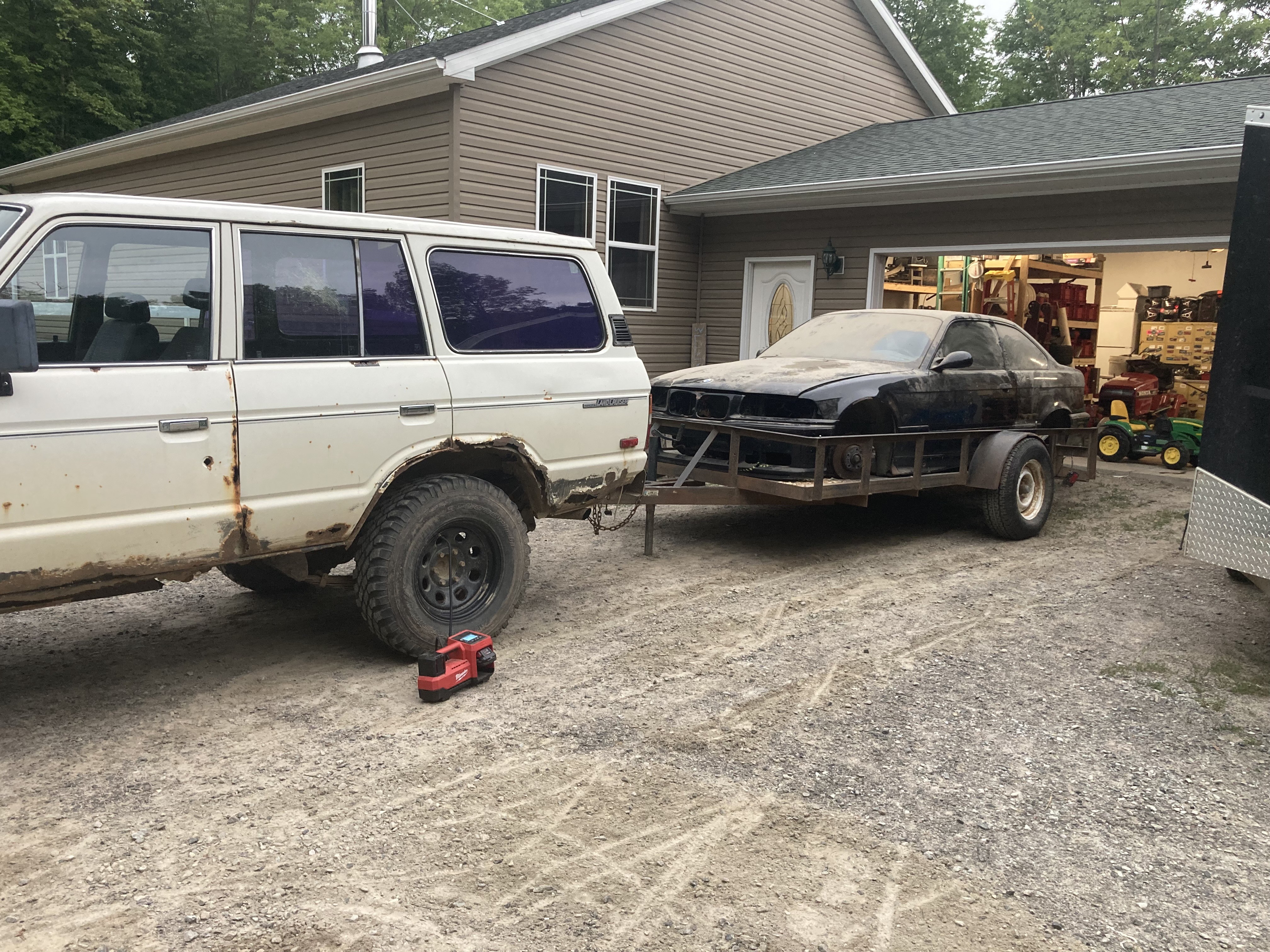

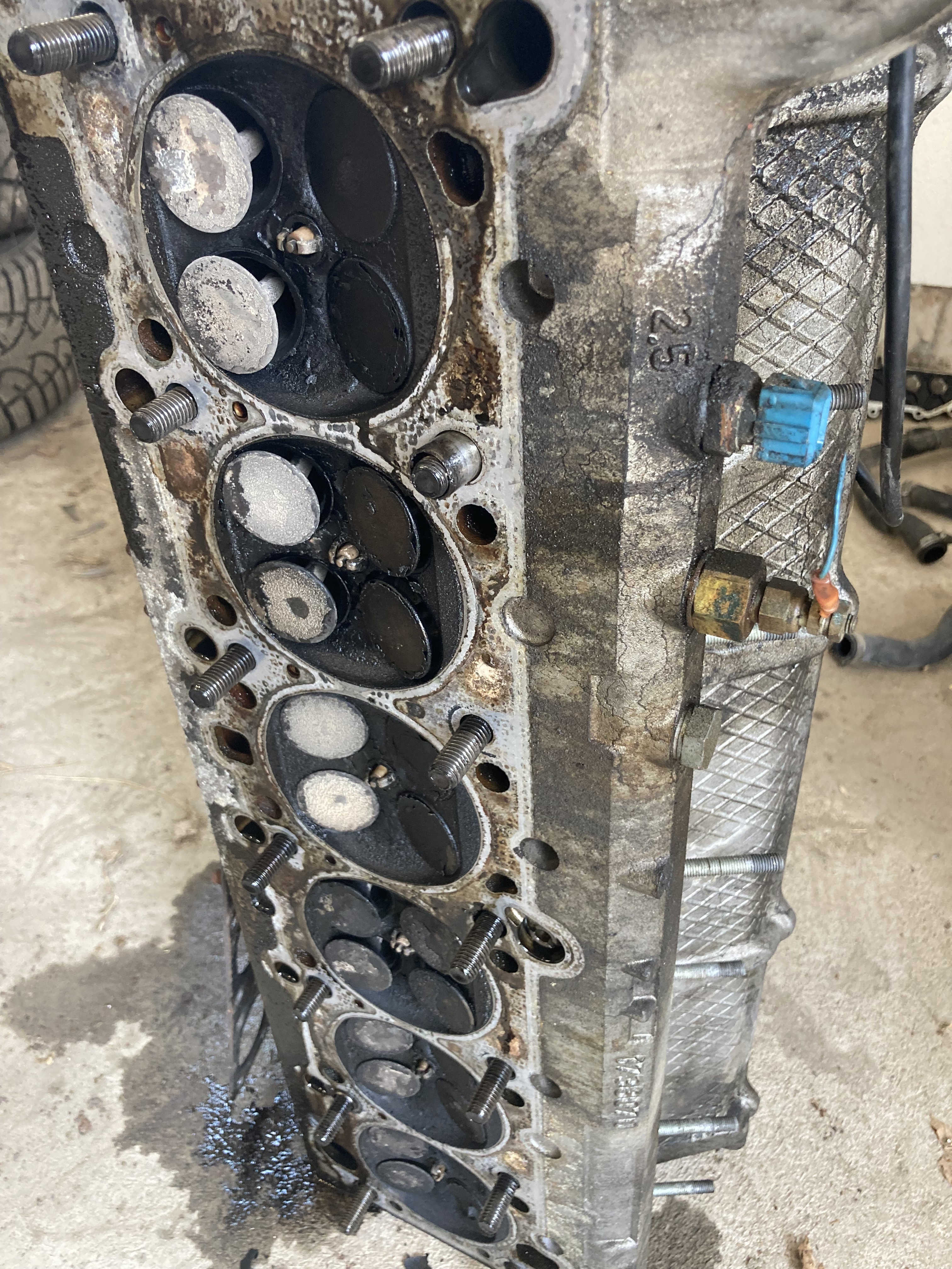

jc43089 Posted August 11, 2023 Author Report Share Posted August 11, 2023 It’s stripped of good stuff and loaded up for scrap. If anyone wants any wire connectors or other bits let me know asap. Probably hauling it away mid morning tomorrow. I did pull the head just to see and yea it was a mess of bent valves Quote Link to comment Share on other sites More sharing options...

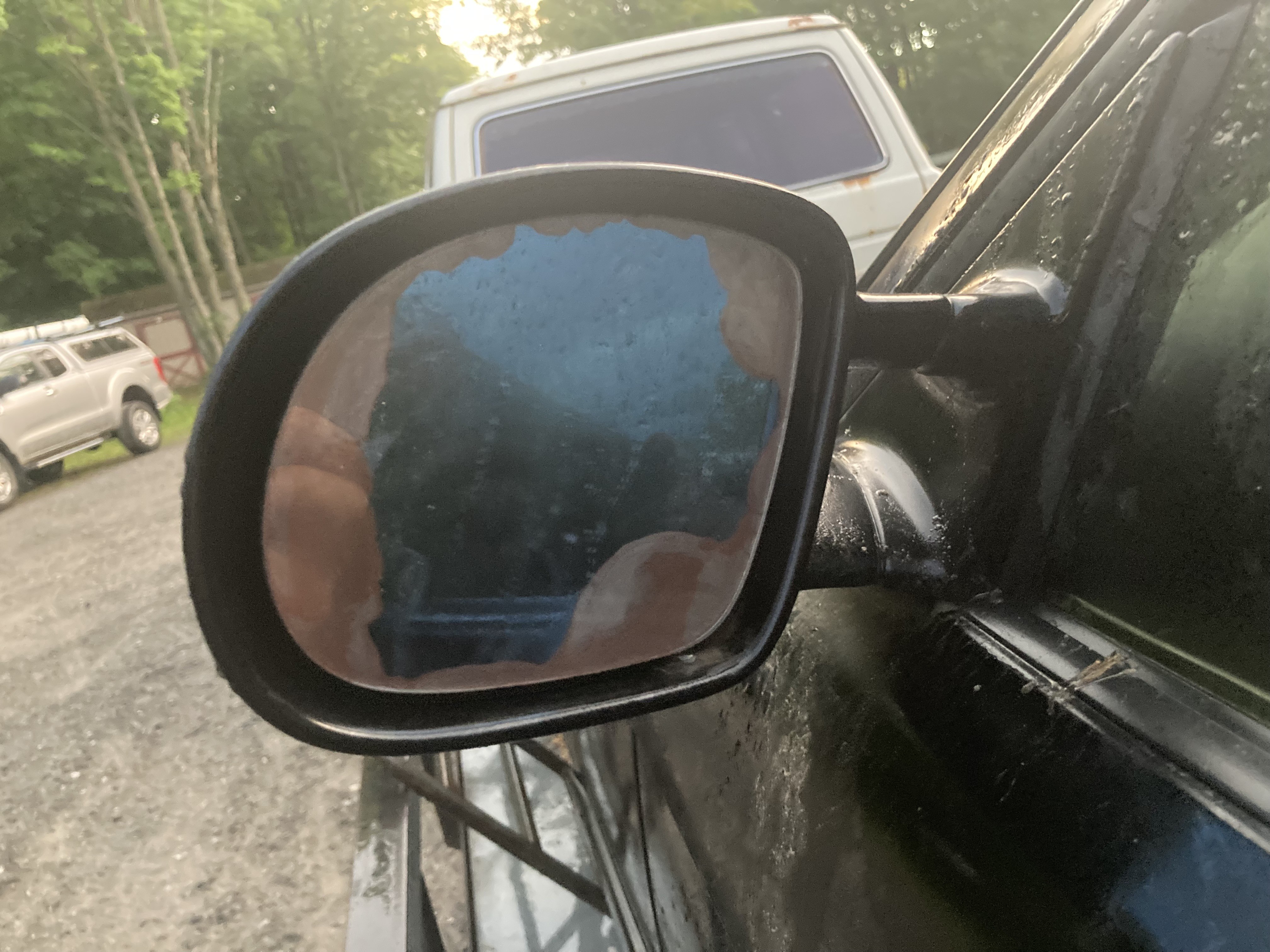

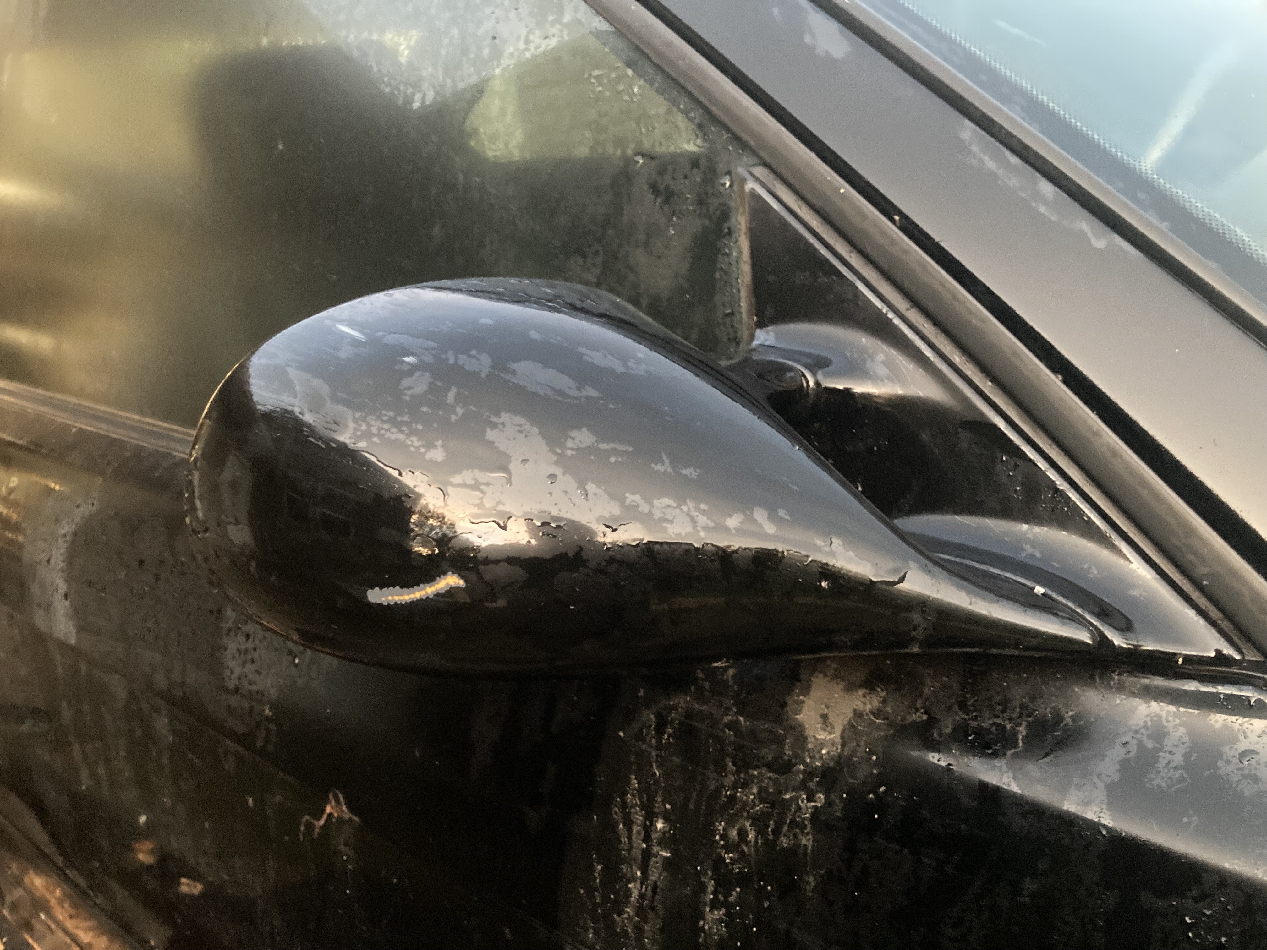

KaiserRolls Posted August 12, 2023 Report Share Posted August 12, 2023 1 hour ago, jc43089 said: It’s stripped of good stuff and loaded up for scrap. If anyone wants any wire connectors or other bits let me know asap. Probably hauling it away mid morning tomorrow. I did pull the head just to see and yea it was a mess of bent valves @jc43089 Are those m3 mirrors?? Quote Link to comment Share on other sites More sharing options...
jc43089 Posted August 12, 2023 Author Report Share Posted August 12, 2023 25 minutes ago, KaiserRolls said: @jc43089 Are those m3 mirrors?? Yes. The glass is in poor condition. Some chips in the paint. Pictures of the worst damage. Quote Link to comment Share on other sites More sharing options...
KaiserRolls Posted August 12, 2023 Report Share Posted August 12, 2023 6 hours ago, jc43089 said: Yes. The glass is in poor condition. Some chips in the paint. Pictures of the worst damage. @jc43089 Even so, might be worth pulling before you scrap the car - few examples in pretty rough condition: https://www.ebay.com/itm/175722794117?_trkparms=amclksrc%3DITM%26aid%3D1110006%26algo%3DHOMESPLICE.SIM%26ao%3D1%26asc%3D20221018081743%26meid%3D2affe13246c0421191b0287faf67c3cd%26pid%3D101429%26rk%3D3%26rkt%3D12%26sd%3D166142050289%26itm%3D175722794117%26pmt%3D1%26noa%3D0%26pg%3D2332490%26algv%3DSimplAMLv9PairwiseUnbiasedWebCpr08MlcGreedyV3%26brand%3DBMW&_trksid=p2332490.c101429.m2460&amdata=cksum%3A1757227941172affe13246c0421191b0287faf67c3cd|enc%3AAQAIAAABEJXQiYMVUhzblnbgbdrnvCc7FsQ%2FqZeZW5VCXNbEAwy%2FGnljLtcRegnJLfu813A%2BwtvCrK6CrZDxryxfeY8G0YUGhkGbYSZdKZ0O0Iga%2BObafMF6svyguAcBnzd6FFytviuMe5UM1ehTsiXeOpuN5ykZFD8zPajjekec7ZVVsYEwMOmMoW7%2Fdp%2FJUzC6Zl3CcOs4EAt3DgZTNGjfFrYn3aX2ntWI%2FfNm0puCpqEzYvjCaw%2FeMqhQIpuj%2FdKjLKH%2BSZoSHzY6aNDxmnxvaSNvy09qHGkqCPv%2BZ%2FzLS%2BiBB0Vqj9JU6Uy8Sh0V0RWh%2FMd%2FcykoeIQX%2FVG49F%2BYKduWyHdJ1UrF5rRPKmPfb03niLrL|ampid%3APL_CLK|clp%3A2332490&epid=1837121161 https://www.ebay.com/itm/284701124597?_trkparms=amclksrc%3DITM%26aid%3D1110006%26algo%3DHOMESPLICE.SIM%26ao%3D1%26asc%3D20221018081743%26meid%3Dd0a914804f0841859fcf5f187cb397e8%26pid%3D101429%26rk%3D2%26rkt%3D12%26sd%3D175722794117%26itm%3D284701124597%26pmt%3D1%26noa%3D0%26pg%3D2332490%26algv%3DSimplAMLv9PairwiseUnbiasedWebCpr08MlcGreedyV3%26brand%3DBMW&_trksid=p2332490.c101429.m2460&amdata=cksum%3A284701124597d0a914804f0841859fcf5f187cb397e8|enc%3AAQAIAAABEJXQiYMVUhzblnbgbdrnvCc7FsQ%2FqZeZW5VCXNbEAwy%2FGnljLtcRegnJLfu813A%2BwvWihQGQwiughVCtMtUk7o1YUlrzeqqHINi2AWcCXE9Cjxdnd11JhQdzYT%2FFiyvCgBg9Ke2JrdJdwIgJPDAYfiLhEBeVlsEQjl9l4Oh7s4XUyZ4w5A02Lz9uOwrT7NfuSqVhkftQ63oFEloin3wYzIU4KxcQc%2BXkaV1sCWU56DEDhdSEm%2FoPm96NXVX%2BnFIg%2FRP33YSFE2soogdEmrMTVnJw54Zt2YFlQSboZMCPGSDz1xZwgzwdpEOj%2FWy8SljxmMvMJZ1rxZKw38AtedpAt8j3o7ObOQPymb8hKSmNQAt6|ampid%3APL_CLK|clp%3A2332490&epid=749870380 Quote Link to comment Share on other sites More sharing options...
jc43089 Posted August 12, 2023 Author Report Share Posted August 12, 2023 Wow I didn’t realize they were that valuable. I pulled them off. If anyone wants them make me an offer. They have a 4 wire connector. I don’t know if the motors work because I had no door card and therefore no buttons 😂 My other car is a sedan so I don’t think they would fit anyway. Jdesign and KaiserRolls 2 Quote Link to comment Share on other sites More sharing options...
