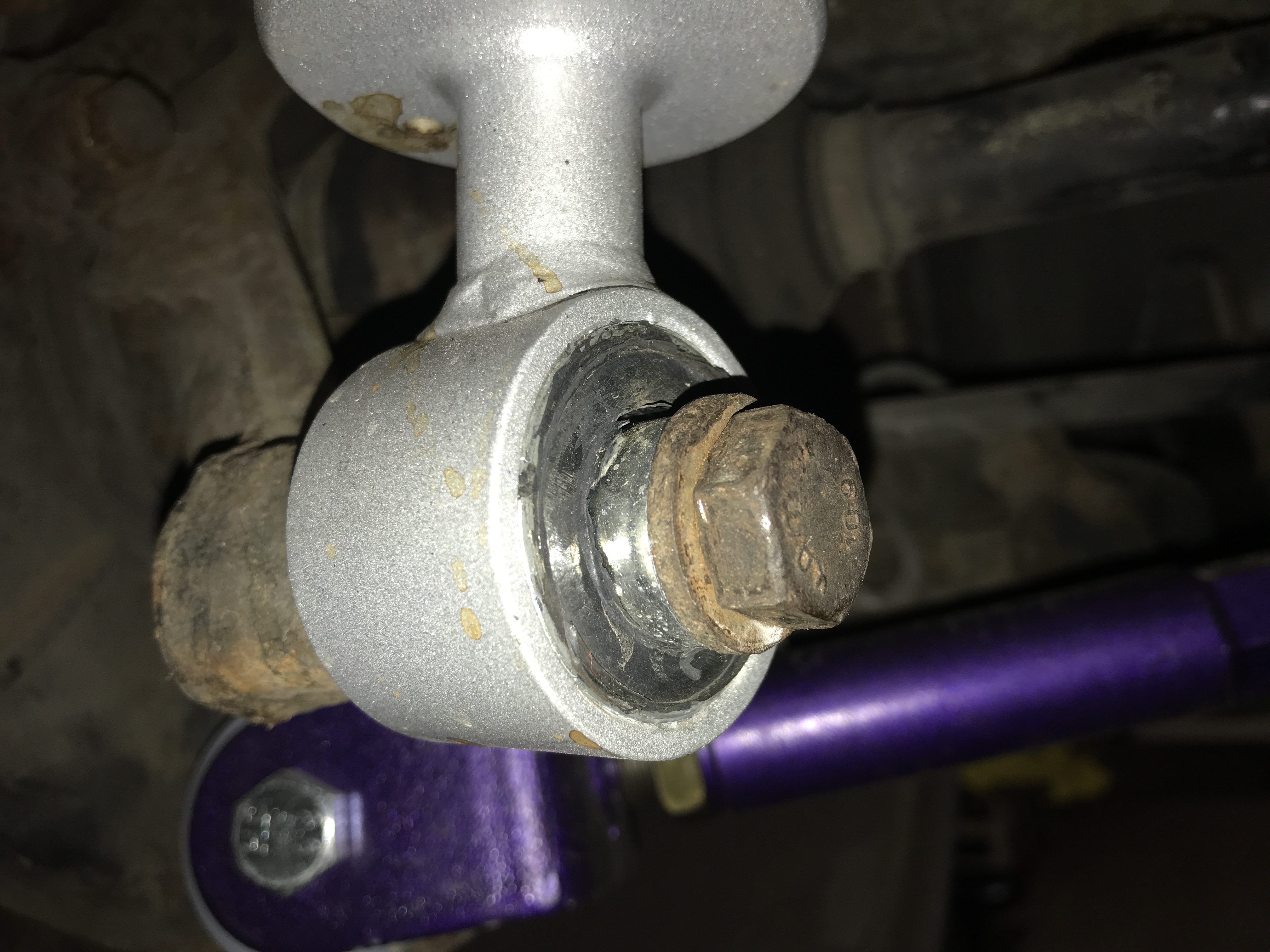

jc43089 Posted February 18, 2020 Report Share Posted February 18, 2020 1 hour ago, Jdesign said: I never realized Biff had euro bumpers Duh, it's the future! Also are you doing upper and lower ball joints on the trailing arms instead of the non M style with one ball joint and one bushing? I did that on mine and I don't see any reason why not to. Quote Link to comment Share on other sites More sharing options...
Jdesign Posted February 18, 2020 Author Report Share Posted February 18, 2020 1 hour ago, jc43089 said: Duh, it's the future! Also are you doing upper and lower ball joints on the trailing arms instead of the non M style with one ball joint and one bushing? I did that on mine and I don't see any reason why not to. Yes, although I stupidly forgot that I have new bushings that I made from delrin for the lowers already on the car as seen here: https://www.wibimmers.com/board/index.php?/topic/4537-futuristicconcept-art-bmw-e36-with-a-v8-on-a-bottom-dollar-budget/page/18/ Im also contemplating if I should just find a cheap fuel cell instead of replacing the fuel tank.... Thoughts? Quote Link to comment Share on other sites More sharing options...

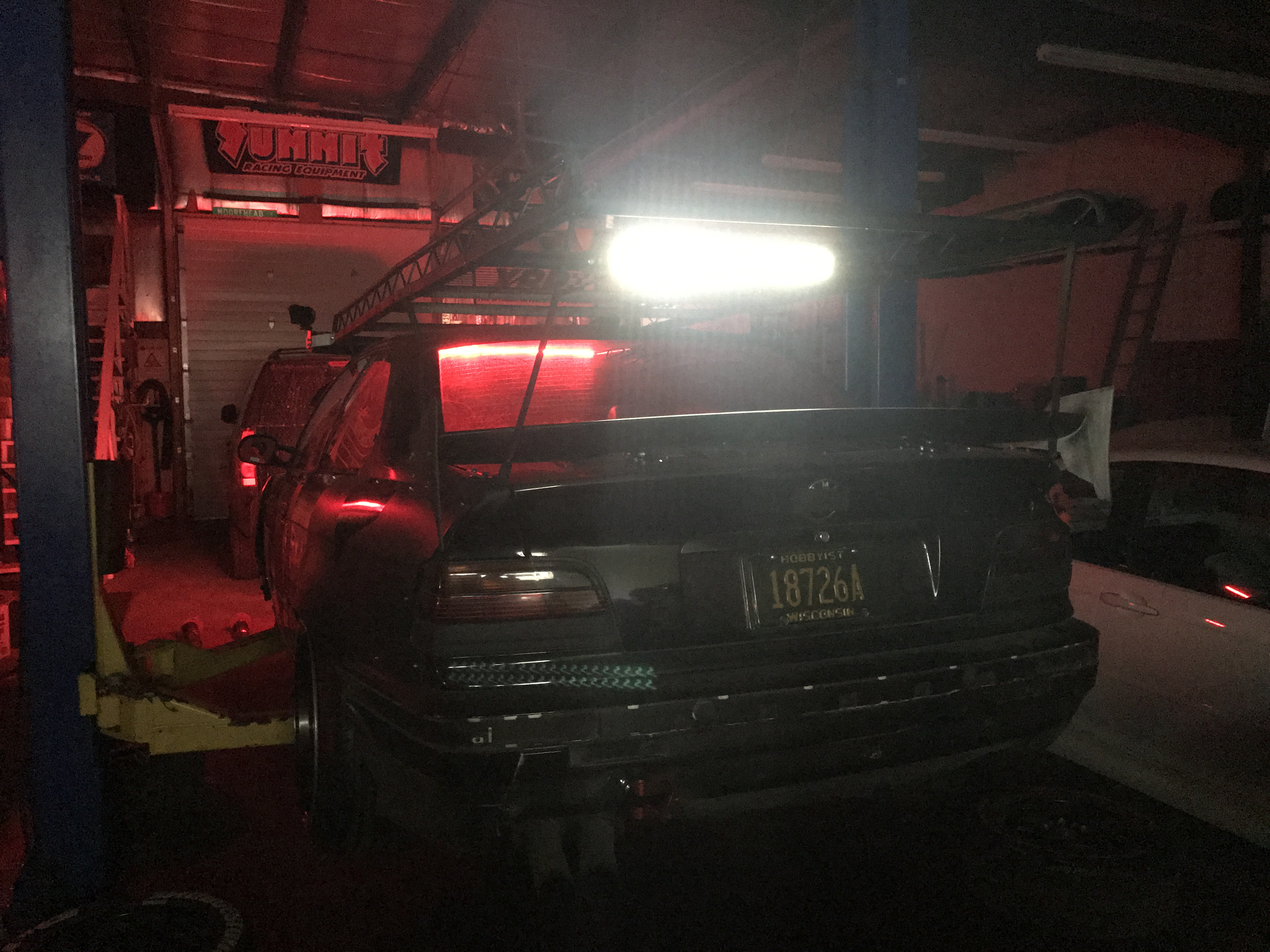

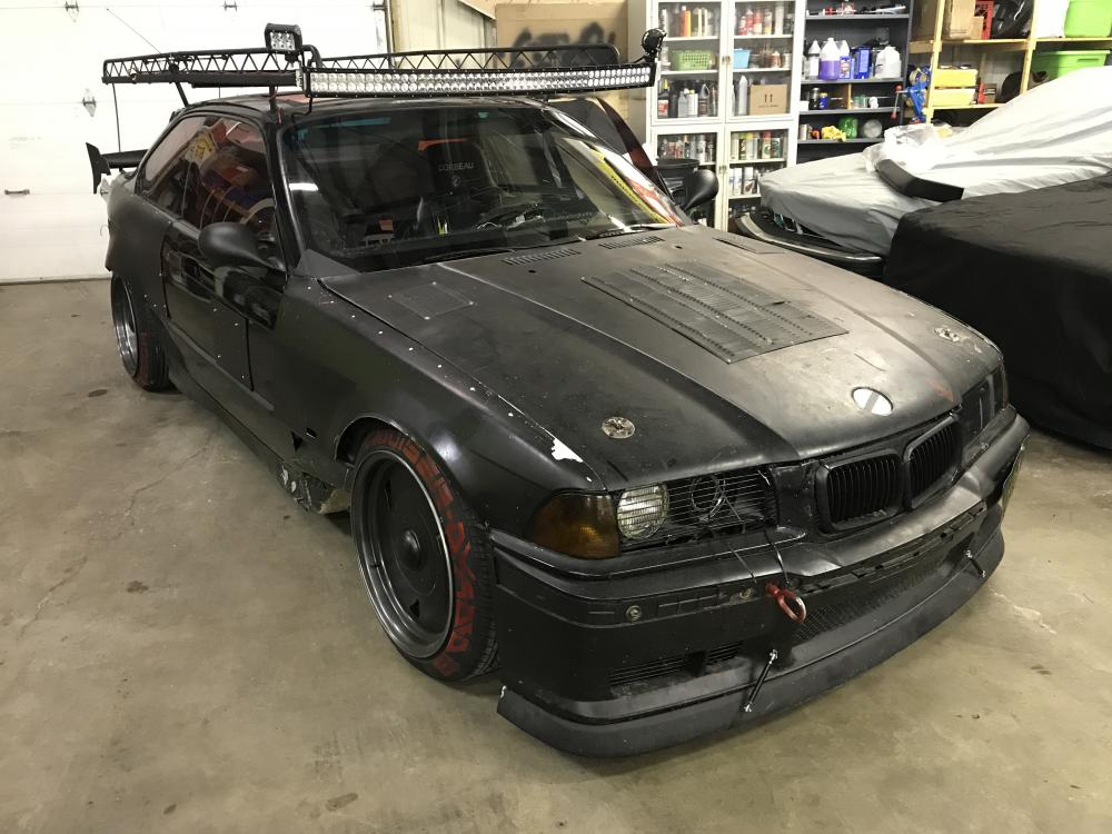

straight6pwr Posted February 19, 2020 Report Share Posted February 19, 2020 roof rack + m42b32 and Jdesign 1 1 Quote Link to comment Share on other sites More sharing options...

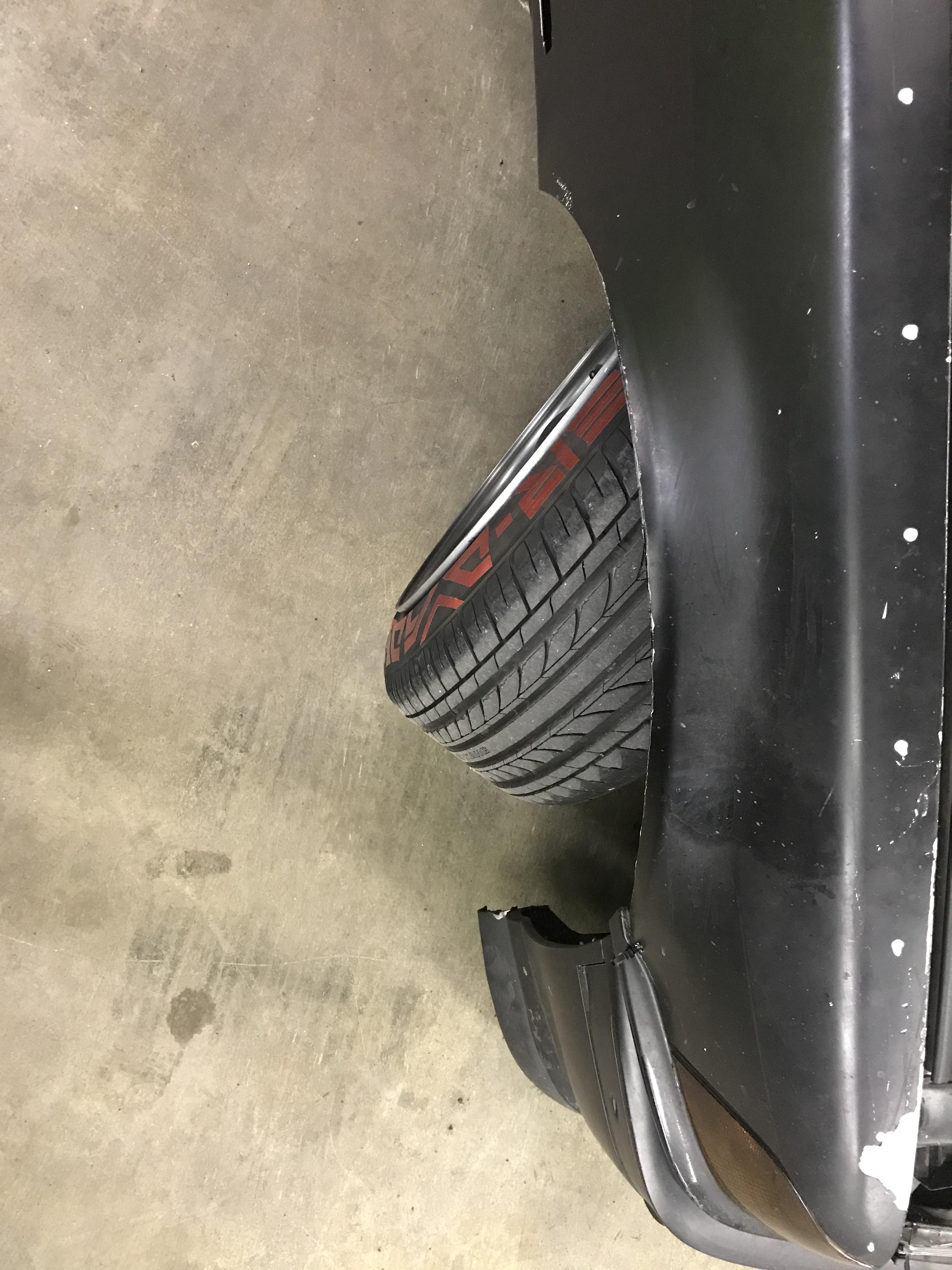

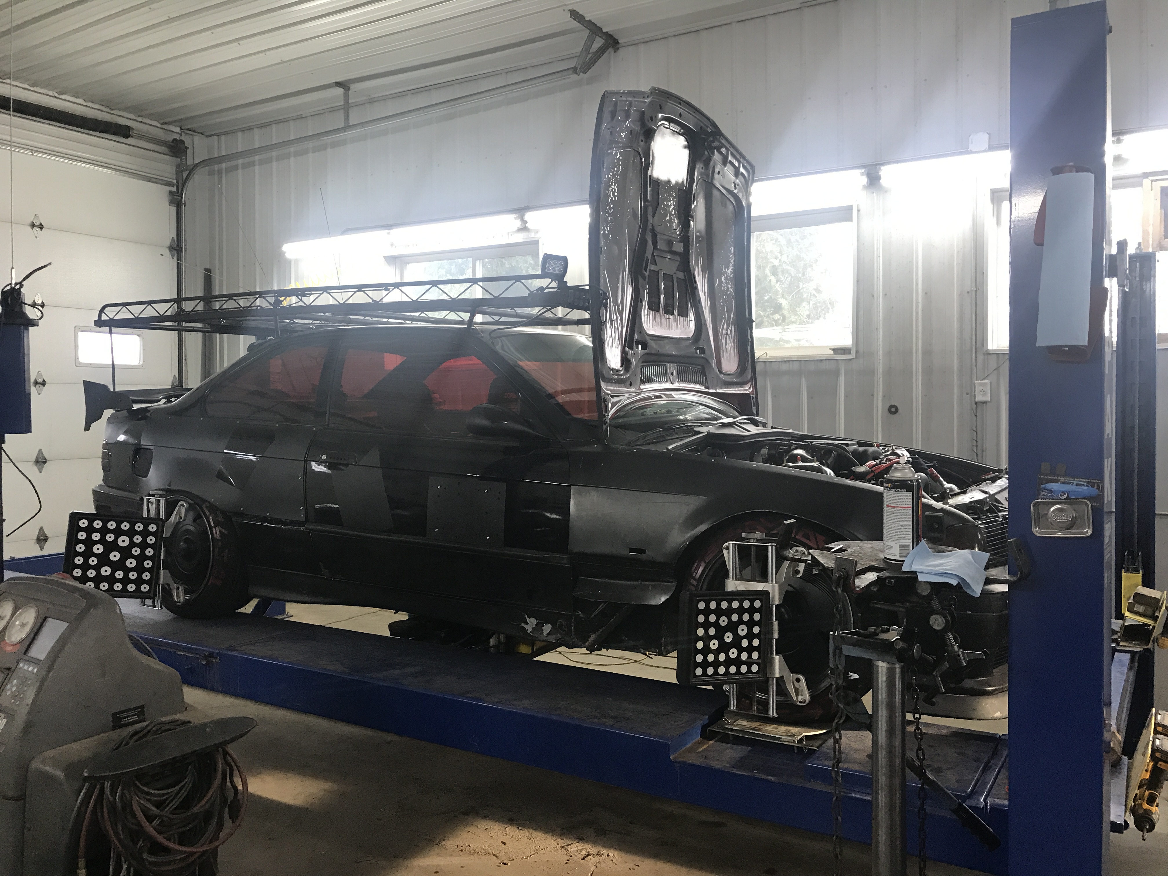

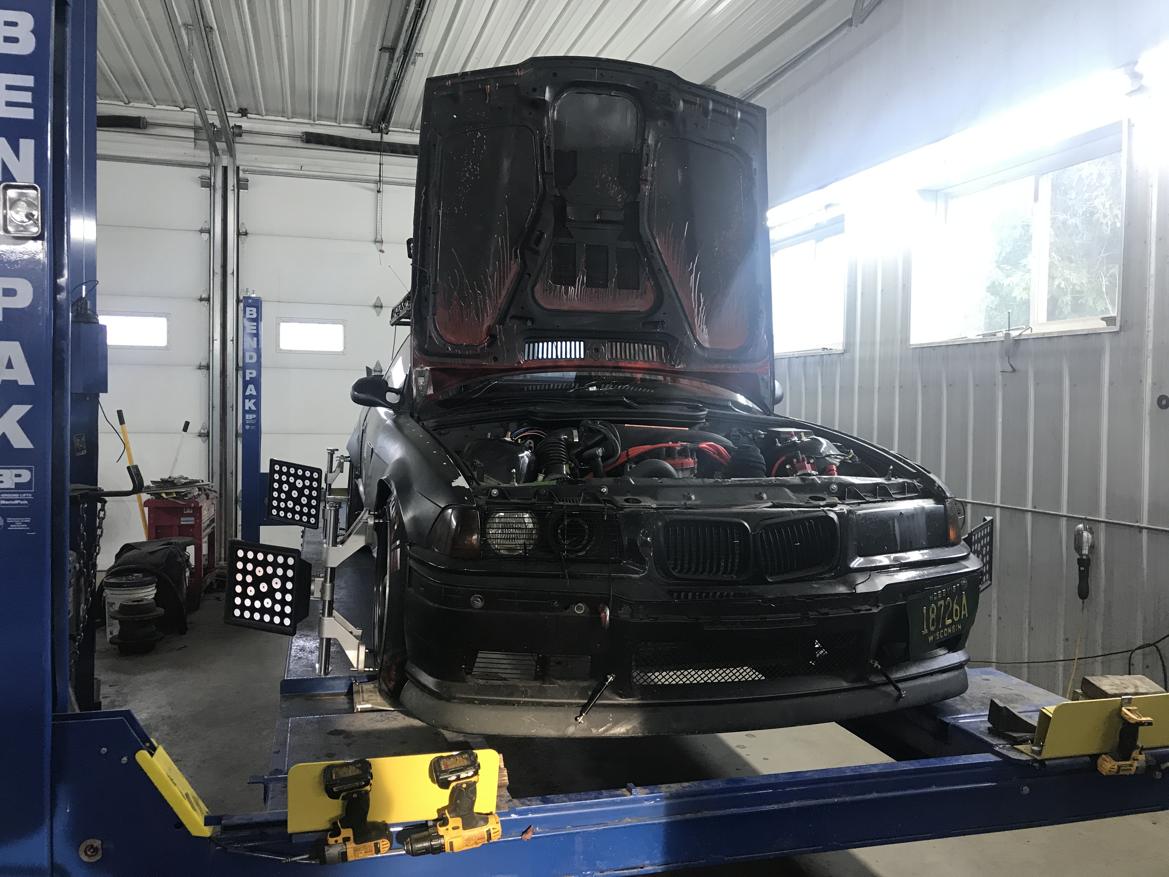

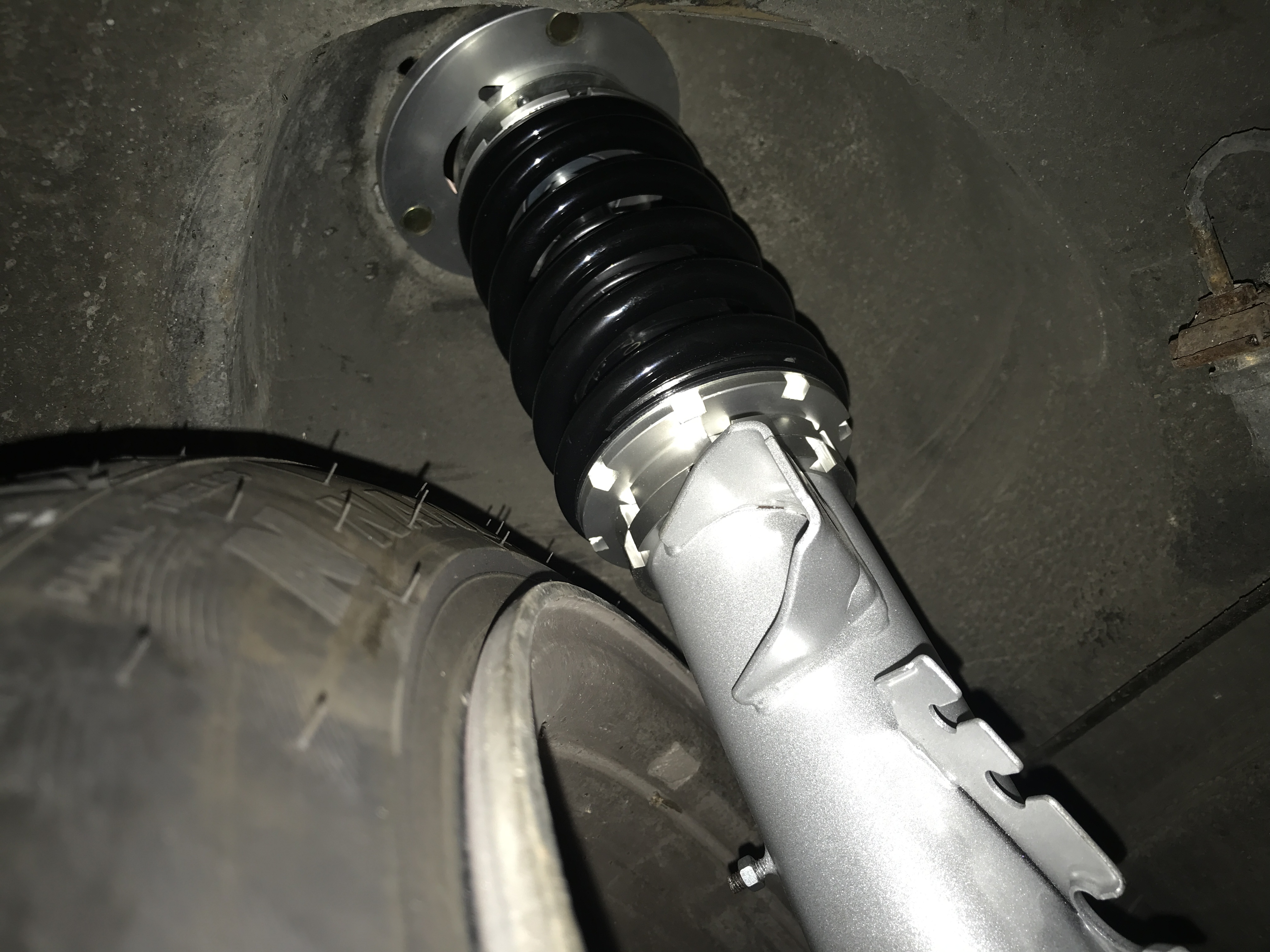

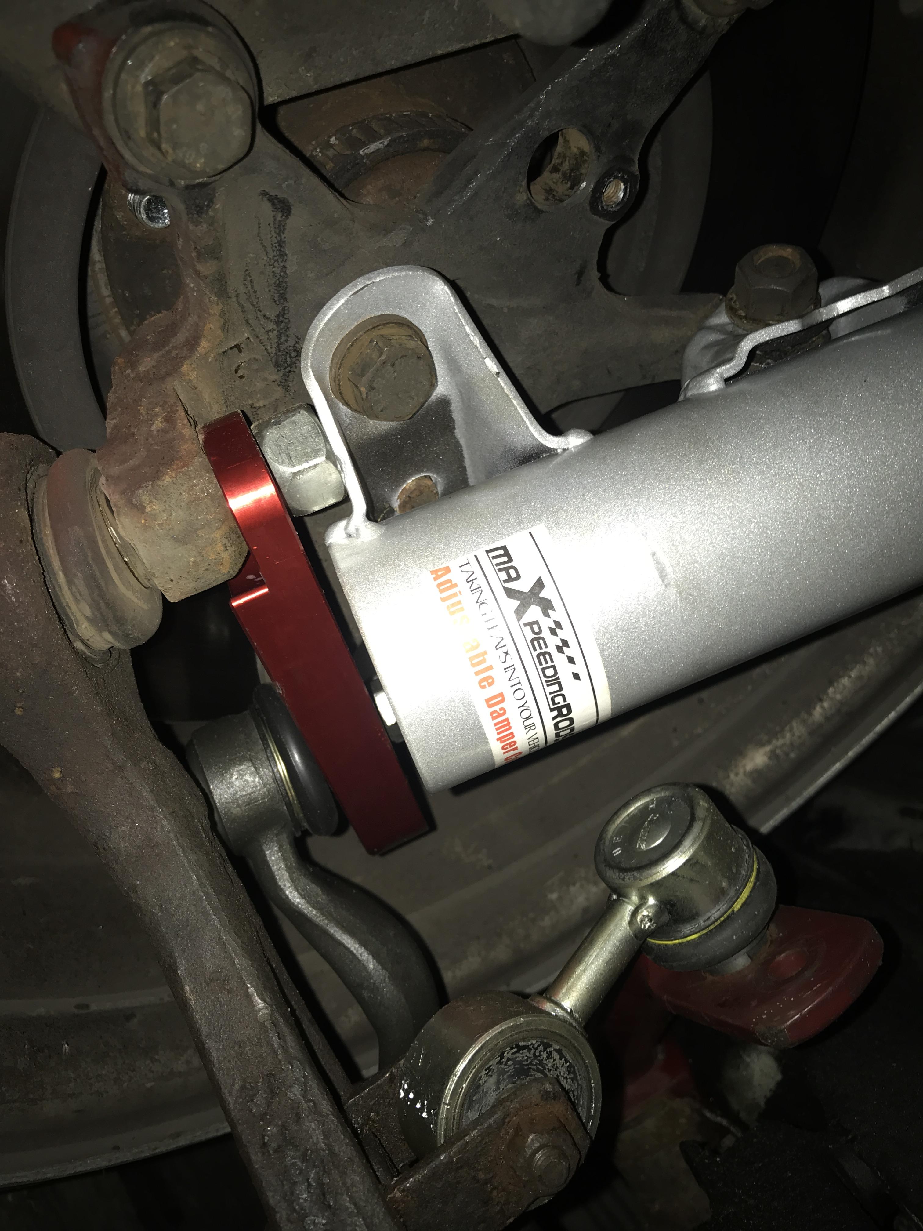

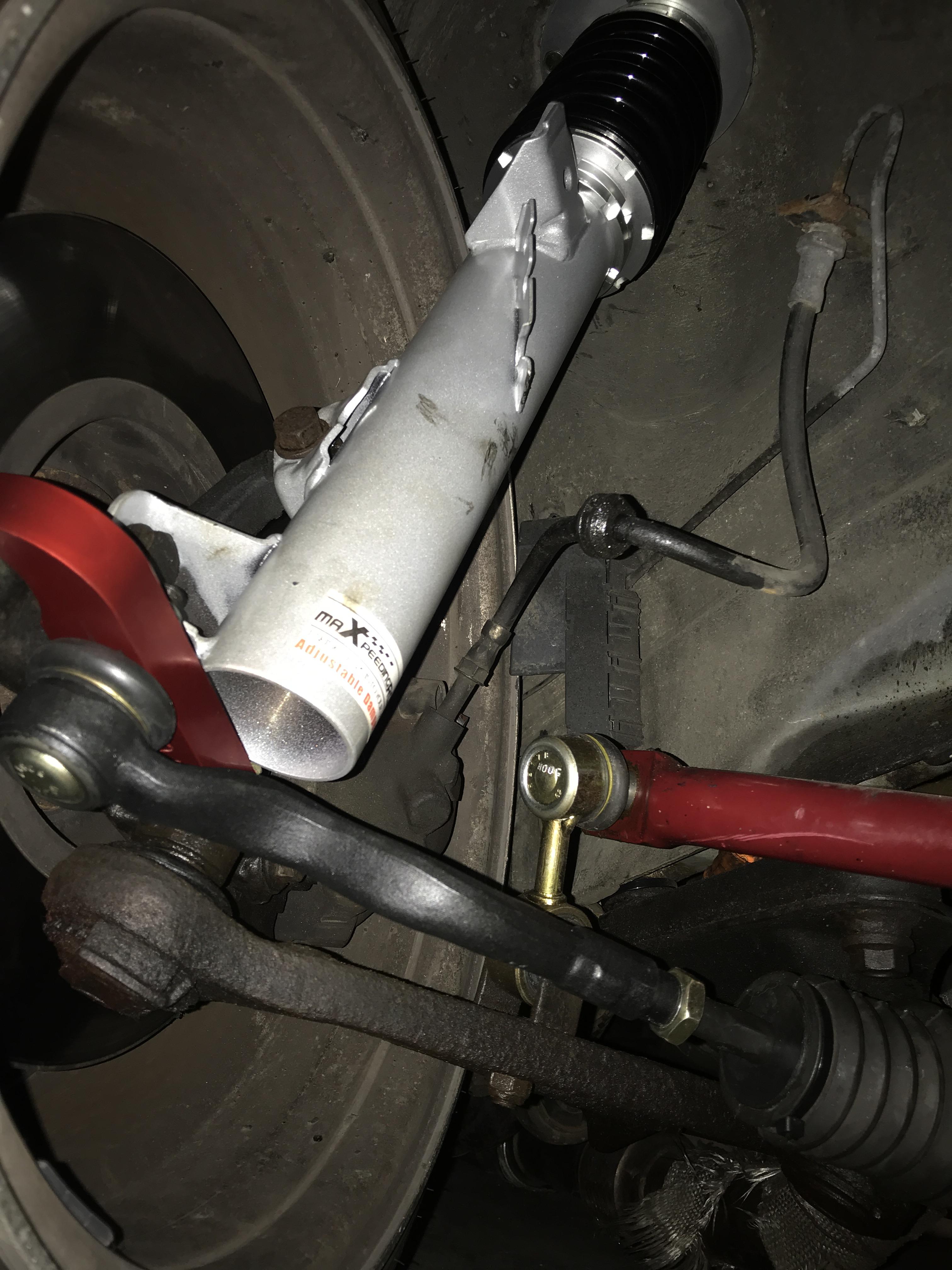

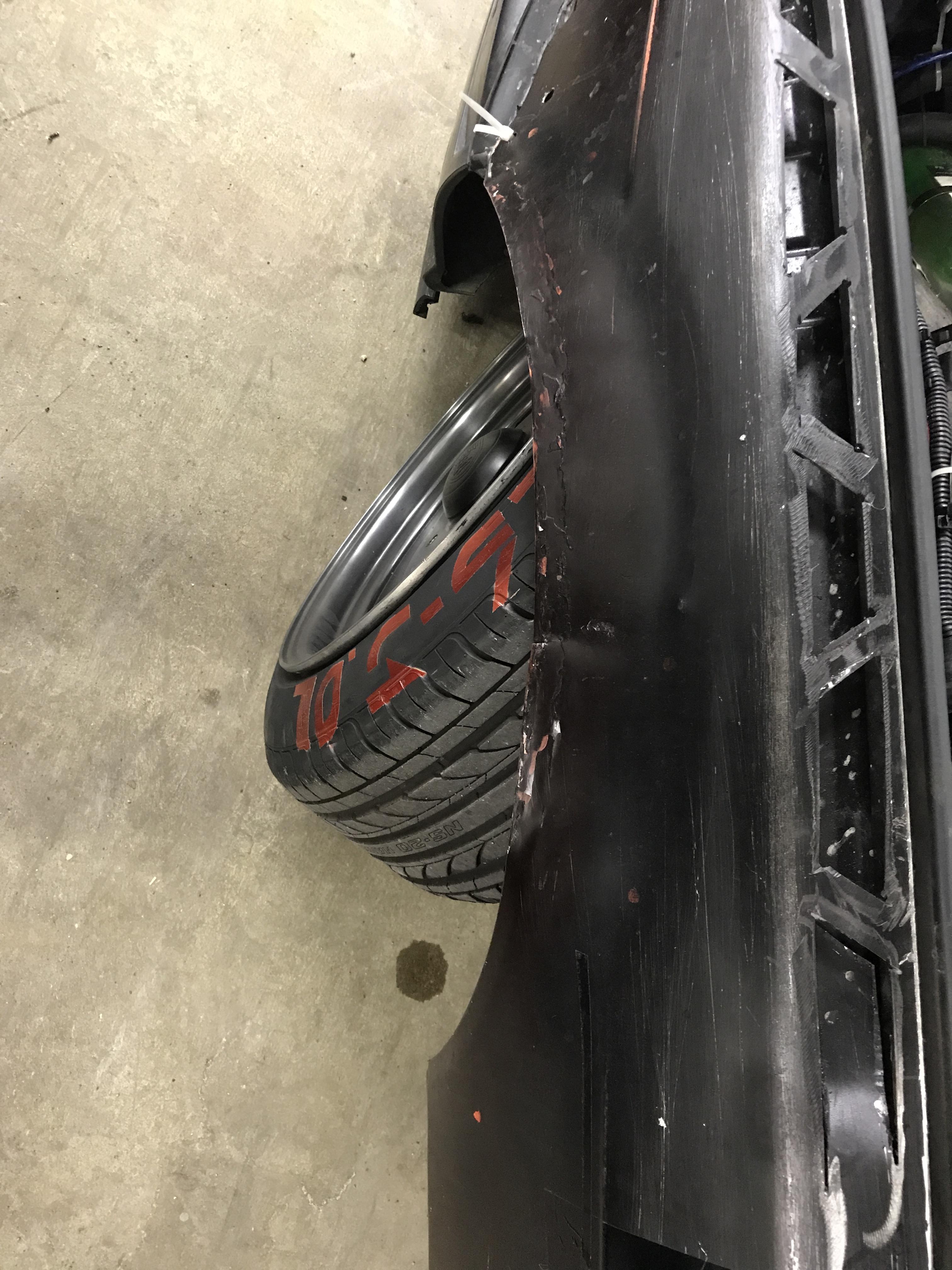

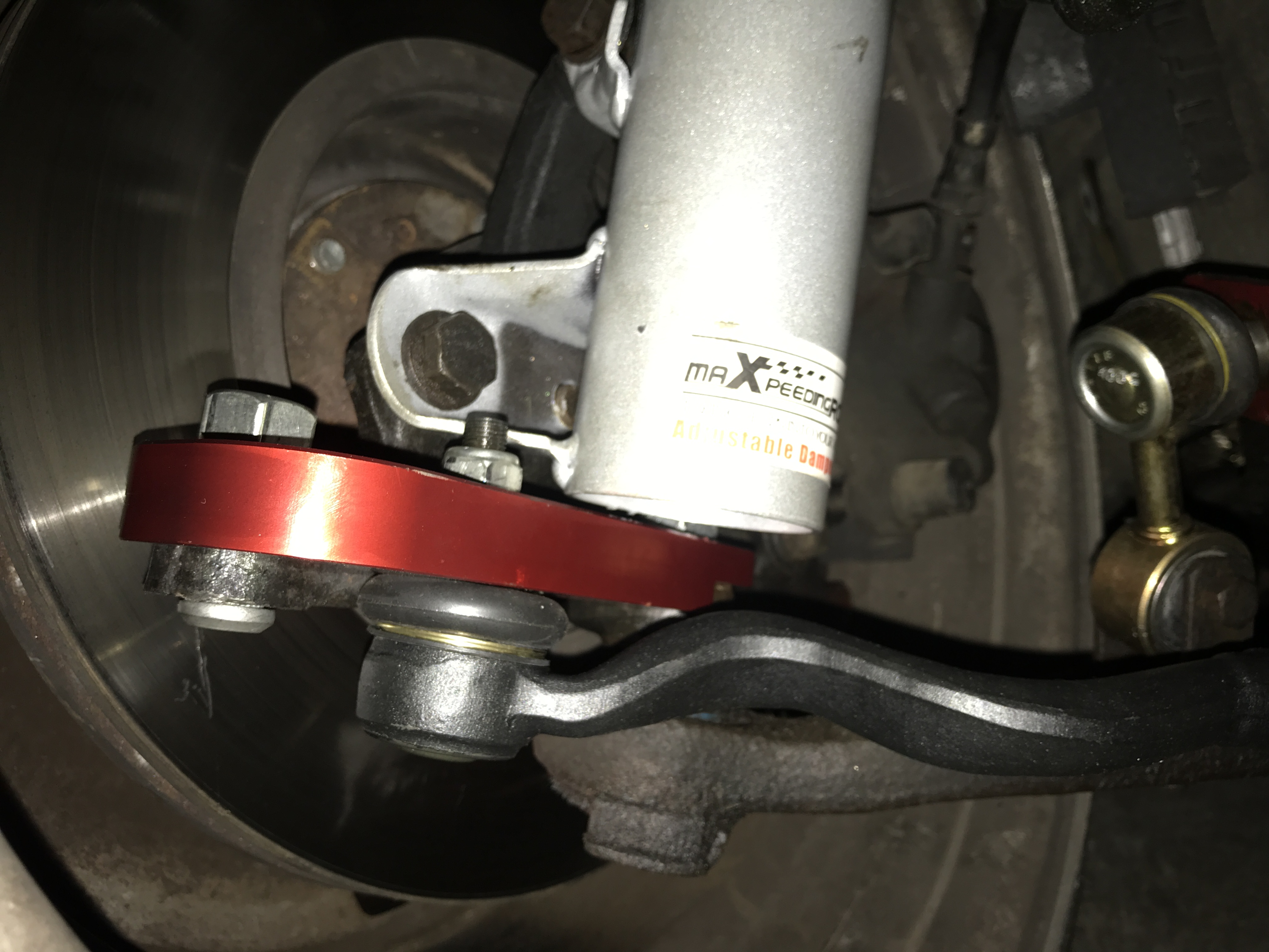

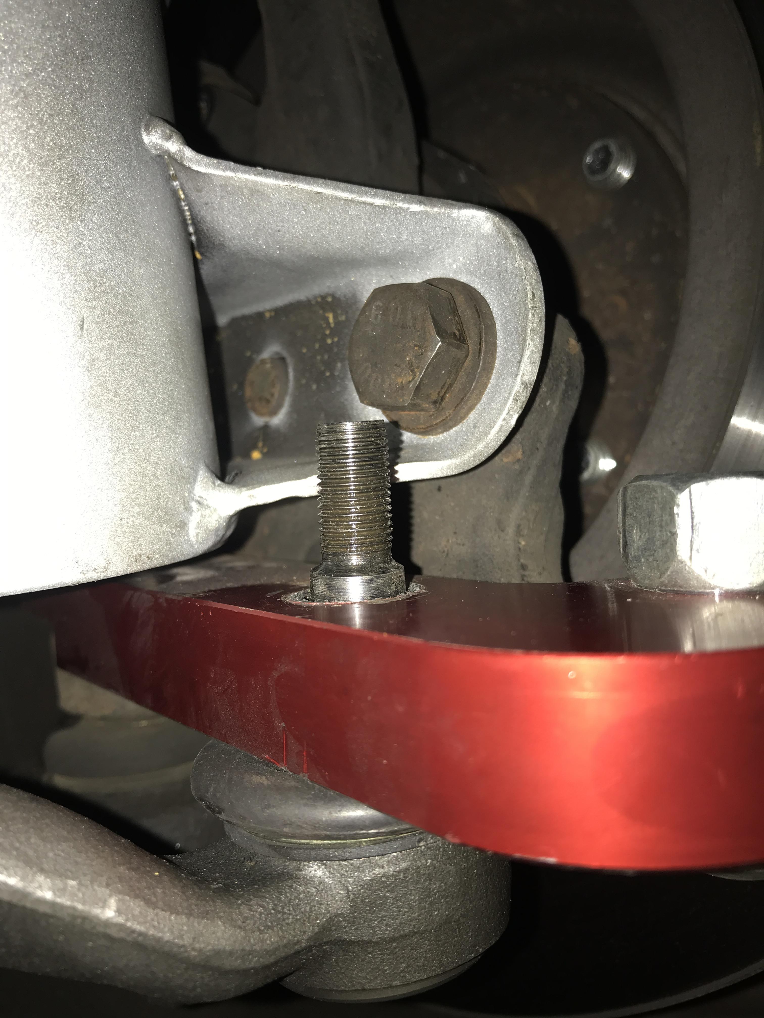

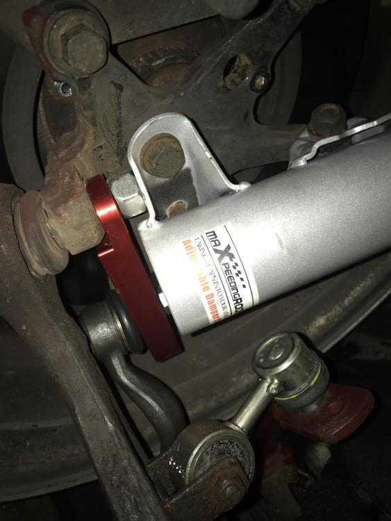

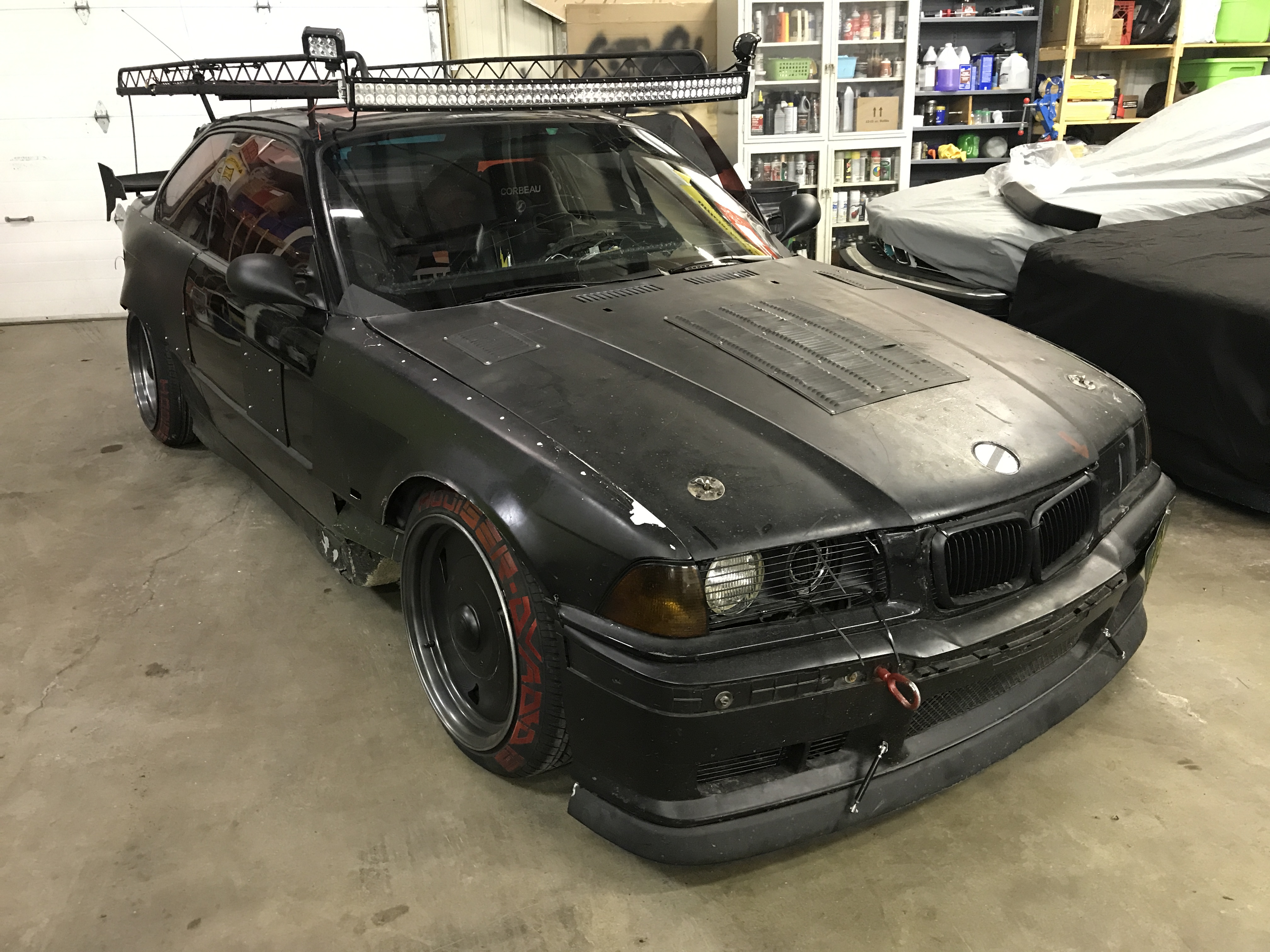

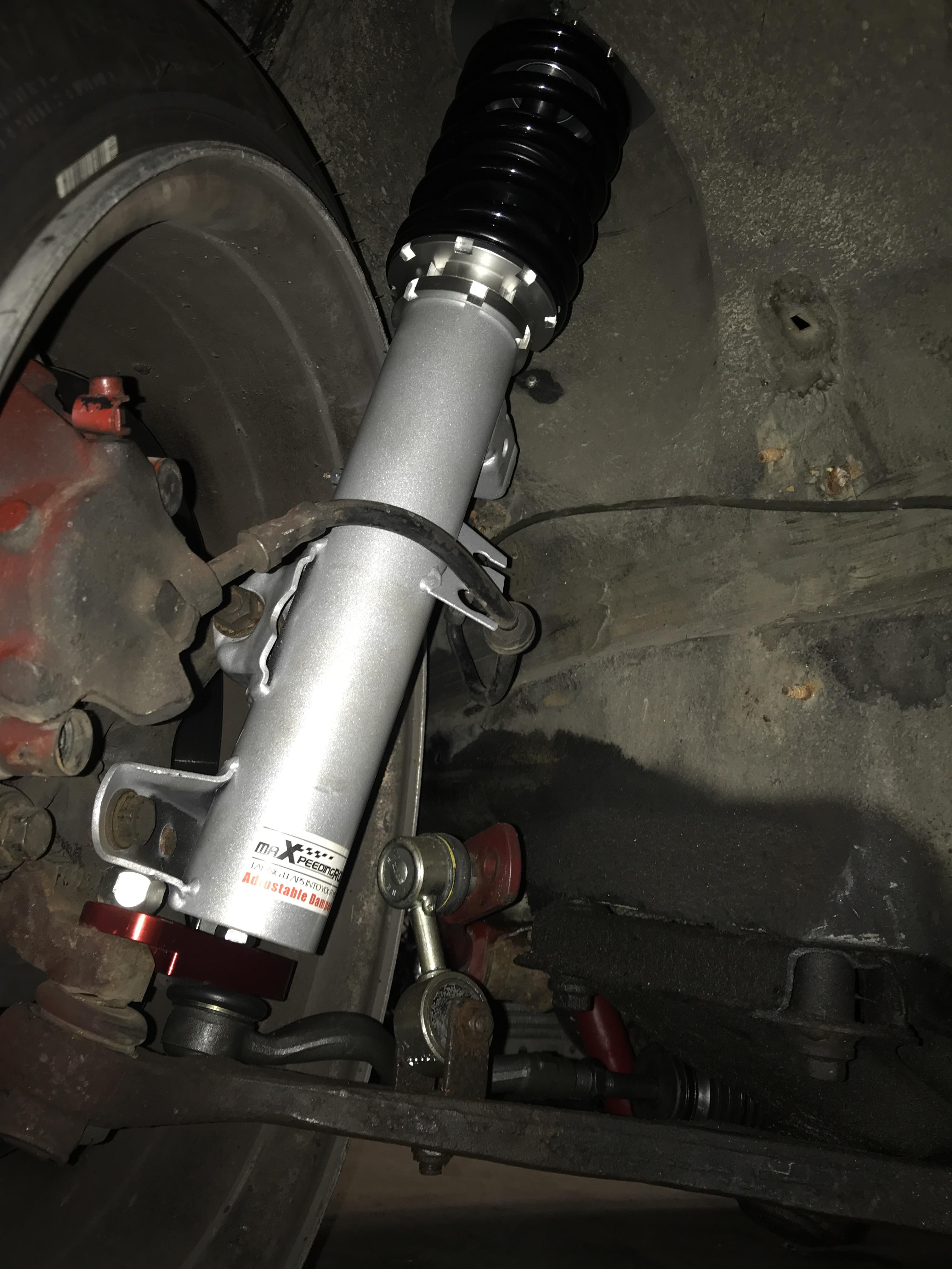

Jdesign Posted March 11, 2020 Author Report Share Posted March 11, 2020 So, I finally took some time to work on this. Despite the parts being moved around the shop as I tended to other projects, I finally moved the crate for the last time and got this going last weekend. Up on the lift I pulled the old wheels off and found that one of my spacers became no longer hub centric.. Besides that I was able to get 6"s of lift out of the coilovers up front before the bottom of the uprights hit the control arms. I made a slight adjustment back down to prevent this. In the future I might need to add a spacer to the subframe and control arm bushings to get more lift and travel out of this set up. I also had to remove the brake lines from mounting locations as the flex section was maxed out and would have prevented me from turning. The PO deleted the ABS and its a mess, so I might find myself addressing the brakes again in the near future, but for now I will just weld tabs for new "lower" mounting locations to allow the lift. I had to remove the front bumper due to the tires rubbing and I was unsure if I wanted to trim it and the filler panel with the kidneys. After I removed it I test fit the front wheels and kind of like the look with no bumper cover. I might need to attach some kidneys of some sort just because of the BMW factor but I will revisit this later. I then started the rear last night which was a whole different situation. I started by removing the over fenders and exhaust. As mentioned earlier, I was upgrading to ///M Swing arms and axles. So with that, I have all new bushings, subframe, control arms, control arm supports, ETC. I am swapping out everything besides the shocks, brakes, and diff. I was able to remove everything without any major issues. Once everything was set aside, I started to trim the arches more to allow the bigger tires. After this I gave up for the night and will return tonight. ...... But obviously I had to see how it looked on the ground, so I set it all in place and lowered the car back on the ground. Needless to say I was pretty happy with the results. P_Roloff, gilber33, m42b32 and 2 others 5 Quote Link to comment Share on other sites More sharing options...

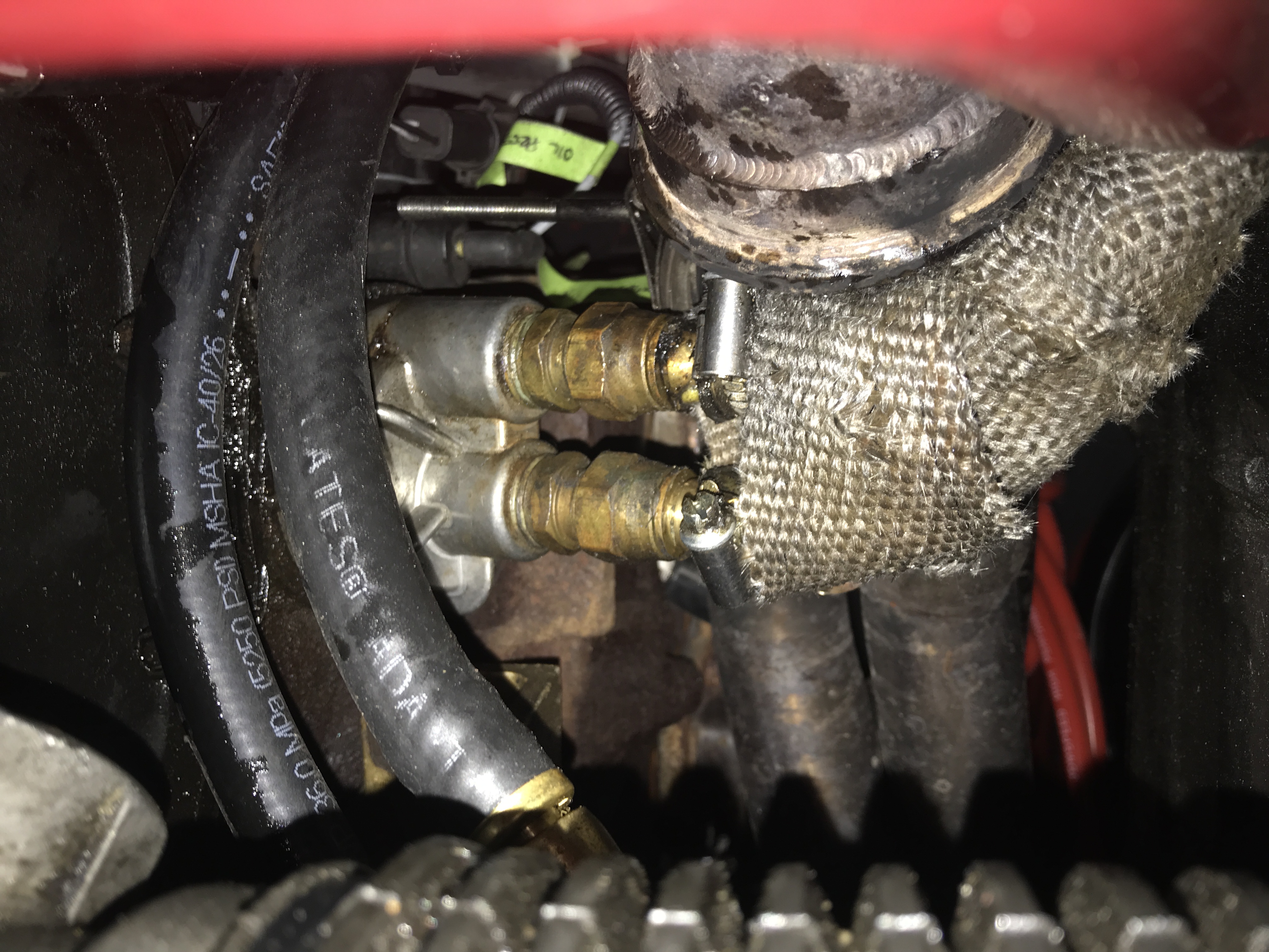

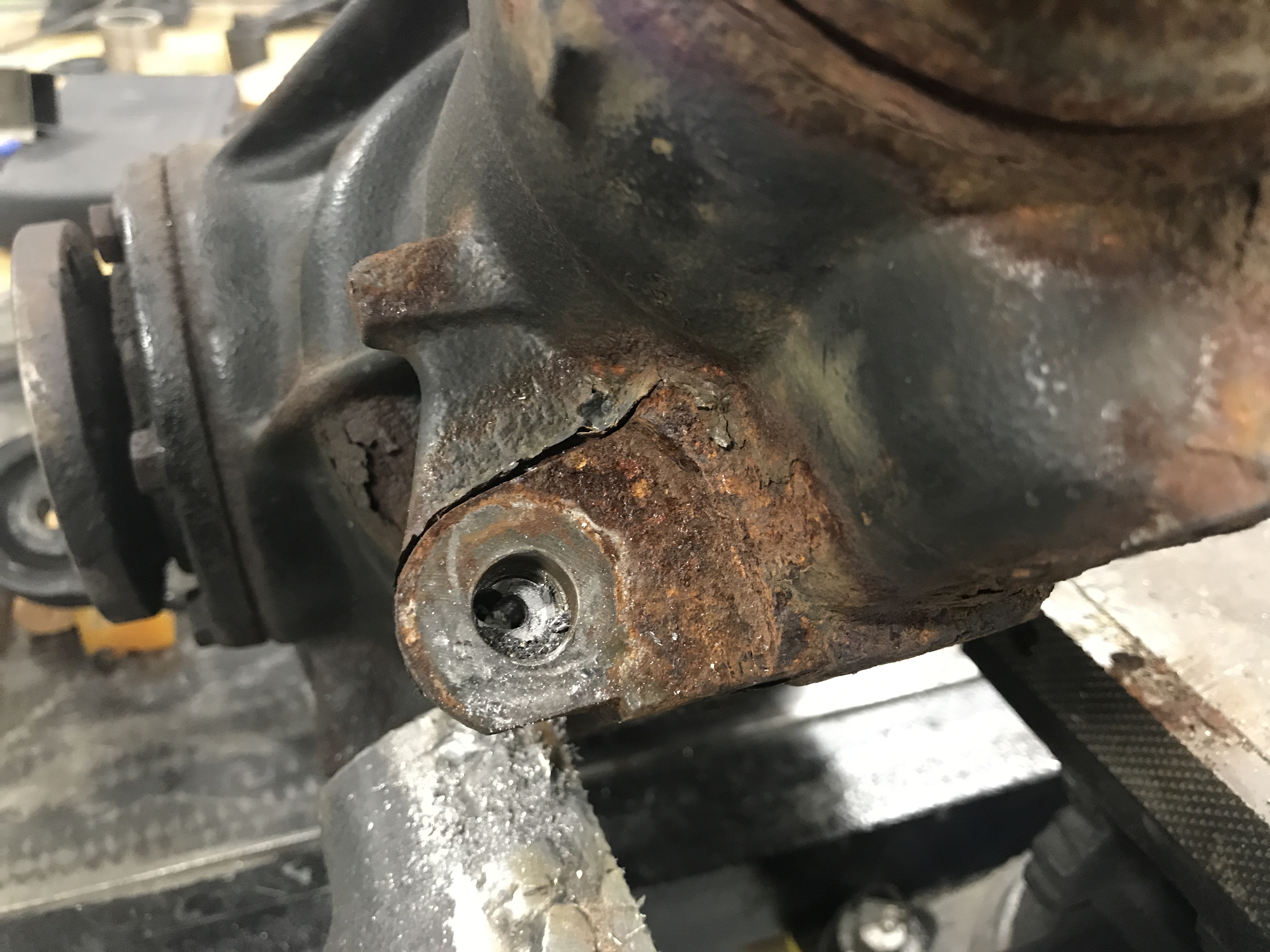

Jdesign Posted March 12, 2020 Author Report Share Posted March 12, 2020 Got the gas tank out last night. Despite what I thought, the gas tank wasn't actually what was leaking. Turns out the brake lines behind the fuel tank for the rear brakes was extremely rusted in the corners and was leaking. The vent tube on the top of the tank was in pretty bad shape which may have been leaking too but only when the tank was full. Speaking of full, I also had 3/4 of gas in the tank. 🙄 The line above the two vent lines: The spot where I thought the tank was leaking once I cleaned it off. It was rubbing on the chassis but I fixed that with a hammer once it was out. Also, thinking ahead, I realize the fuel and brake lines running to the back of the car are low an pose a threat to any obstructions I may find, So I will be building bash plates to "fix" the floor and cover all the lines to prevent damage. Pics of floor to show you why cars have windows and leaving wet carpet in your car for a year is bad: Quote Link to comment Share on other sites More sharing options...
