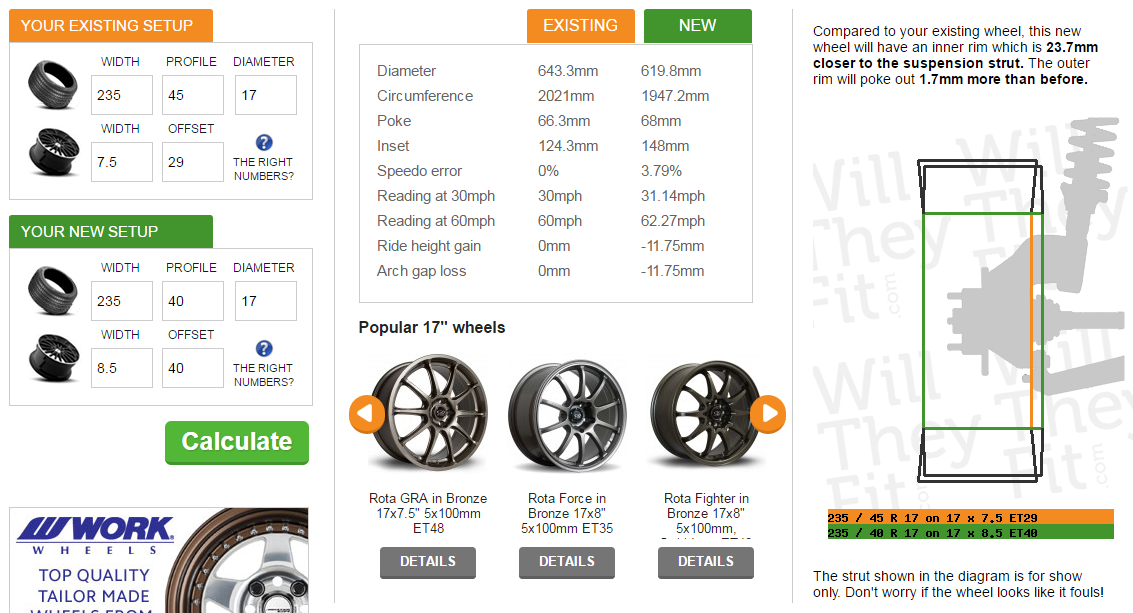

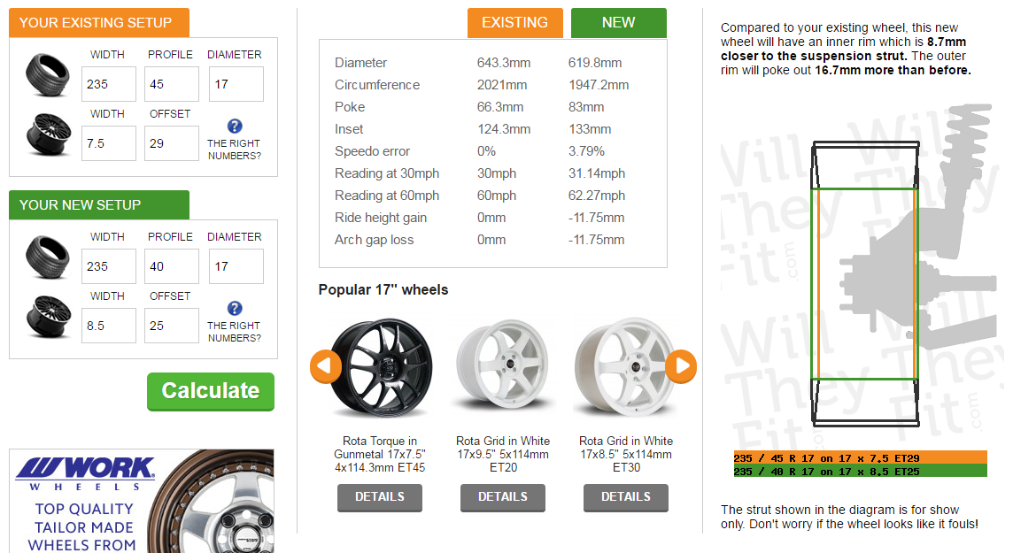

suspenceful Posted May 25, 2016 Report Share Posted May 25, 2016 1 hour ago, i_love_cars said: Yesterday I ordered a CCA grill badge because I think E30s should just have those. I also ordered a set of hyper silver Apex ARC-8 wheels and new Direzza tires. The car won't make a full locking turn right now and rubs badly because the prior owner mistakenly bought 235/45 tires instead of 235/40, so they are wayyyy too tall. Plus I don't really like the E36 rims that are on the car. Good news is that I have brand new Rival tires from the Miata that I never installed, so Big Bear is letting me return those for a full credit towards the Direzzas, which makes the tires basically a wash. Big Bear also has a buyer for my E36 wheels, and after selling the Avanti wheels I had for the Miata, everything is basically a wash. I'm hoping everything fits, but still not sure. The E36 wheels are 7.5" with 41 offset and 12mm spacers around, and I have about 1" clearance between the strut and the top of the wheel when it is cambered in on the ground. I had to pick up 17x8.5 et40 from Apex, so I'm hoping they will still fit, but I ordered a set of 15mm spacers just in case. Still may be a little close but keeping my fingers crossed. Everything is getting fitted next week on Thursday. Nice. Check out www.willtheyfit.com for tire fitment needs. I did a new vs. old for you. First one is without spacers on the new wheels, second one is with the 15mm spacers. -------------- i_love_cars 1 Quote Link to comment Share on other sites More sharing options...
i_love_cars Posted May 25, 2016 Author Report Share Posted May 25, 2016 awesome! looks like i won't even need spacers, or at worst a small one. Quote Link to comment Share on other sites More sharing options...

i_love_cars Posted May 25, 2016 Author Report Share Posted May 25, 2016 yup, did some math and took some measurements - looks like the rears will clear with no spacer at all as I have like 1.5" between the strut and the wheel, and it only adds 1.7mm of poke. The fronts will still require a spacer because the strut is closer to the wheel. It's got probably 3/4" or a bit more, so likely re-use the existing 12mm which would give about .46" closer to the strut and about .5" more poke which should work out given the tire will stretch a bit and be lower profile. Quote Link to comment Share on other sites More sharing options...

i_love_cars Posted June 1, 2016 Author Report Share Posted June 1, 2016 New wheels are on. I could not possibly be any happier with how they look. Fitment is really good with 12mm spacers all around. I think I am going to drop to a 10mm just for peace of mind but right now I can get a full lock on the wheel again with no rub and driving over normal bumps so far is no problem. Bassboy3313, wasnt m3, ClassE and 2 others 5 Quote Link to comment Share on other sites More sharing options...
